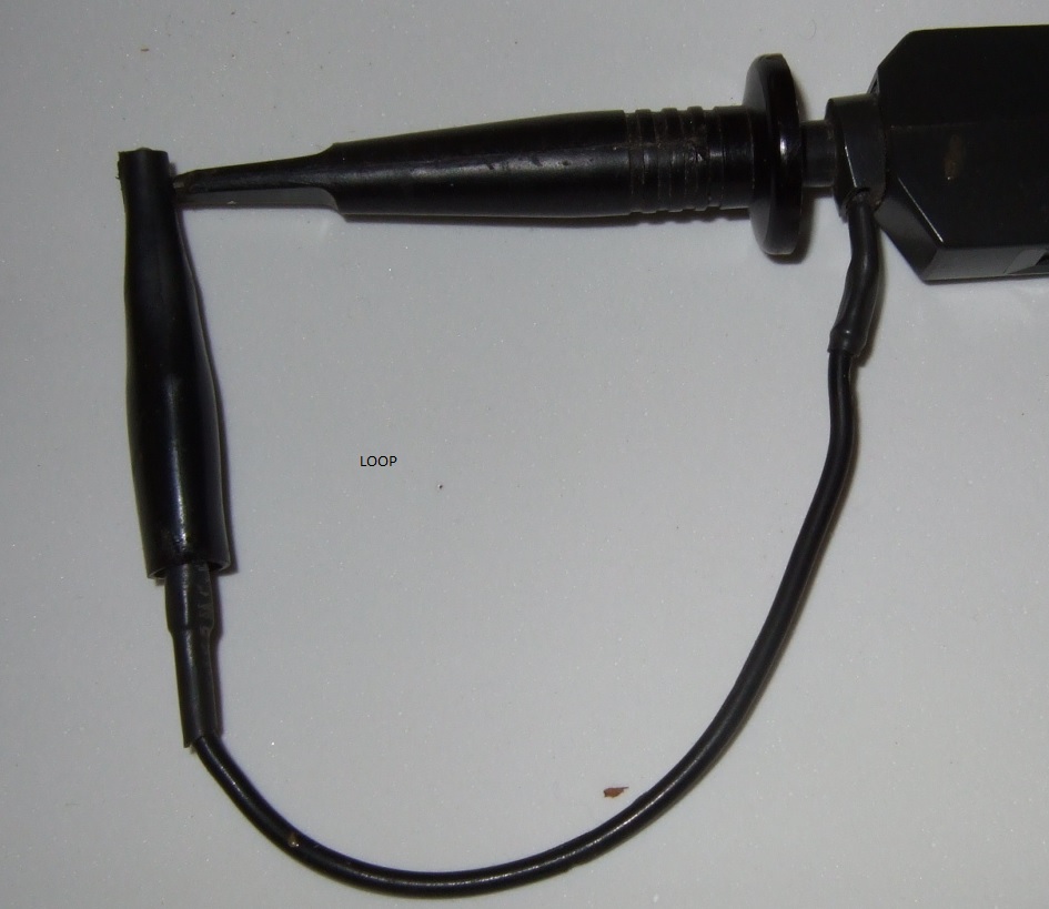

                        Try making a loop(connect scope ground lead to scope probe)lay probe on test coil(test coil leads open) and put test coil near operating PI coil. CH gain maybe 5mV/division, x1.
                        Scope probe not connected to test coil or any circuit just laying on test coil. Put test coil on a piece of cardboard if coil isn't stiff.
                        Test coil just close enough to get a signal with 5mV/ division.
                        • #72
                          Thanks I wasnt sure if it would work with the coil not connected to anything. I will try that next time.

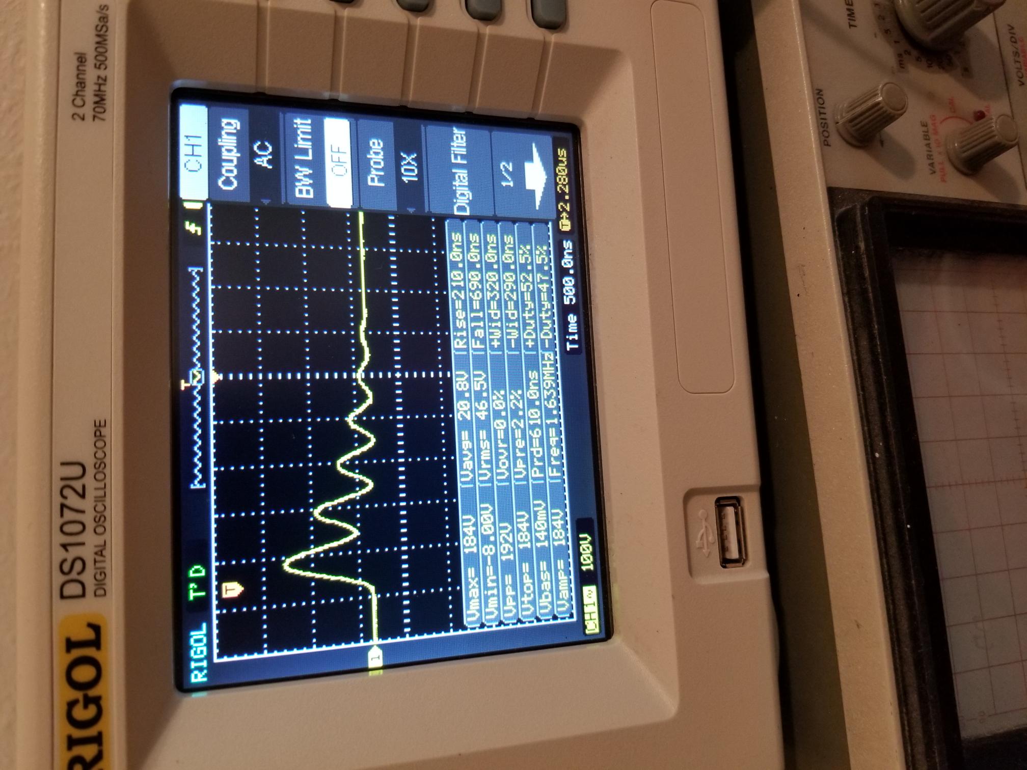

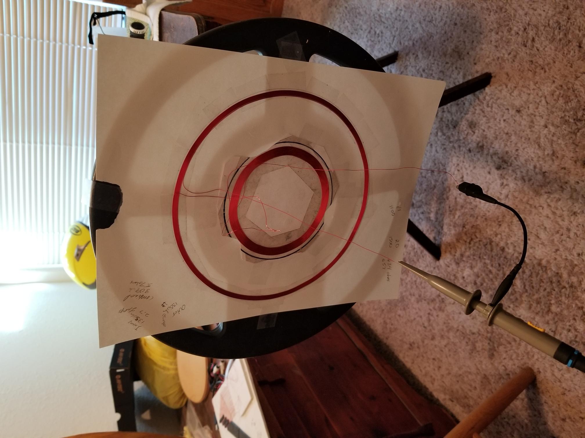

                          I went ahead and got the #s on the coils.
                          Im a bit suprised by the capacitance of the single coils and the end result.
                          the coils are 30 awg tested with no leads.
                          Inner coil----------- outer coil---------------combined
                          25 wraps135uh-----15 wraps135uh--------309uh
                          2.9 ohms------------3.3 ohms---------------5.6 ohms
                          1.316 Mhz-----------1.496 Mhz-------------1.639 Mhz
                          108Pf----------------83.8pf------------------30.516pf
                          scope shot is of both coils together.
ID:	355082Click image for larger version

                              I would expect SRF to be a lot higher using the loop method with a spiral wrap coil.
