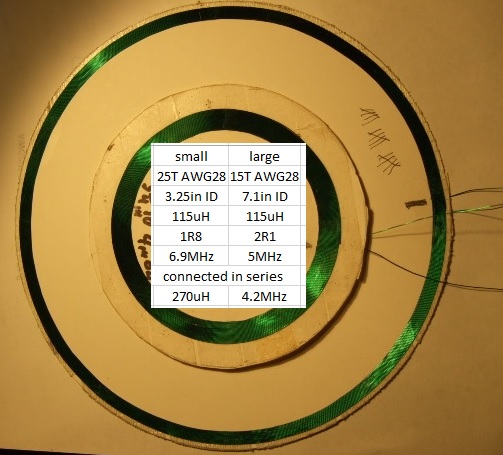

        Used the small and large coil to make a dual field coil. inductance and SRF measurements a little different than picture. Maybe measurement difference or I super glued the wire to the backing after measuring the first time. Wires were loosening from tape.
        coil__________uH________SRF MHz
        small________115________6.67____calculated Rd=2410, small and large coils measured one at a time, not near each other
        large________115________4.5
        series________271_______4.16_____connected in series, outer small to inner large
        series________271_______1.25 MHz circuit resonance with added graphite shield and 30 inches twisted pair lead. connected to Tx circuit, MUR460 diode to inner small, outer large connected to +supply. external Rd not connected. 2410R across small coil to damp small coil.
        adjusted external R for critical damping looking at coil decay on scope, Rd=1390R, calculates 1064R, didn't see any ringing, scope trace decay looked good. Didn't try internal damping both coils, looked good with just the small coil damped.

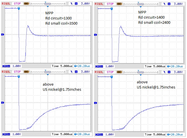

        Tested the completed dual field coil, shielded with 30inch lead with a MPP today.
        Placed a loop on the dual coil. Reduced Rd across small coil until oscillation went away. Scope picture of MPP amplifier out. Repeated with calculated small coil Rd(6.67*115*pi=2410). Don't see a difference, Maybe calculated or a little higher is good.
        Removed loop when recording amplifier out, acted as target. Lowering circuit Rd lowers overshoot but still flattens out around 10us.

                I'm not clear about the steps you are taking for damping the dual coils.
                For example, my feeling is the external Rd value should be the primary damping variable, the actual inner coil Rd value in practice would always be much higher than a calculated value derived from the open coil SRF parameters of the inner coil.
                I guess what I'm saying is that the external Rd does damp the ringing energy attributed to both coils(both coils are after all, in series)
                If you lower the value of the external Rd, this will allow a significant increase of the internal Rd, which is more preferable, because you want most of the energy passing through the inner coil instead of bypassing via the inner Rd.
                If not, you may see perfect waveform with no ringing, but the sensitivity may be poor, especially for the inner coil.
                First this what I did, maybe not the best way. Completed dual field coil connected to MPP
                Can't see the small coil oscillation at amplifier out so used a loop(ground lead connected to probe)on the coil to look for small coil oscillation. Used a pot to adjust small coil Rd, reduced resistance until small coil oscillation stopped. about 3500R. Don't remember what circuit Rd was, maybe open with just Rin connected. Then adjusted circuit Rd with a pot(loop removed). Repeated with small coil Rd=calculated 2400R. Amplifier out looks the same with small coil Rd=2400 or 3500, don't know if making it higher would make the signal better. I'll try again with a higher small coil Rd and adjust circuit Rd to see if small coil oscillation stops and verify what I had for circuit Rd when looking for the small coil oscillation to stop.
