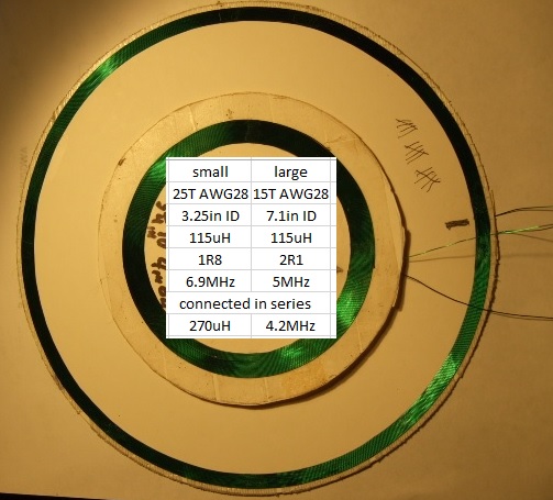

        • For the dual field coil, I cannot be sure of how to setup such a coil without actually trying to build one and put it to the test.
          For example, how do you know which of the two Rd's to tweak? How do you know which of the two coils is ringing, or maybe both? How do you calculate a theoretical Rd for just the inner coil based on the in-circuit resonance?
          Overall, how do you know when you have the sweet spot nailed down on a dual field coil?? Or maybe it is best to just copy TDI front end, and reverse engineer one of there dual field coils.
          • Used the small and large coil to make a dual field coil. inductance and SRF measurements a little different than picture. Maybe measurement difference or I super glued the wire to the backing after measuring the first time. Wires were loosening from tape.
            coil__________uH________SRF MHz
            small________115________6.67____calculated Rd=2410, small and large coils measured one at a time, not near each other
            large________115________4.5
            series________271_______4.16_____connected in series, outer small to inner large
            series________271_______1.25 MHz circuit resonance with added graphite shield and 30 inches twisted pair lead. connected to Tx circuit, MUR460 diode to inner small, outer large connected to +supply. external Rd not connected. 2410R across small coil to damp small coil.
            adjusted external R for critical damping looking at coil decay on scope, Rd=1390R, calculates 1064R, didn't see any ringing, scope trace decay looked good. Didn't try internal damping both coils, looked good with just the small coil damped.
            • Great, so you damped the inner coil first using calculated Rd 2410 based on the 6.67mHz SRF.
              Are you saying that you connected each coil individually to the Tx to measure the in circuit resonance, is that how you got the 6.67mHz and 4.5mHz respectively?
              Or by other method?
              OK, so no ringing, but how can you be sure the inner coil isn't woefully underdamped (or overdamped) and the whole setup is compensated by external R.
              • Can you bring the your dual field coils anywhere near critical damping by just using external R (no inner coil Rd), then put in damping tool and adjust inner Rd to get rid of remaining oscillations? Then measure the Rd for inner coil and see where it is in relation to 2410.

                    • OK. According to the patent, the small coil is isolated from the pulse source by the inductance of the larger coil and will ring at the frequency determined by its own parameters.
                      I think this statement is somewhat misleading.
                      Although it is isolated from the pulse source, its ringing will still be influenced by the totality of the circuit.
                      The inner coil is never really "critically damped" in the conventional sense as it applies to a standard mono loop. Why? My theory is that the inner coil is actually part of one single coil split in two parts. So it is the two coils taken as a WHOLE that is damped by the dominant external Rd. Any residual ringing could then be attributed to the small coil and damped out by inner Rd.
                      • To verify all of this, and to actually understand a dual coil behavior in circuit, you need to connect two damping tools and have a play with adjusting both of them, to see how the coils behave with preferred targets.
                        Another thing you can do is to try increasing the value of your 2410 Rd and see when you start to pick up overall ringing on the scope.
                        I'd bet you could go as high as 4K or even higher before you see anything.
