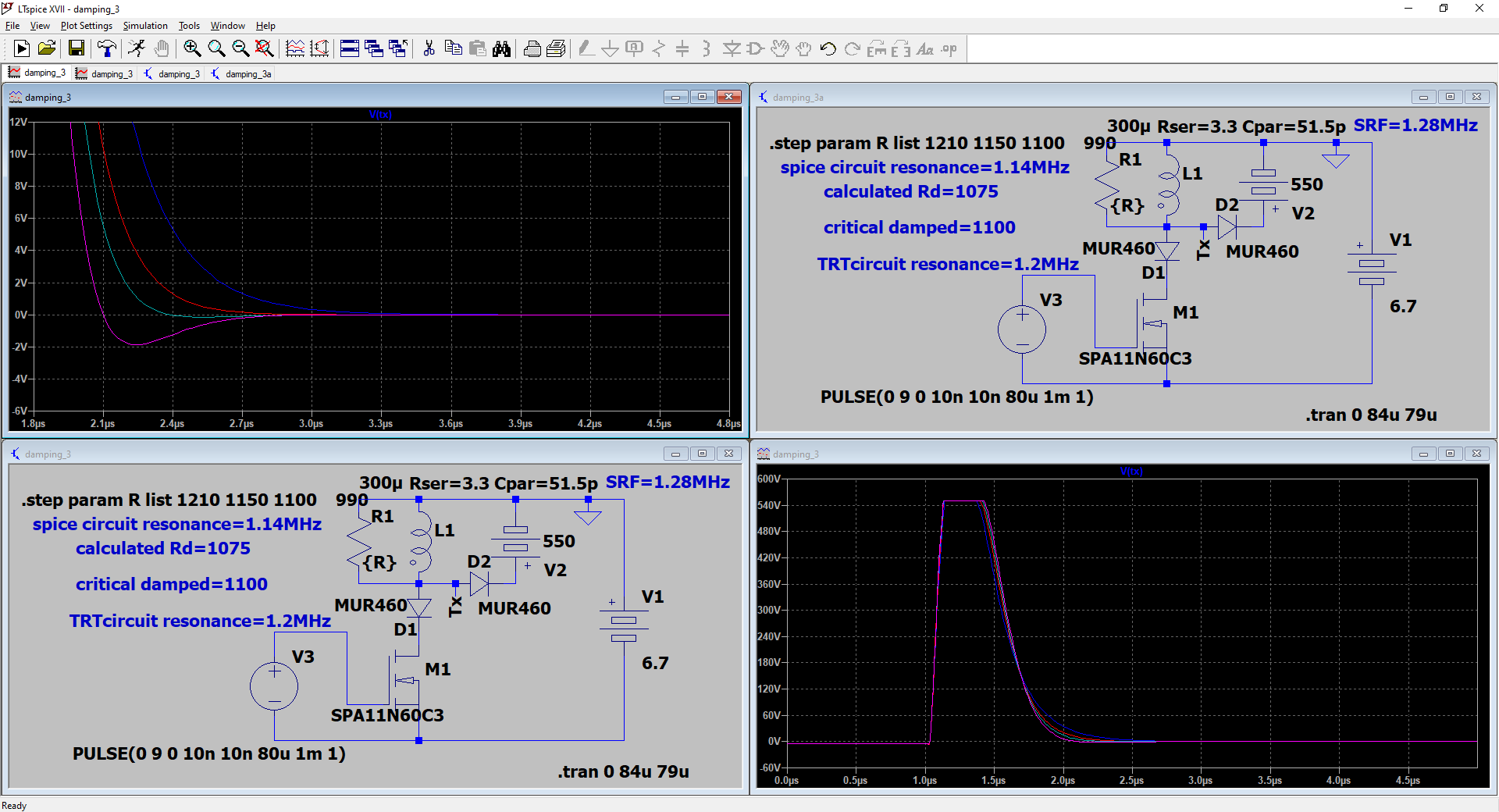

            • Connected a completed mono coil(shielded with leads) to my TRT Tx. Want to try damping the coil. Made spice simulation using the coil parameters. Spice circuit resonance a little lower than TRT Tx, maybe due to a different Mosfet or added V2 and D2 for avalanche volts? The coil decay looks a little better slightly underdamped(1150 ohms)? 1100 is close to critical, 1100*1.1=1200 and 1100*.9=990. Including zip.
              Not sure my scope is going to let me see the lower part of the decay.

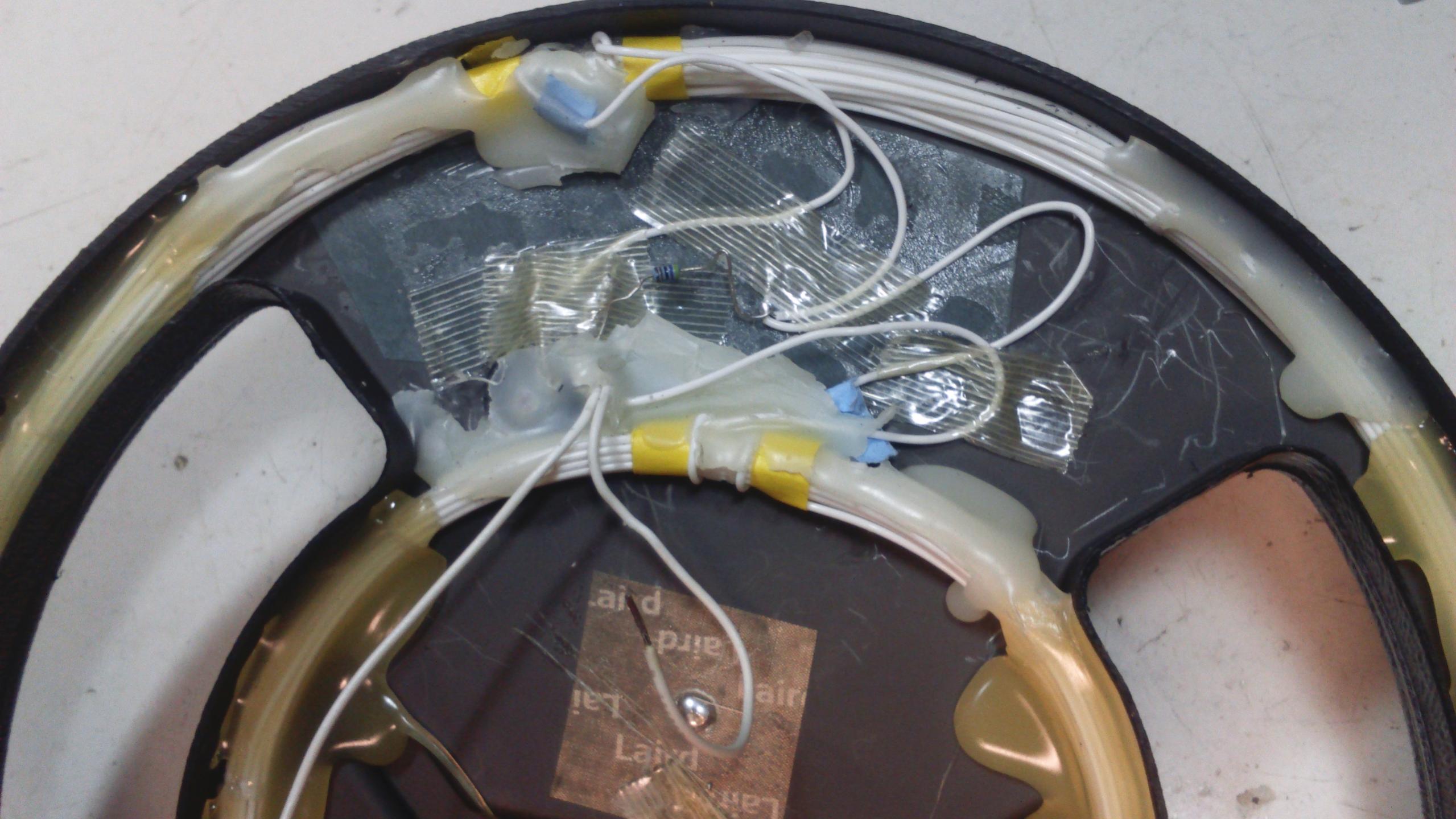

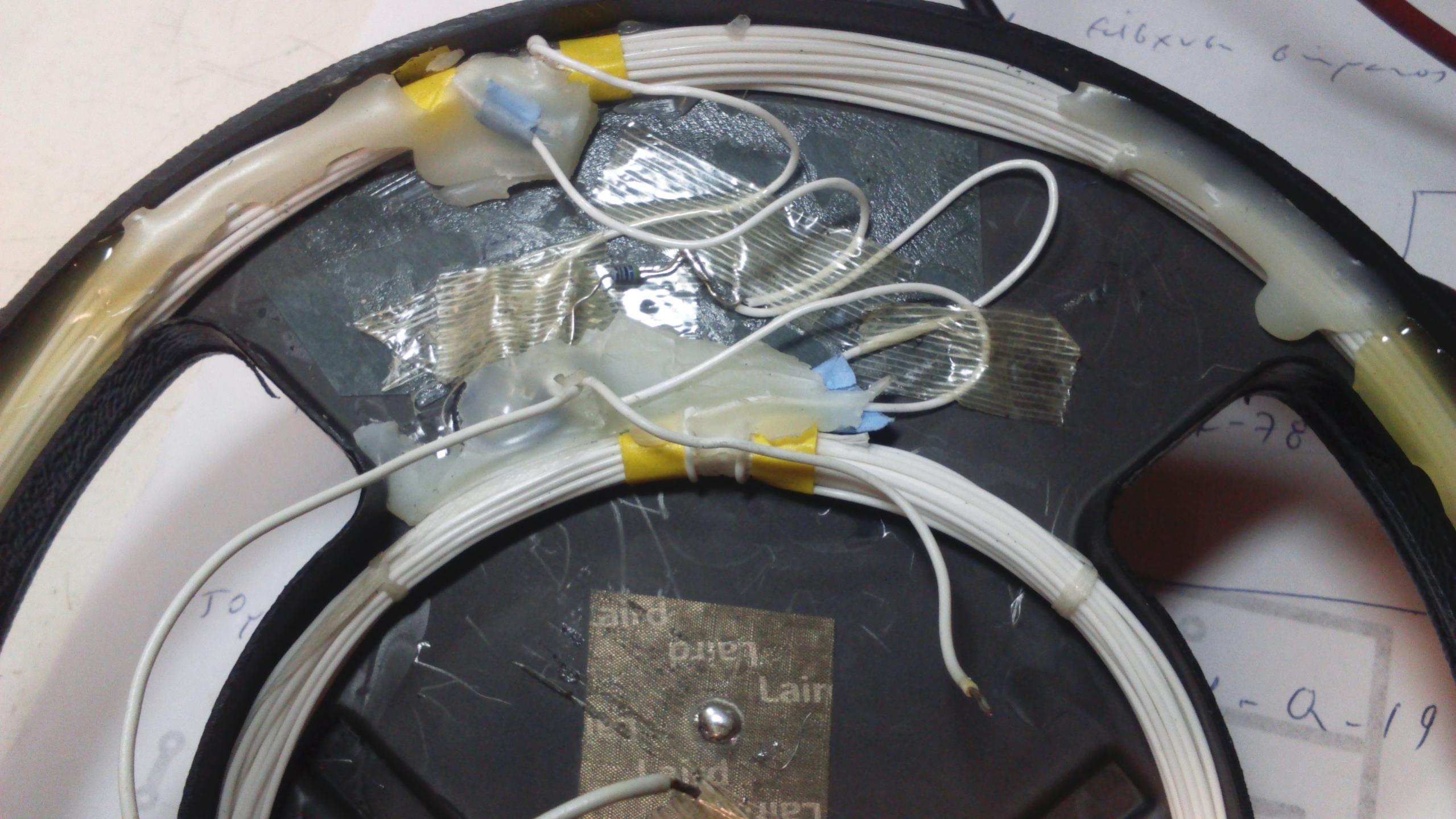

                      I scoured the forum for any information on the TDI DUAL FIELD coil, and look what I found, see anything familiar?
                      YES THERE IS A DAMPING RESISTOR IN THE COIL HOUSING FOR THE INNER COIL. And what's more, we can read it's value!!!
                      I make it out to be 4.7K@1% tolerance. Yellow violet black brown brown. A four band jobby.
                      • The wire looks to be a multi strand type, but not silver coated?? The insulation looks to be thickish. Pretty straightforward actually. No magic there, just as how the patent describes.
                        Now question is what can be inferred from such a high Rd value for the inner coil?
                        And what about the other damping resistor, I assume it's in the control box. I guess it's value would be pretty low? Say between 500-700 ohms.

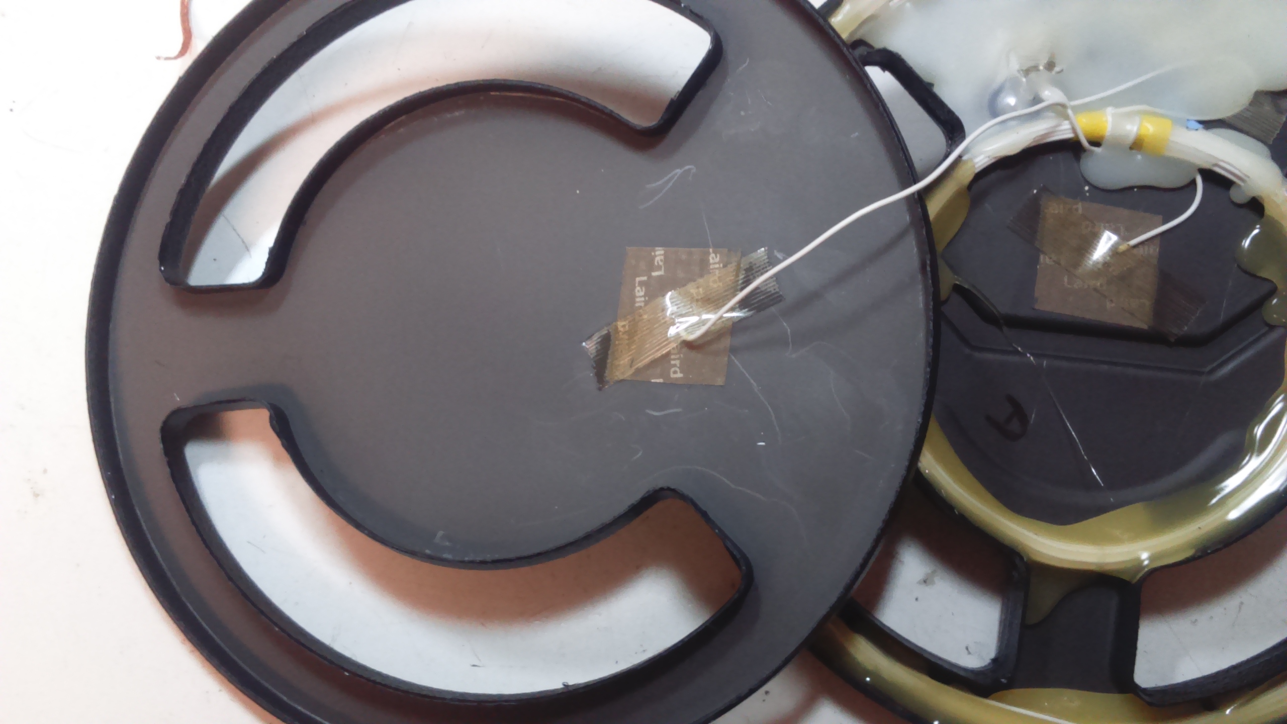

                          • Quick note for fun tested the 12" dual field with the dip meter. 3.154Mhz. thinking that dip meter #s should be devided in half for a PI coil to be more accurate.
                            Ill hit it with a genny later.
                            • 4.7K Rd for the whites inner coil makes me think it is overdamped because of the reflective interaction of the two coils.
                              I think I'm confusing myself.
                              Does increasing the Rd increase(overdamp) or decrease(underdamp) the coil??? My brain is starting to hurt. I had to refresh my scientific notation skills just to do the algebra using those pF and uH variables. Then I came up with a simplified shorthand for these calculations that I can do in the mind quickly. But it is still a chore.
                                Low resistance overdamps, Open circuit oscillates. Rd=pi*L*frequency, L*frequency=4700/pi or L*frequency=1500. If L=300uH, frequency would=5MHz. I would guess underdamped.
