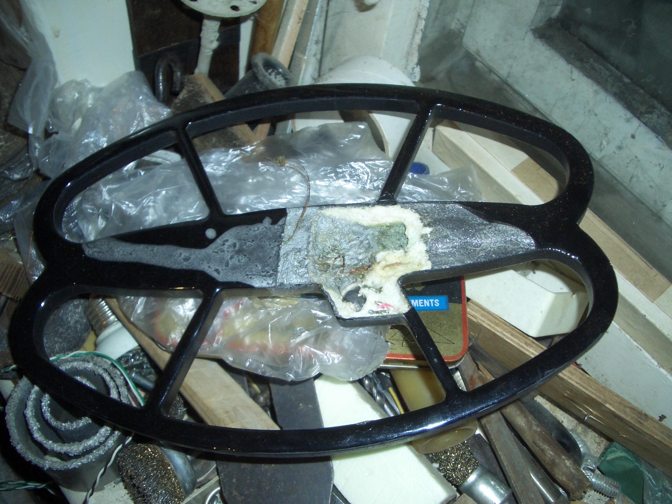

                            Hi all. I came across 2 Sov Tornado coils 8" & 10" a while ago. I have a friend trying to bring them back to life. The problem is, I need 2 new coil connectors and the pin outs for them. ML won't give out the info, because its a company secret... REALLY? On discontinued and unsupported...
                            • #44
                              I'm pretty sure all Sovereign coils have the internal pre-amp circuit board.
                              • #45
                                Confirmed the internal pre-amp
                                Reaching out to the forum, especially those who have built their own coils for the sovereign/excal detectors. I am interested in building/modifying a few coils for my blue excal in an attempt to customize them for my particular area and gain the best depth and stability. With my research so...
                                If it can get it for cheap, I don't mind ripping out the pre-amp. Lets see how much the auction goes for.
