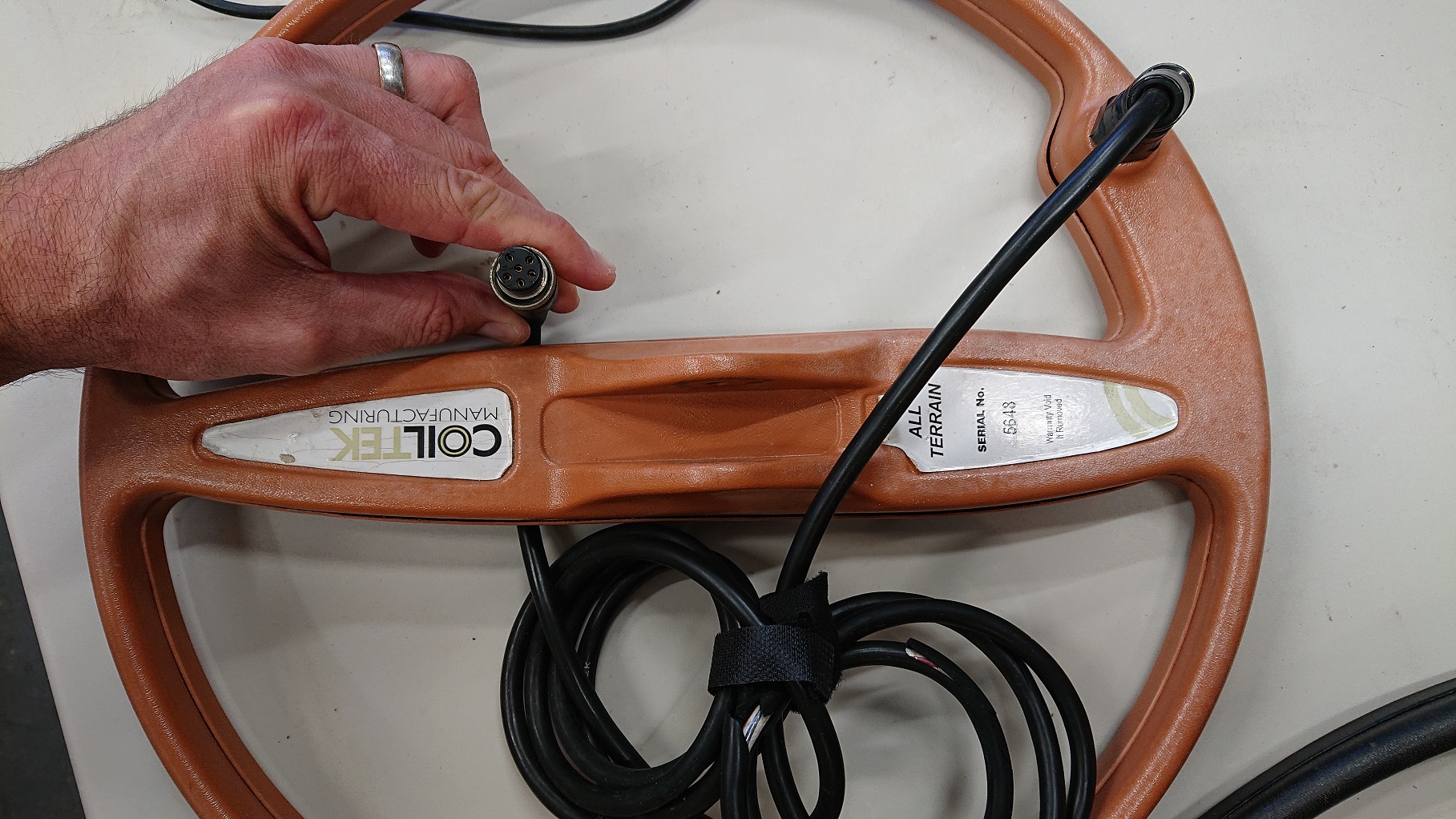

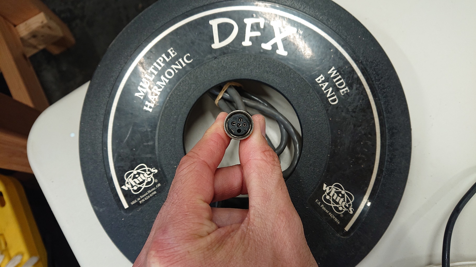

    It's been a while, but I have managed to scrounge up 4 different coils. All in unknown health. If any one has a guess as to the pin out's of any of the coils, that would be a great starting point, and help me out a bunch. Pics attached.Click image for larger version

      That's a random mix.
      Your orange Coiltek WOT is most likely for a Minelab BBS machine like a Sovereign, it will have a pre-amp inside it.

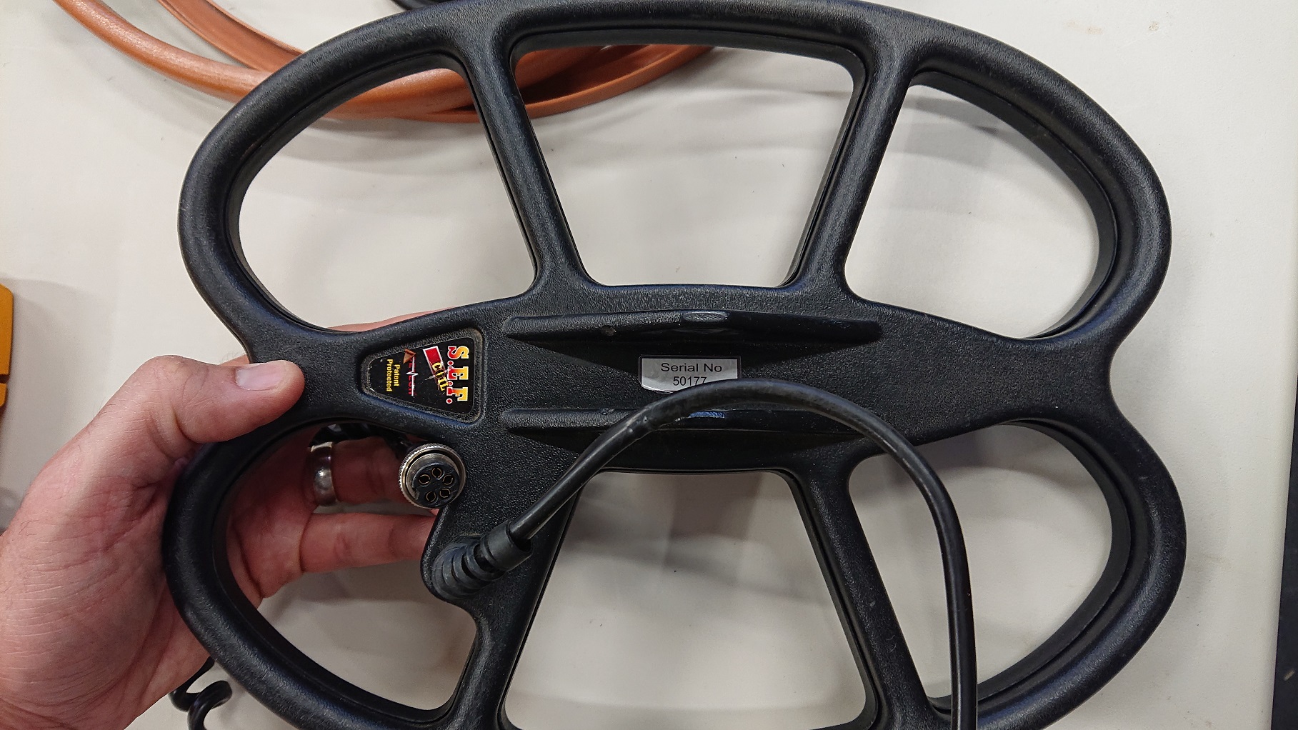

      The SEF is probably for a First Texas machine, likely candidates being Teknetics greek-series/G2/Fisher F19/F5, or the Teknetics T2, or the Fisher F75. Try and work out the pinout with a resistance test, that will narrow down things.
      White's DFX is common enough, the details should be on here somewhere, I believe they are fundamentally the same as those for the Whites V3 machine, but not so tightly specified.

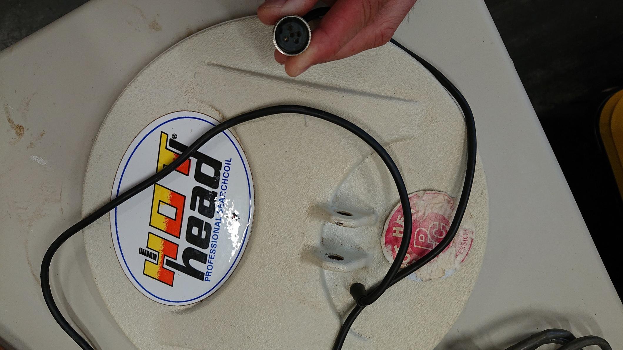

      I don't know what the hothead is for, I'm sure someone here will recognise it. Older single freq machines from Whites, Fisher are likely.

        Ya, a rather random mix, but great for ripping apart, and learning. Here is what I was able to learn with my Volt/inductance meters.
        DFX:
        Pins 1->2 = 37.2 ohms, 390pF, 414500hz
        Pins 4->5 = 3.2 ohms, 344pF, 419850hz
        HotHead:
        Pins 1->3 = 472.3K ohms
        Pins 1->4 = 4.8 ohoms, 785.0pF, 368510hz
        Pins 3->4 = 472.1K ohms

        CoilTek (suspecting internal pre-amp):
        Pins 1->2 = 2.4 ohms
        Pins 3->4 = 2.34K ohms
        • #49
          The SEF beep-out looks a mess. I'd be tempted to remove the connector shell and take a look at the internals. I think if you remove the two cable-clamp screws and the single countersunk one ( which may be threadlocked) the metal body will rotate a small way, then it can be pulled off, kinda like a bayonet light-bulb. Then you can looks for shorts, etc. The cable may also be a guide. If there's one single-core screened cable and one two-core screened cable, the single-core will be the RX, the two-core is the TX in some fashion. These CB-radio microphone connectors are 50 cent junk, with inadequate strain-relief, and wiring problems are common.
          The DFX beep-out looks reasonable, the low resistance is the TX winding, the high resistance is the RX. The DFX is a multi-freq machine, forcing a complex square-wave signal onto the TX coil. TX coil inductance is lower on this type of coil, compared to the typical tuned resonant single freq coil.

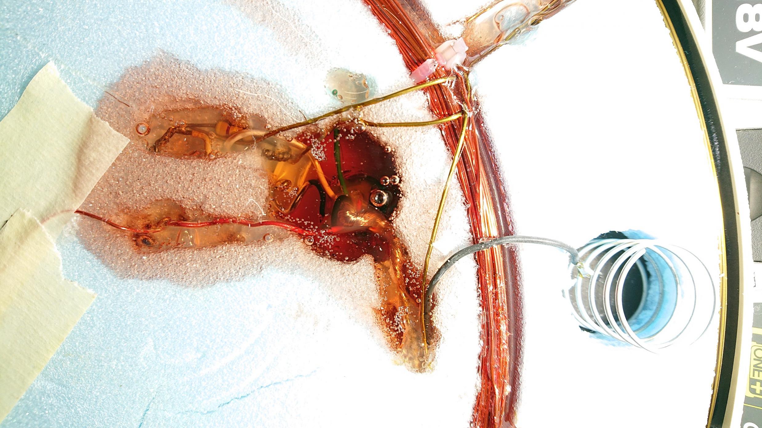

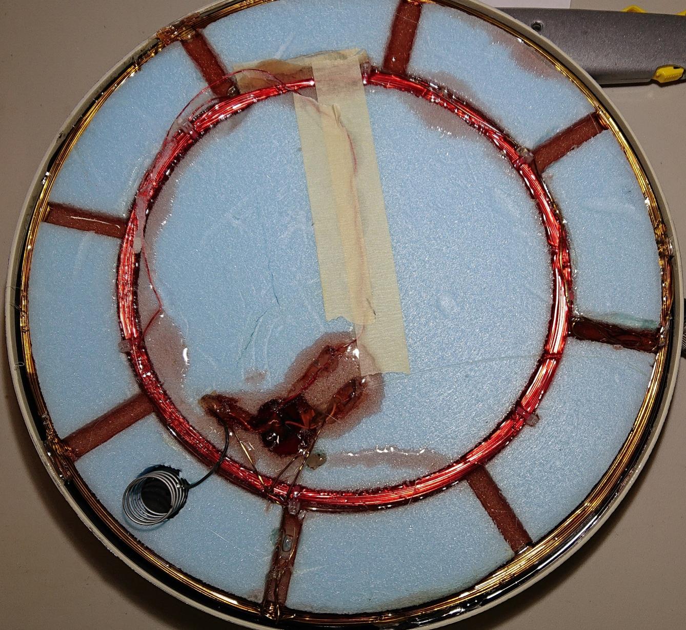

            Took a knife to the HotHead. Pics attached.

                The SEF beepout looks normal now, but I've no idea what machine it's for, certainly not those Fisher/Tek machines I listed earlier. I would guess the TX winding is the low-resistance one, the 6 ohm winding is the RX.
                The Hothead beep-out is suspicious, too. The 400 Kohm is due to the resistor visible in the potting resin, this will be some part of how they get the coil nulled correctly. The two coils will have resistances under 50 ohms, maybe check the connector wiring on that one too.
                  Interesting, they made the RX coil quite a bit larger than normal.

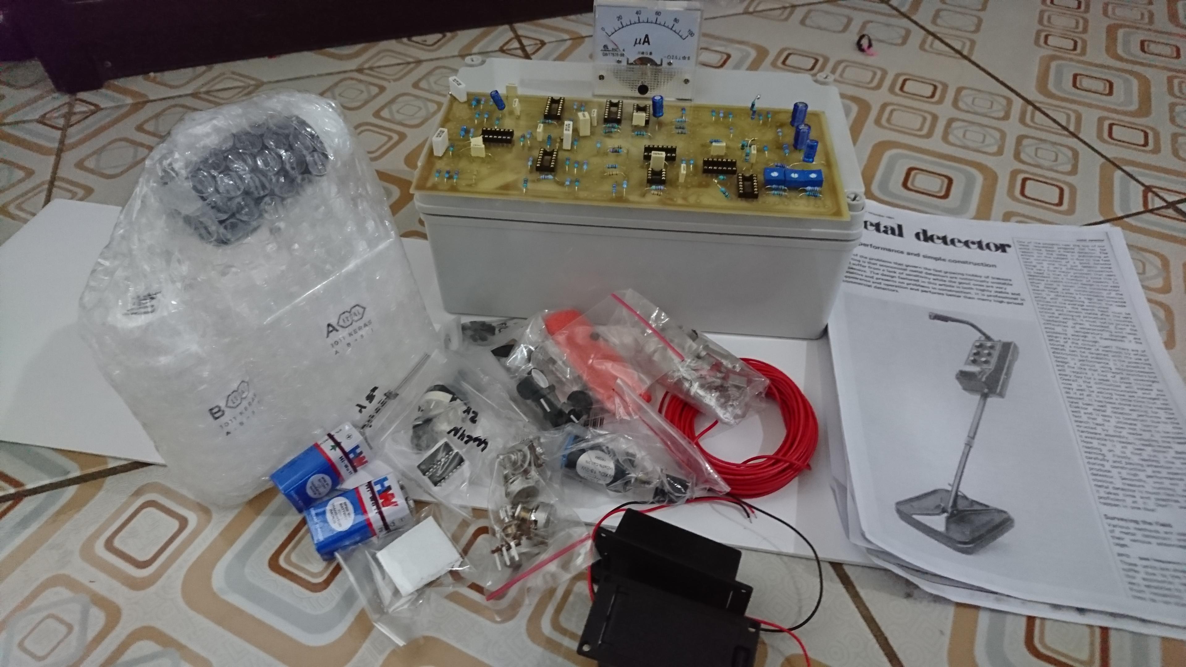

                    So, have you made this coil by now? I assumed what you trying yo build is the old published e l e k t o r 81's magazine , coz that just exactly what I'm looking for by now. Correct me if I'm wrong.... or is there someone out there successful build the project?
                        Yes, I'm reminded by what Payne said. The ratios need to be kept within certain "reasonable" limits.
                          That particular project, is a pll driven TX, bipolar transistor array. But there was an error in the PCB layout.
                            That resistor is fundamental to the feedback of the RX coil, and indeed it is meant for nulling or what we refer to as "balancing".
                              Thanks for remind this, do you recall which errors on what part of PCB that contains errors??? coz I have build half way for this project, so I get fast way to fix it. I really appreciate you for this Click image for larger version
