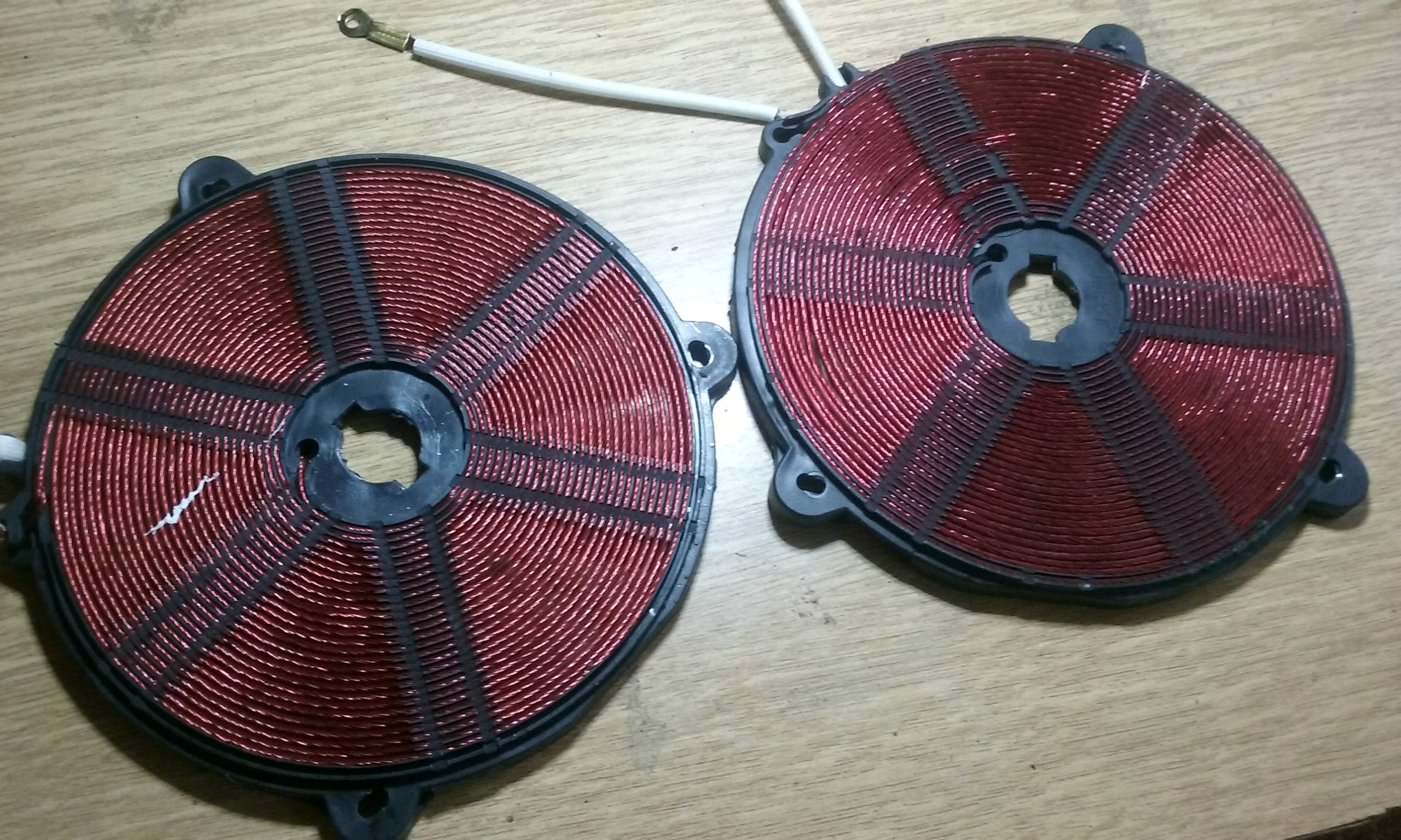

    From induction cooker.
    0.4 ohms.
    0.07mH (70uH).
    This would be indeed fast coil.
    How to drive it properly?

    How to drive it properly? Put it back in the cooktop I'd suggest.
    How much faster than 5uS do you want? Just curious.
      Experimenting...
        I am not familiar with igbt's so i guess i'll had to read some articles.

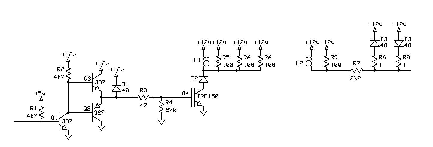

        Here is possible driving circuit.
        Problem is; igbt will not tolerate common impulse that we can see on many PI designs.
        Maybe all this is wrong.
        Maybe i should try to use this coil only for Rx.
        But what's better way to learn than to burn to ashes few expensive components?!

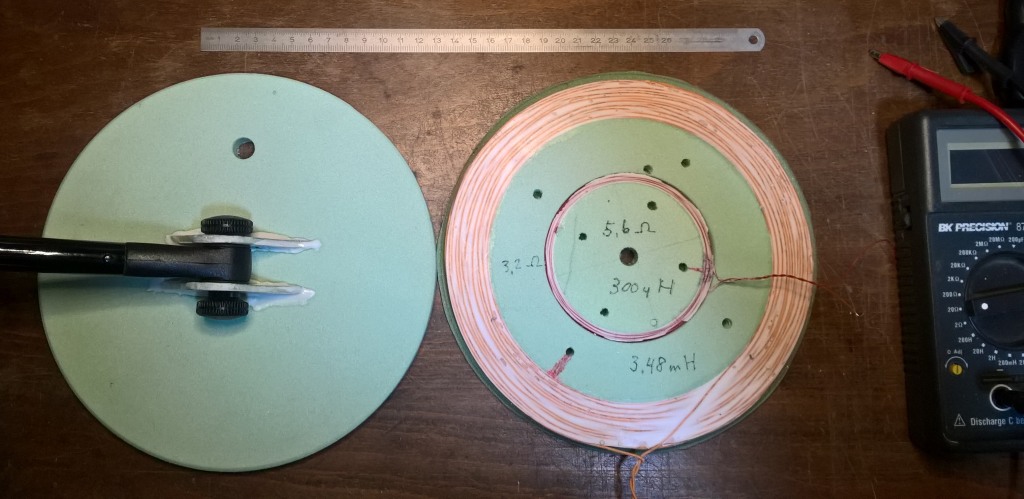

            Attached is a scope picture of a "fast, slow coil".
            As you can see, it is perfectly damped at about 2us.
            The red trace is the Mosfet gate pulse OFF.
            The blue trace is the Flyback, about 760V
            The diameter is 200mm
            Here is the challenge: Who dares to guess the answers?
            How many uH does the coil have?
            How many turns does the coil have?
            What is the DC resistance?
            Hint, this is no ordinary PI. I would call it advanced.

                        Interesting trace. Usually the first half of the decay would be faster than the last half. Only way I can get a trace that looks similar, is to underdamp and let the return to zero go to -.6V across the MOSFET. Would be hard to see with 200V/div. Wondering how you get the mirror image critical damped.
                        You make some very good observations here. I will try to take a detailed picture of the zero level for you.
                        In the meantime, a picture of the coil, before assembly.
                              OK, here is the picture of the fast-slow coil, TX&RX again
