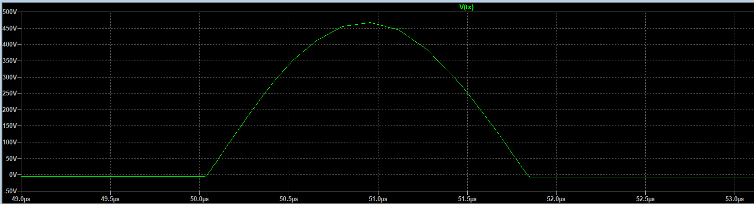

        Interesting trace. Usually the first half of the decay would be faster than the last half. Only way I can get a trace that looks similar, is to underdamp and let the return to zero go to -.6V across the MOSFET. Would be hard to see with 200V/div. Wondering how you get the mirror image critical damped.
        I have noticed deformations of the flyback half sine, like you mention, at other times. Sometimes it is the type of Mosfet, sometimes it involves shielding or cables.
        The present coil and TX setup is the result of making hundreds of coils and trying dozens of different Mosfets and dozens of different cables and hundreds of different timing schedules.
        This coil is not shielded yet.
        This result is only attained when everything is just right.
        Attached is the 1000V test. Damped at about 3us.
        Also the 50V div. picture. I can not do lower than that.
          Underdamped Tx off with spice.

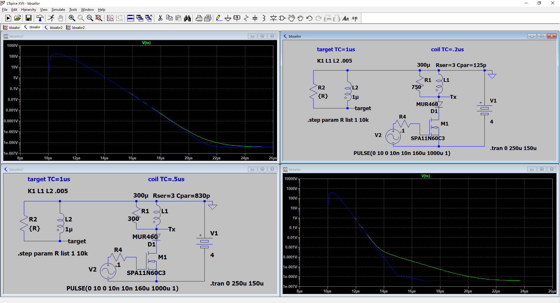

            1. A fully stimulated target needs a coil discharge time constant (TC) five times faster than the targets TC. The coil discharge TC is based on the coil inductance divided by the damping resistor value and any other resistors such as the op amp input resistor being grounded when the clamping diodes are on.
            5x works well, it provides for a 90.6% efficiency. Other efficiencies are:
            1x = 63.2%
            2x = 78.7%
            4x = 88.5%
            8x = 94.0%
            50x = 99%
            So even 2x faster than the target tau works pretty well.
            Also, the discharge TC is 0.5*L/R, not L/R... assuming critical damping.

                Numbers look like what I remember from the past. Tried with spice again to work my brain. Don't know if it looks right, thought coil 2x faster than target would look different. Anyone see what I might be doing wrong?

                  ... The optimum coil discharge TC to fully stimulate the target is 2/5 or .4 uS and would need the damping resistor to be 750 ohms (300/750 is .4). If the delay is set at 10us, the stimulated target eddy current energy will be zero at this delay so a delay of 7 or 8 us would be needed to detect this target. As targets get smaller, tinkering with coil designs need to keep these things in mind (no pun intended).
