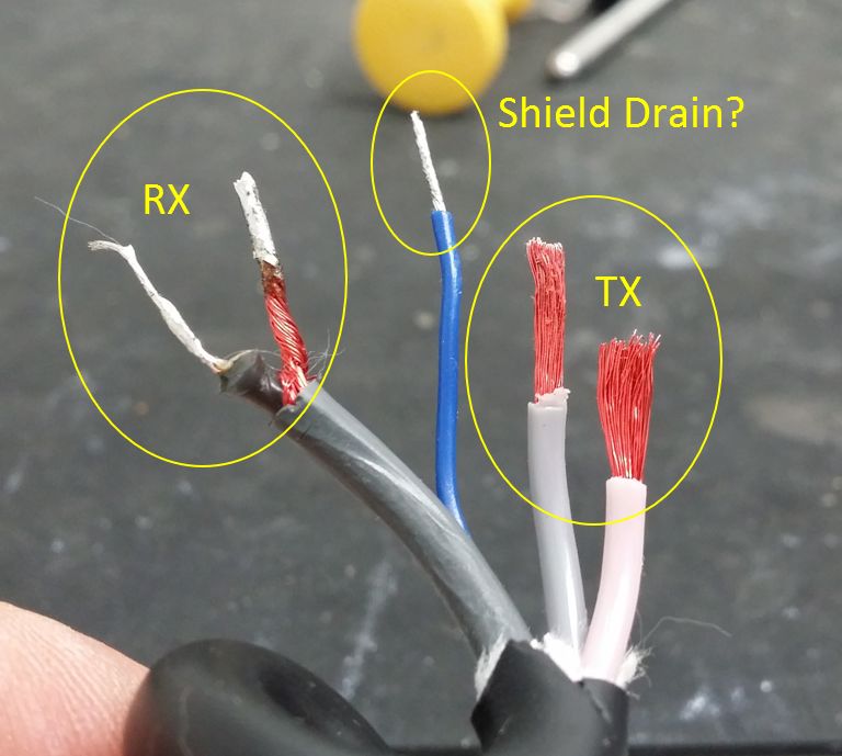

    Anyway, I've been gathering some info to see if I can do it and all is good so far except I've encountered a wire that appears to be floating, I suspect it is the shield drain wire that is steered to the control box for analysis or simply earthing to the front-end without interfering with the TX and RX circuits. It measures 689pF in relation to the TX coil, so I guess it's the shield drain?

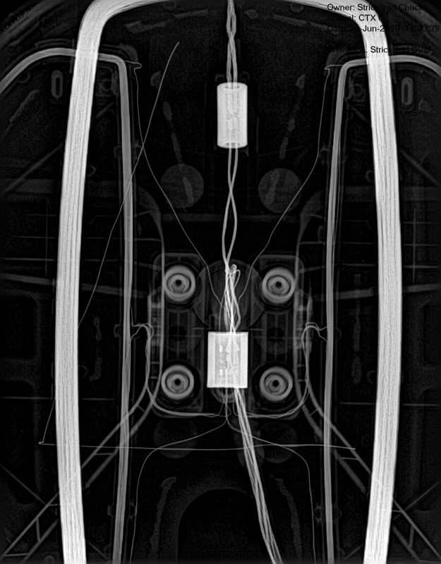

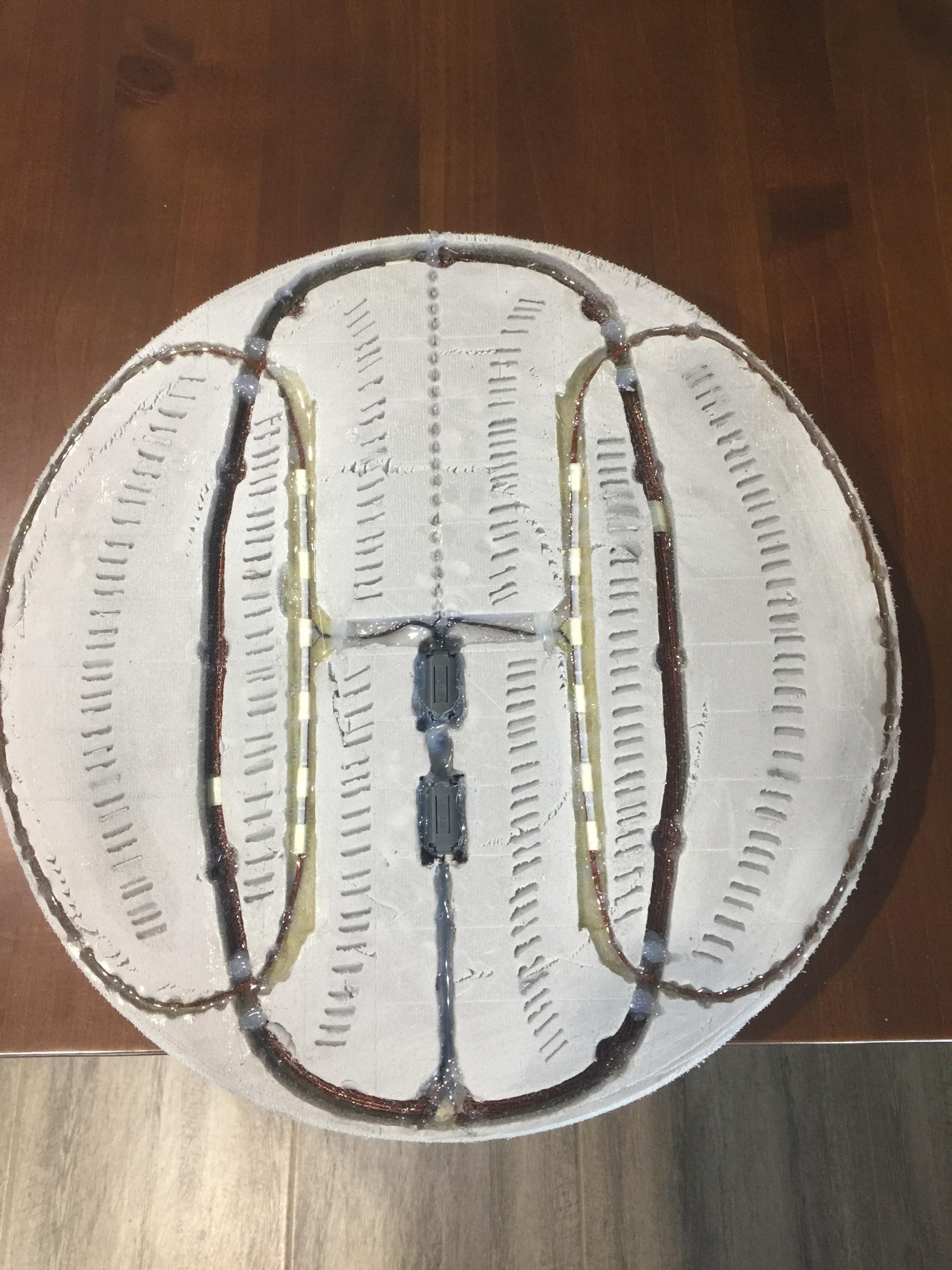

    I'm not willing to dismantle my 14" nor destroy the 19" to see what the actual coils are made of, but a couple of images give some indications. On the Minelab x-ray image the RX coils are possibly simple enamelled wire, and the TX a woven enamelled wire or litz (can be seen best above the upper ferrite).
    The Russian coil appears to use enamelled for the RX and it looks like a litz for the TX (the silicon soaked clothe wrap could give an enamelled look)
    Not sure now if I should make an enamel pseudo-litz winding jig or get some real litz from Alibaba. Maybe real stuff might stuff it up?

              Probably the blue wire is a shield connection. I would use RealLitz as making your own is almost impossible. You could build a first-try coil using regular stranded wire for the TX coil, and compare to the original coil. I suspect GPZ performance is super-critically dependent on the coil quality so such an experiment might tell you what to expect when the Litz version isn't good enough.
                In Kev's x-ray photos, first post. It looks like a ferrite tube shielding the solder joints for the tx coil? A few years ago we discussed the patent for this solder joint shield.

                  So that also confirms what Carl and I had suspected, the blue wire is a drain, the 4 corner wires diverging from it.
                  I wonder what the tinned links are used for, would they go to the trouble of shorting out each coil individually to critically dampen the other?
                  I suspect the Russians have used real Litz, funny thing is Minelab Litz is not "true" Litz, just 2 dozen 0.2mm enamelled wound up in no special order. Another thing that makes the large Russian coil superior to the 19" is that they used a conventional coil form and not the flimsy spider web affair that required potting the coil in epoxy to give it strength. Epoxy is a sensitivity killer, I've had real super sensitive coils on the bench go totally deaf after potting. The Russians have used just enough epoxy to attach the coil to the foam, but not to much to deaden it.
