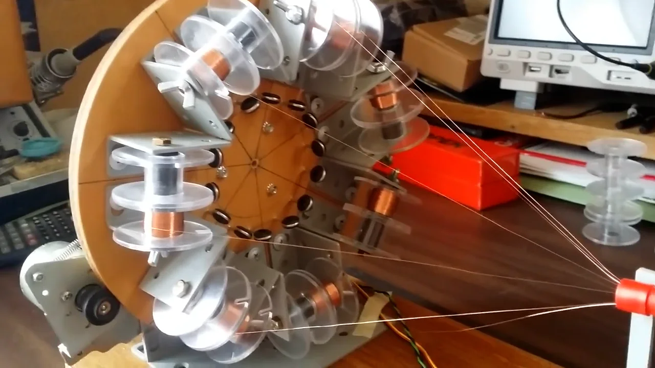

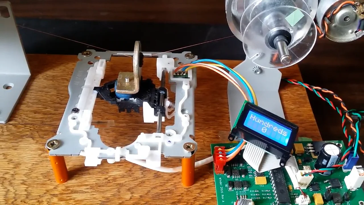

Because the GPZ 7000 is so sensitive I needed to use wire much smaller than 0.2mm to ensure residual currents dissipated fast enough. This required building a wire winder, but first I needed to make a bobbin loader.
Here's a couple of videos showing the bobbin Loader and wire Twister, they're a bit fuzzy, I need to upgrade my phone. They are not quite finished yet I need to install the controllers in boxes, not easy using a QE single handed and the software needs tweaking a bit, but that's for a future rainy day.
I had a bit of trouble getting the tensioning to work on the Twister so bypassed it for now, but the resulting wire seems to work just fine anyway, with a differential strand length of 20 cms over 30 metres, or just over half a percent. I assume given the bandwidth any effects will be minimal.
The Twister motor rotation speed is monitored by a hall sensor and another six pulse per rotation Hall provides rate of travel, this enables fairly precise control of the wire pitch. To digress here, I found that a bucking coil wound with a tighter pitch requires less turns and seems to require much less effort acquiring a fine null point.

The Twister only has 14 bobbins, but with patience very close cables can be made. For instance if a 20 meter cable of 100 conductors is required, wind 200 metres onto 10 bobbins and twist that together. Next cut the 10 ply into 20 metre lengths and load the 10 bobbins again with that and twist together. It seems like a lot of work but when what you require isn't readily available there's no alternative. Plus with each coil cost 1.5 thousand dollars....
