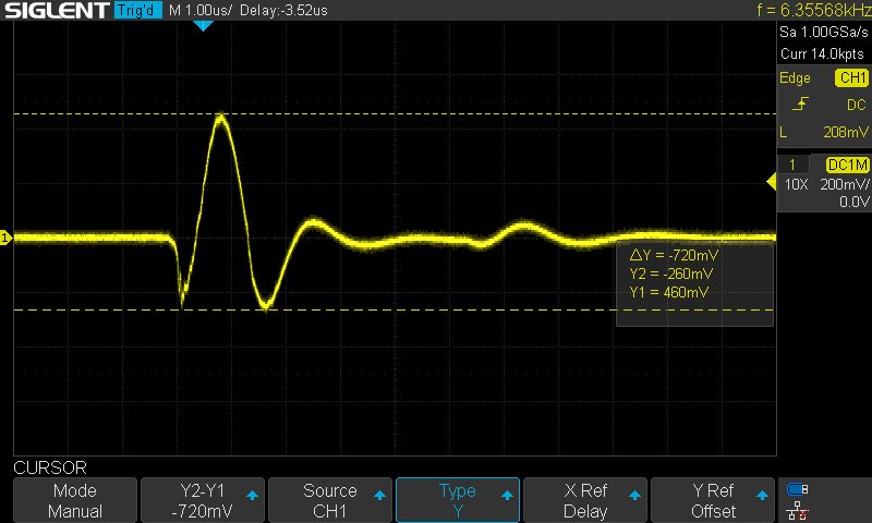

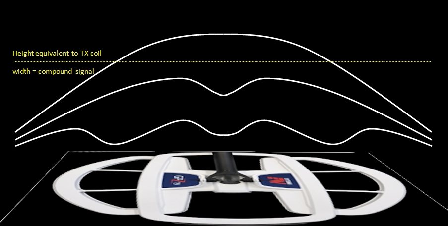

                    Anyway, I hooked up the GPZ-19 to a small TX circuit peak I=750mA and did some target waving.
                    Close to the coil there are 4 positive responses, the inner 2 being the strongest as you'd expect with 2 DDs back to back, and there were 3 nulls or more correctly signal reductions.
                    As I raised the target (actually had to use a bigger one to see the response) the 4 positive responses became 2, and there was a reduction zone between them.
                    When the target height was about the same as the width of the TX coil, the 2 positive responses melded together and became one broad response.
                    I now understand now why a small surface target gives 2 responses and when it's on the digout pile almost impossible to find using usual techniques, given the 4 responses at very close quarters.
                    Another surprise was the almost 3/4 volt pk-pk ripple that rang on for parts of 10uS. At first I thought I needed to install damping resistors, but then remembered Zed's pic showing them installed within the coil. This may explain why my coil is so noisy, I could hardly use it in General timing because of the racket, I should've sent it back to Minelab, if I'd seen this I would've.
                    So is this intentional? Surely not, did some poor Malaysian lackey learn that day their son was hooked on heroin, or did she learn her husband was banging another, was she so out of sorts that she tested it and said to herself "she'll be right", or was the Boss standing over them with a stick, "you must deliver so many by 8 o'clock tonight or your pay will be slashed"
                    I know what goes on in some of these countries, i just hope Minelab chose a reputable employer!
                    If I used 2 targets, one on each RX coil and in varing positions, I wasn't able to reduce the signal completely as you'd expect in an opposing configuration. So it really does appear to be adding, but I assume with the rotation of the RX coils relative to the TX one, as in the case with a simple DD configuration.
                    Here's an image that roughly depicts the responses (makes me think of bernte_one for some reason :-) )
                    And the flyback ringing.

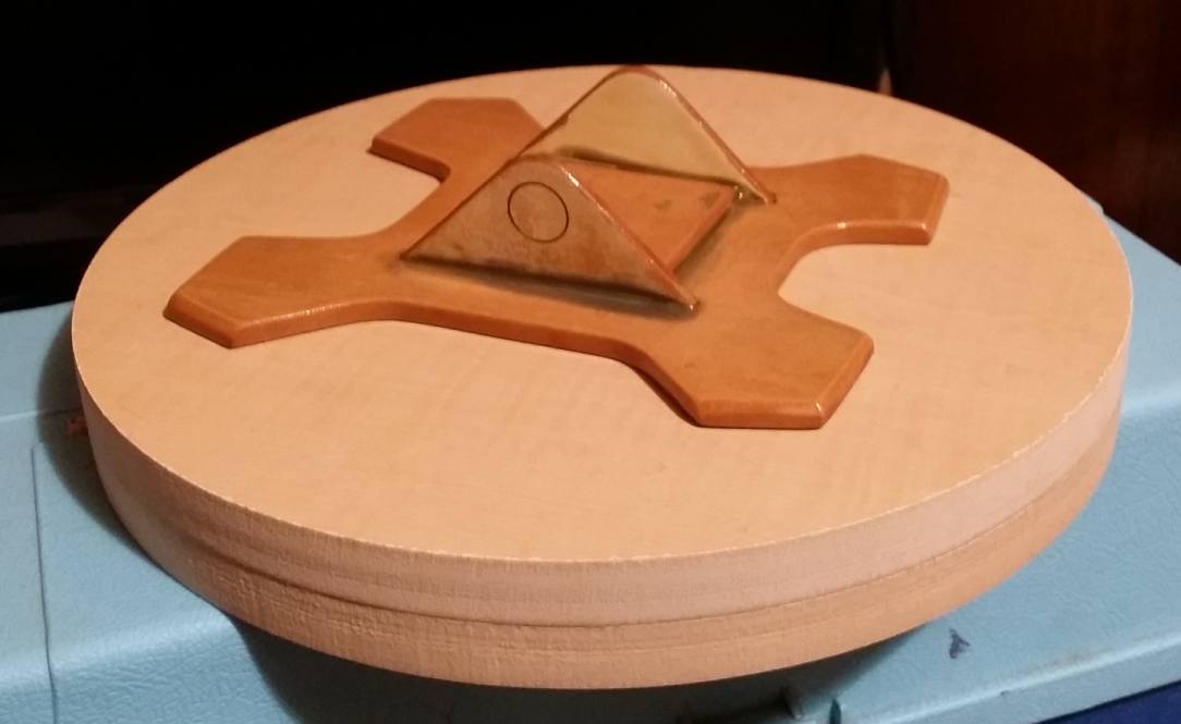

                          Been doing a bit on the shell buck while waiting for parts to arrive.
                          All I had in my scrap corner was MDF, so not sure how durable it will be to hot plastic being drawn over it.
                          I intend to give it a good coat of epoxy and then wax it before use, hopefully it will give a few shells before disintegrating?
                          I've made the ears removable, so they can be used on different shell sizes.
                          I intend using some 1.5mm HIPs (High Impact Polystyrene) which is way cheaper than ABS, but quite flexible.
                          That's the reason for the quite thick ribbing under the ears, I might reinforce this with carbon fiber or similar.
                          I wish I had a small CNC machine it would make things a lot easier, juggling a Dremel in a mini drillpress is better than nothing I suppose.
                          Cheers
                          Kev

                              Hi Kev,
                              I use MDF and it is fine I just fine sand it and give it a dust of talk powder and form but I use 1.0 ABS and 1.5 ABS works fine for me also have used chipboard with out any bad effects.
                              Regards, Ian.

                                Thanks Ian for taking the time and sharing your confirmation, it's nice to know my work probably isn't in vain.
                                I bought some HIPs sheets to make some skid plates and realised that it would probably thermoform nicely.
                                It's just not as rigid as ABS, but it appears to be more scratch resistant, a little more like polycarbonate, plus and a big plus locally it is a quarter of the price of ABS.
                                So with a little strengthening and ribbing it should do the job nicely, I'll share my results here.
                                Cheers
