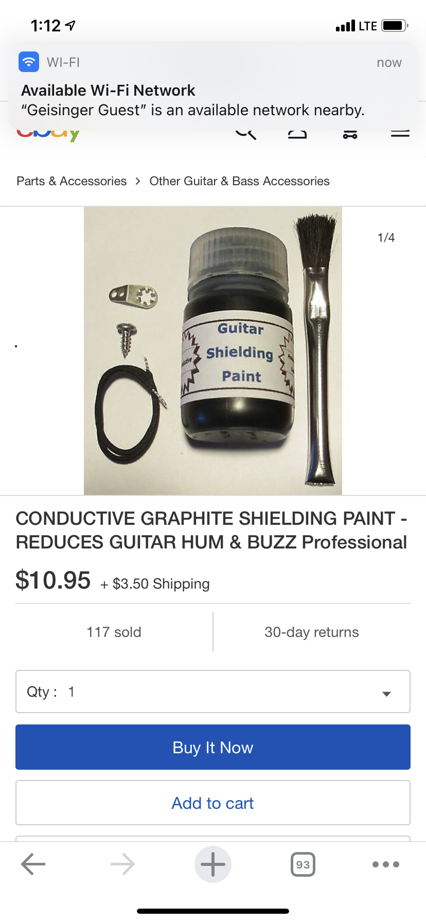

I recently purchased a generic graphite paint for guitar shielding that works great. It?s thick enough that you can embed a drain wire. A couple kohms per square..
