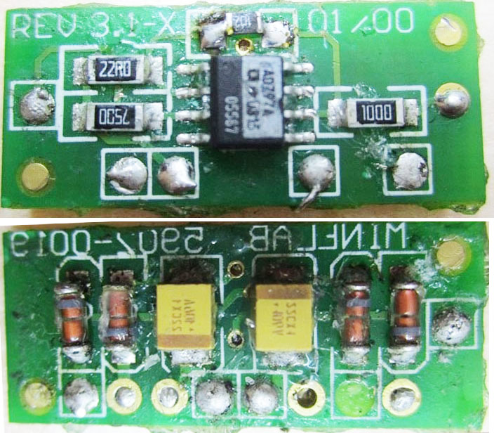

    a friend who owns a sovereing xs A2 pro had his bbs 1000 disc stolen in the trunk of his car. He asks me if I can make a coil .. I do not know what are the data of this coil .. if there is a circuit in it ... ect ... if someone here has this info I am a taker. thank you.
    nobody has the electro characteristics of this coil?
      https://www.geotech1.com/forums/show...233#post151233
      See drawing in post 3 - For the opamps you can use AD797, NE5534, OPA1611, LT1028
        great, thank you for the link to the preamp !! do you have the values ​​for rx and tx?
          The TX is 1000uH 1 ohm. Use 22 awg to keep the resistance low. The Rx coil is less critical at about 400uH, you can use light guage wire here like 28 - 30 AWG.
            thank you Altra. with all this I'm going to try to make one, for my friend!

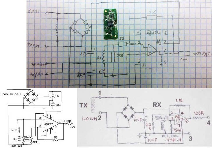

              hi guys, on the forum there are two sov pream diagrams, one uses a single op amp, and the other, more complicated, uses additional transistors as well as a diode. Is there a difference in the end once installed in the coil? which one is the most efficient?
                The transistor version appear to be an earlier design where the transistors are used to achieve lower noise. The AD797 can do this without the transistors.
                  as well as differential pair of general circuit with NE5534

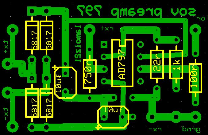

                      hi guys i drew the pcb then engraved. I do everything in crossing elements, I have nothing to do on the surface .. I use low vf 5817 diodes and 15uf tantalum capacitors. I am waiting for my order 797 .. the next question, I wonder what value should the small loop have for the fine tuning of the rx coil?Click image for larger version
Name:	Capture pcb sov 2.JPG

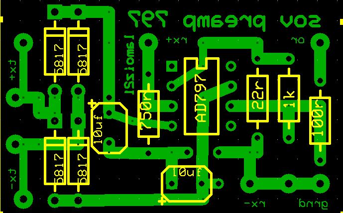

                        I believe you have the diodes and caps reversed. Pin 7 on ad747 is v+. For the loop use a length of about 1 turn of the rx coil
                          sorry, not. not 1. photos sure show there is a hank of the wire. i see 6 on one. so do 4-6 turns.
                            well seen guys !! yes indeed, on the 797 datasheet, pin 7 is v + .. I relied on the diagram given on the forum .. it is therefore wrong on this point. I'll correct that right away. for the wire turns if I use a length of one turn of RX, then on a small loop I would have 5 or 6 turns .. cool thanks guys.Click image for larger version

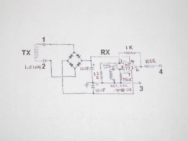

                            I used this diagram ... I hadn't paid attention ... I copied like a donkey ...Click image for larger version
