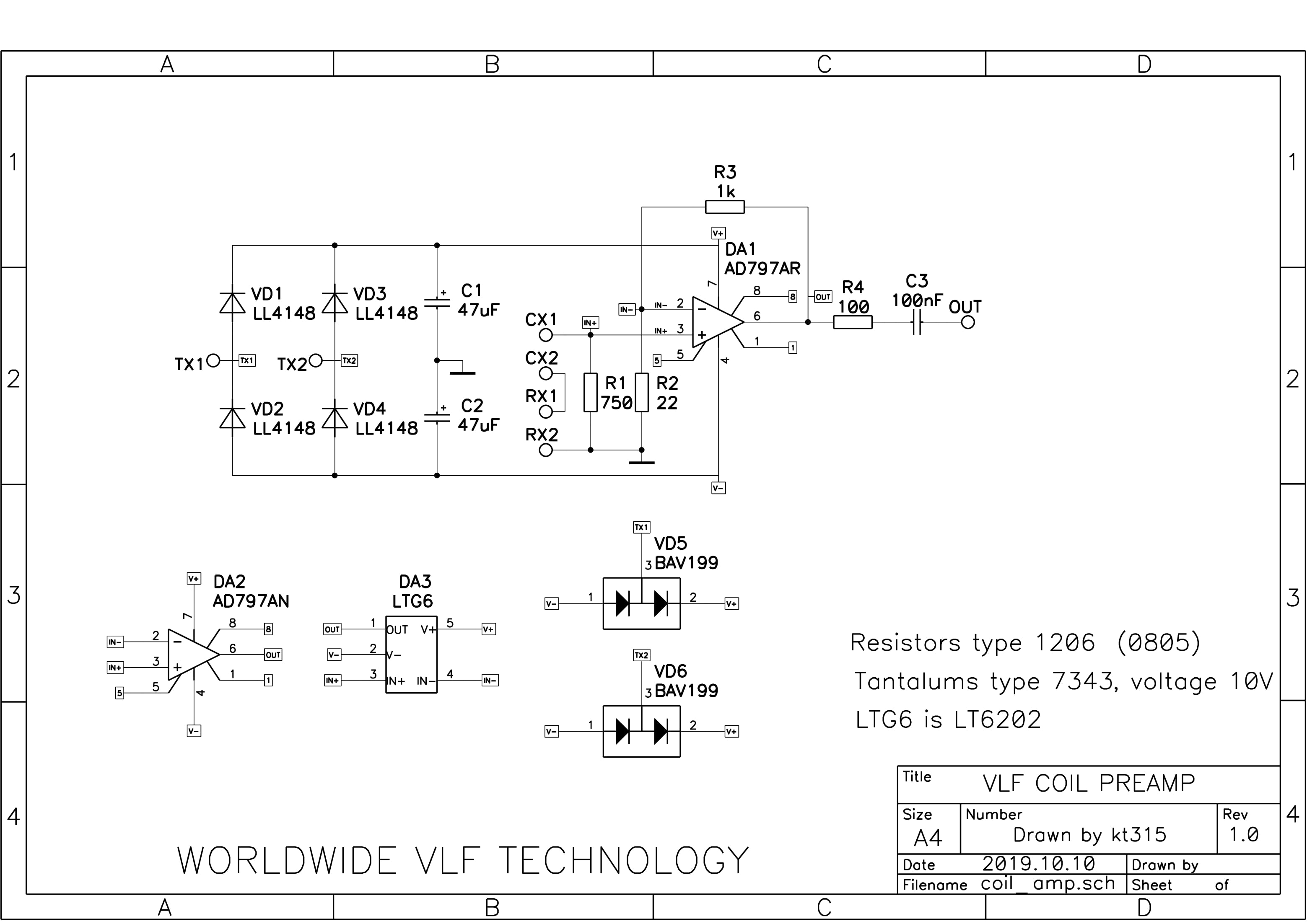

          hi kt, on your preamp diagram of 2019, you added a capa of 100nf in series behind r 100, what is the use? is it for decoupled the output?Click image for larger version

            The 100nf should be across pin 4 and 7 AD797, it is a bypass filter.
            The 100 ohm is correct which provides short circuit protection on output of preamp.
              ok but in this case, the capa is located on the exit, so yes it is a filter .. but for what reason? thank you.
                The schematic is not correct. The 100nf is not on the output. The sovereign and Excalibur have a 1uf coupling cap on the coil input to the main circuit board. The 100nf is across v+ and v- of preamp.

ID:	362085ok thank you Altra, i will remove the 100nf capa, and put a bridge instead.

                    hi kt, on your preamp diagram of 2019, you added a capa of 100nf in series behind r 100, what is the use? is it for decoupled the output?[ATTACH]56232[/ATTACH]
                    yes, i added the cap because i do things more universal. not just ML like in this case. anyway you can do not set the cap.
                      ok thank you KT, I admit that I really did not understand the interest of this capa, well, I could have not seen something ..
