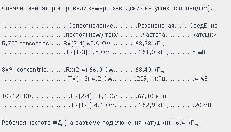

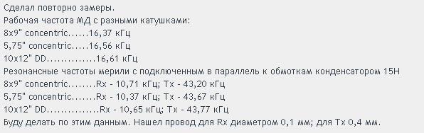

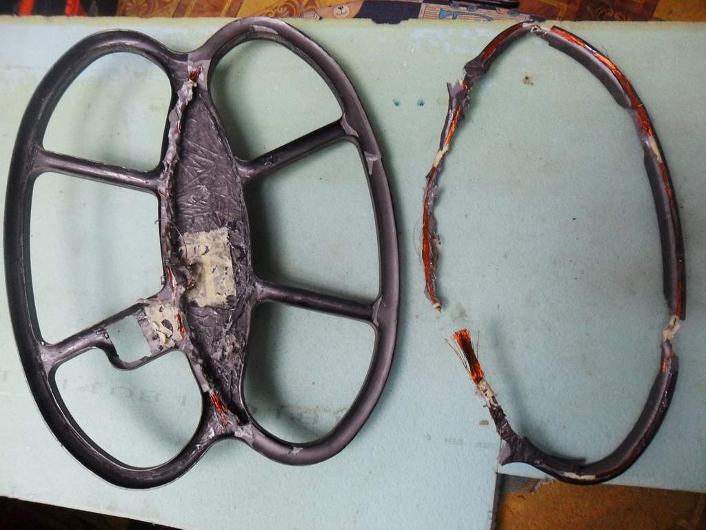

                Not sure if any of this will help:
                RX 16.56m 67.4 ohm
                TX 1.03m 045ohm
                Tejon-SEF 10/12
                25,4cm x 30,48cm
                Rx - 160 turns , 0,20mm.
                Tx - 40 turns , 0,38mm.

                  Thanks Ivconic, your always helpfull! I am building a 10 inch DD coil and I am trying to get the best phase on the scope for best discrimination.
