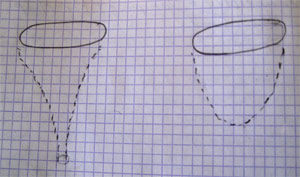

                          What shape does the detecting field sensitivity have compared with the drawing below?
                          Tinkerer

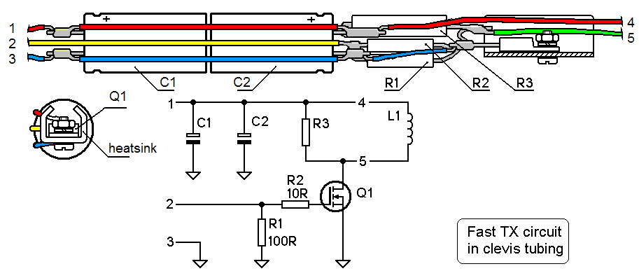

                              Kevco, basket coil and flat spiral coil make better pinpointing if internal diameter is enough small.
                              If you wish to sample below 10us, you must avoid cable capacitance. As bbsailor described in posting #4, this is the largest capacitance in the circuit. For this purpose, theTX circuit should be placed near to search coil.
                              Below is shown a design where TX circuit is placed inside plastic clevis tubing.
