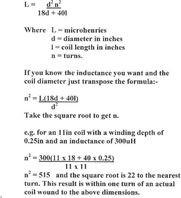

        It seems to me all the calculators ask for variables I don't yet know. I only know the desired coil outside diameter of 24 or 25", possibly the inductance (300-350), and that's pretty much it, the gauge wire I guess could be 18 to 20+ AWG But I don't know the inside circumference, the number of turns, the width of the coil, the coil inside diameter, or the coil length, which seem to be the main variables these calculators ask for. Therefore, I can't seem to use the calculators. I did some math using a forumula:
        no.of turns of coil (squared)=[Microhenries(18xdiameter)+40(coil length)]/
        diameter squared
        I assumed coil length would be 0.25"?
        so, TOC2=300(18(25) + 40(0.25)/25x25
        TOC2=135,010/625
        So i need approximately 14.7 turns of the coil
        I just wanted to see if I came up with the same thing as the suggested
        (25" coil is 18 turns of 20.5 gauge wire). So now I'm confused again and would appreciate any advice. I'll try to make this my last question as they are probably becoming a nuisance.

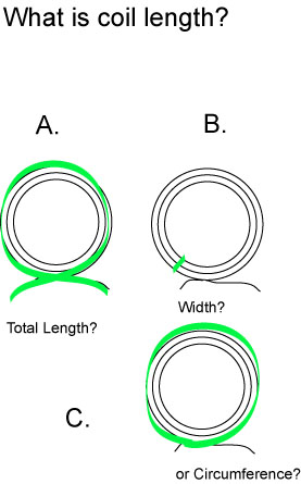

          I'm still not sure I follow you so I prepared this image and all one has to do is respond A., B., or C. or none of the above to answer my question about coil length. Thanks. Sorry if I seem dense. I imagine it would have to be B. if it can be as small as .25", either that or it is something else I don't have shown here.
          Note-I got the formula from the previous post at:
          https://www.geotech1.com/thunting/te...-L_formula.jpg
          RCB
            Rex, If you look at the data you see it says 3.21 levels of 7.5 turns. Those 7.5 turns or .112" is the coil length (you're looking edge on). I use .25 to start my calculation but the program usually changes that.

                Normally when working with formula's designed to calculate the inductance of the coil, such formulas are designed for single layer coils wound in an inductor fashion where they may a length dependent upon the number of turns.
                Now, with the website I use, the calculations are such that the length is asked for and I simply use .22 inch or .25 inch depending upon the wire used. These numbers are basically the thickness of the windings which, will be either the length or the width of the winding itself.

                      the coli's length is the width.
                      in your picture is the 2nd case. I have the same question last month but after some analisis i determined what does means COIL LENGTH.
                      In order to obtein the real coil length (total wire length) you need to calculate a liner integral that depends of the diameter variation (initial radio and numbers of turns) and the wire diameter, with this value you can obtein aproximate DC coil impedance.
