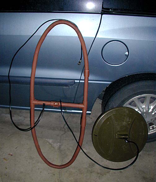

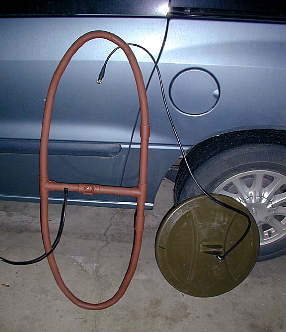

    Coil completed
    Well, I thought I would post the results of attempting to fabricate a coil for my Minelab gp3000. The first coil I made was a 12" coil and does not seem to work properly. But my second coil does which measures 42" x 15". It is next to an 18” coil and a car tire for comparison. You can barely swing it on the end of a long shaft without bumping your feet. I’m pleased to announce that it did not fry my detector and it does give a response to metal, although I don’t think it will be giving Nuggetfinder a run for their money any time soon. It probably won’t work that great but at least it was sort of fun to make. I haven’t yet tested it in the field where there is no interference, so I don’t fully know how poorly or well it will actually function.
