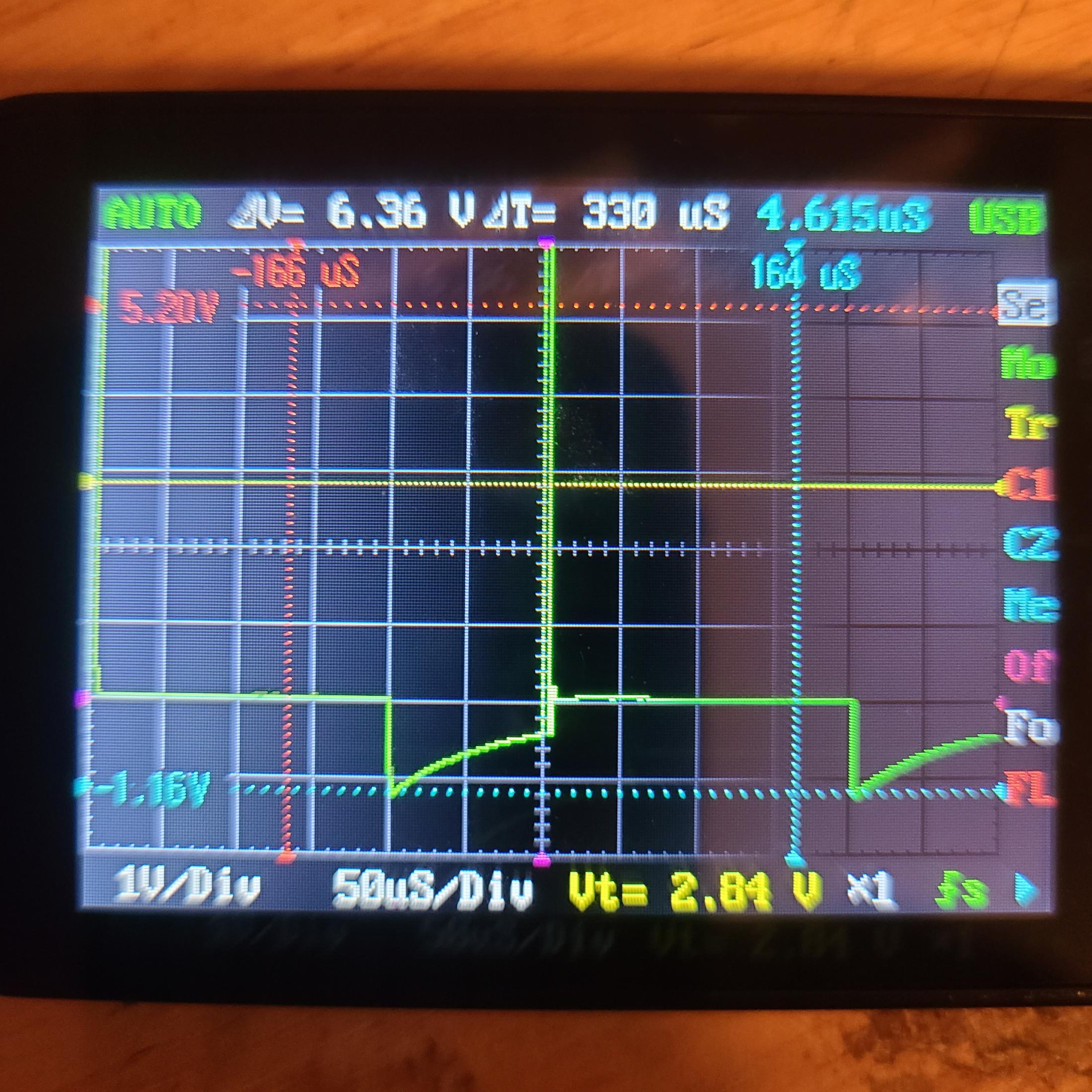

                      I was confounded why my Tektronix analog scope wasn't showing the waveform I see in videos about damping (10x probe).
                      While I was away from the forum, I was doing some more reading and testing.
                      I remembered I have a little pocket digital scope I bought about 5 years ago so I tried it on the coil (10x probe).
                      First pic is the waveform without any damping. I'm not sure why it doesn't show the ringing that my Tektronix scope does.

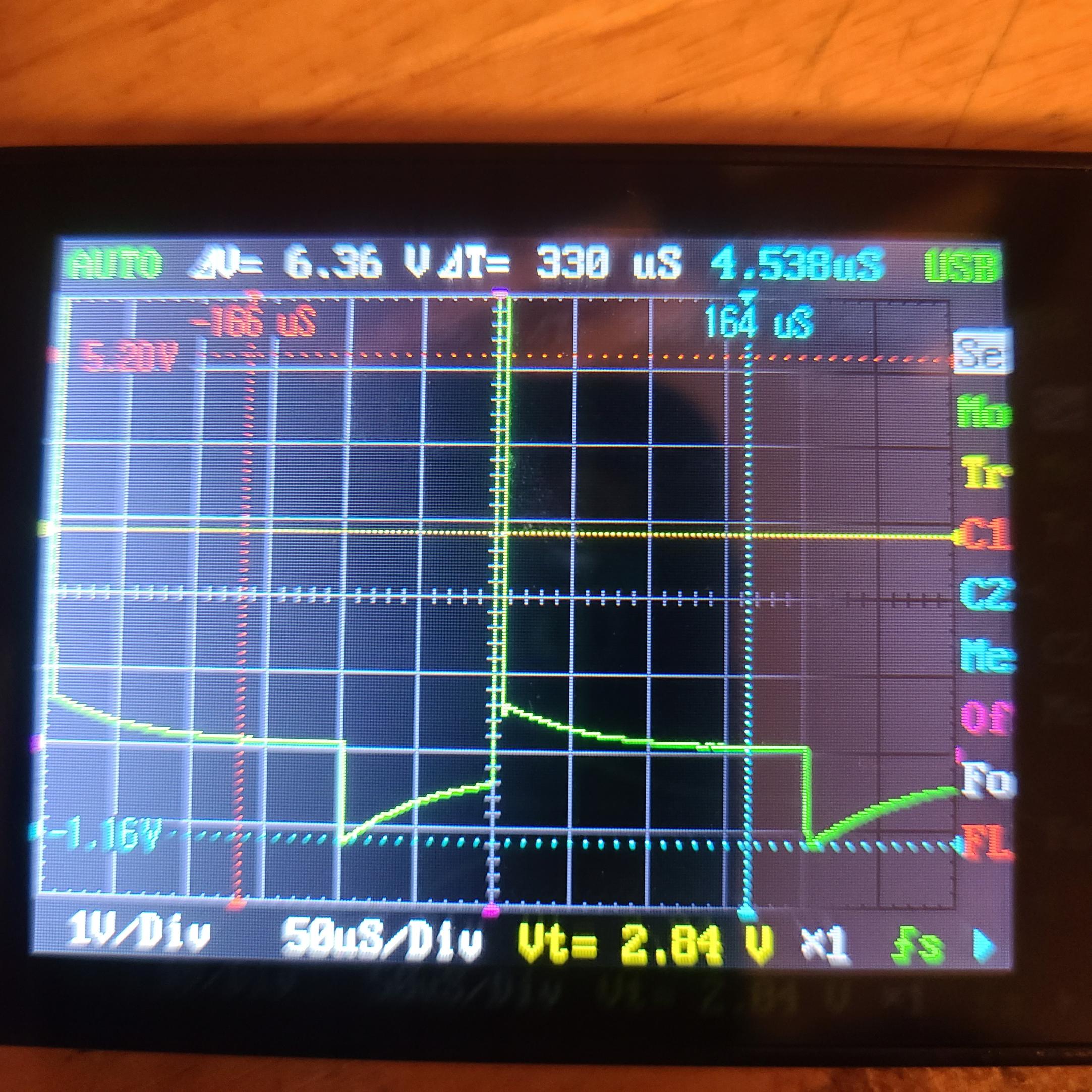

                      Second is the waveform with damping adjusted so the waveform is flat with the grid line. That is what we want to see right?
                      Over damp and the waveform dips under the grid line then comes back up.
                      If I add the shield and measure with the digital scope, the variable damping resistor has no effect on the waveform. (Scratching my head over that one.)
                      A 600 Ohm resistance gives me the waveform you see in pic #2. The coil with shield works nicely down to 10us on the TDI.
                      I am going to try adding a little more resistance to the damping (slightly under damped per your recommendation Carl) and see how the coil performs.
                      However I am encouraged with the improvement I see in the coil performance.
