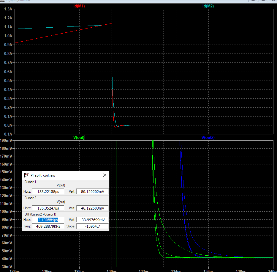

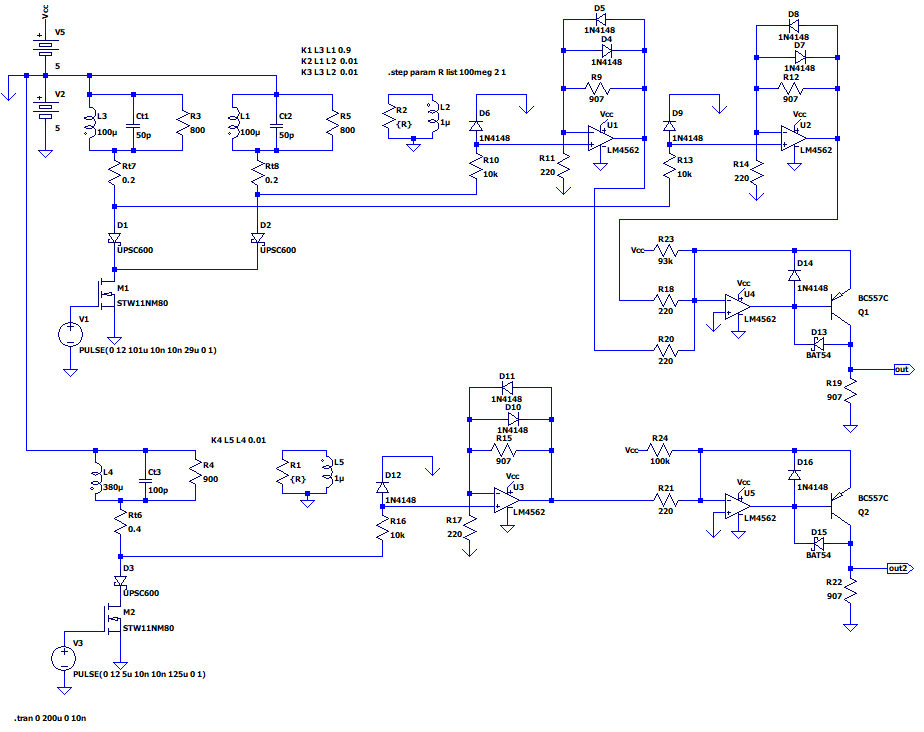

    A mono coil can be spit in two equal parts, driven separately and it's faster than a single coil.
    This is a conjecture based on my understanding and tested in LT-Spice, not yet on the bench.
    One 380uH coil is equivalent to two 100uH coils connected in series (coupling coefficient of 0.9. Used this calculator).
    If we drive the two 100uH separately with the same total current as the 380uH coil and add the received signals, we can sample earlier without loss of gain.
    In the simulation the damping resistors have been adjusted manually. The upper half of the circuit is the split driver followed by two separate preamplifiers whose outputs are passed to an adder/level-shifter to refer the output to ground. The lower half is the mono coil. I assumed the coupling between the target and each split coil is the same as the coupling between the target and the mono coil.
    The improvement is a bit over 2us.
    LT-Spice file attached below.

    I would expect the coupling to be better than 0.9. What happens if you increase the coupling to 0.95? 0.99?
      Pretty much the same thing. You can try it in the attached LT-Spice file. Remember to adjust L4 to the new coefficient. It should be 400uH for a coefficient of 1.
      An added bonus is that the peak transient voltage is less than half.

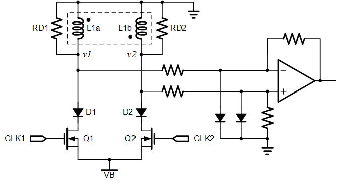

        I've never that particular technique, but did something similar:
        This uses the center-tapped coil in a bipolar pulsing scheme. Because each half-coil is 1/4 the total inductance you get a higher current and faster flyback while getting the entire L on the RX side.
          What's old is new again ... https://www.geotech1.com/forums/foru...091#post104091
              Click image for larger version  Name:	BipolarPI.png Views:	0 Size:	21.3 KB ID:	408553
              Thank you and moodz for the old posts. They confirn thatl my conjecture is true.
              The center-tapped technique works the same but it's limited to N = 2 splits. My variation allows splitting the coil further. For example, for N = 3 in the circuit attached L = 44uH and the timing gain would be above 3us.

                  I'm thinking of placing the split coils in an IB configuration, coupling as low as feasable. The simulation allows even earlier sampling but I guess the resulting field be greatly reduced, also the coupling with the target. Could be useful for small gold.
