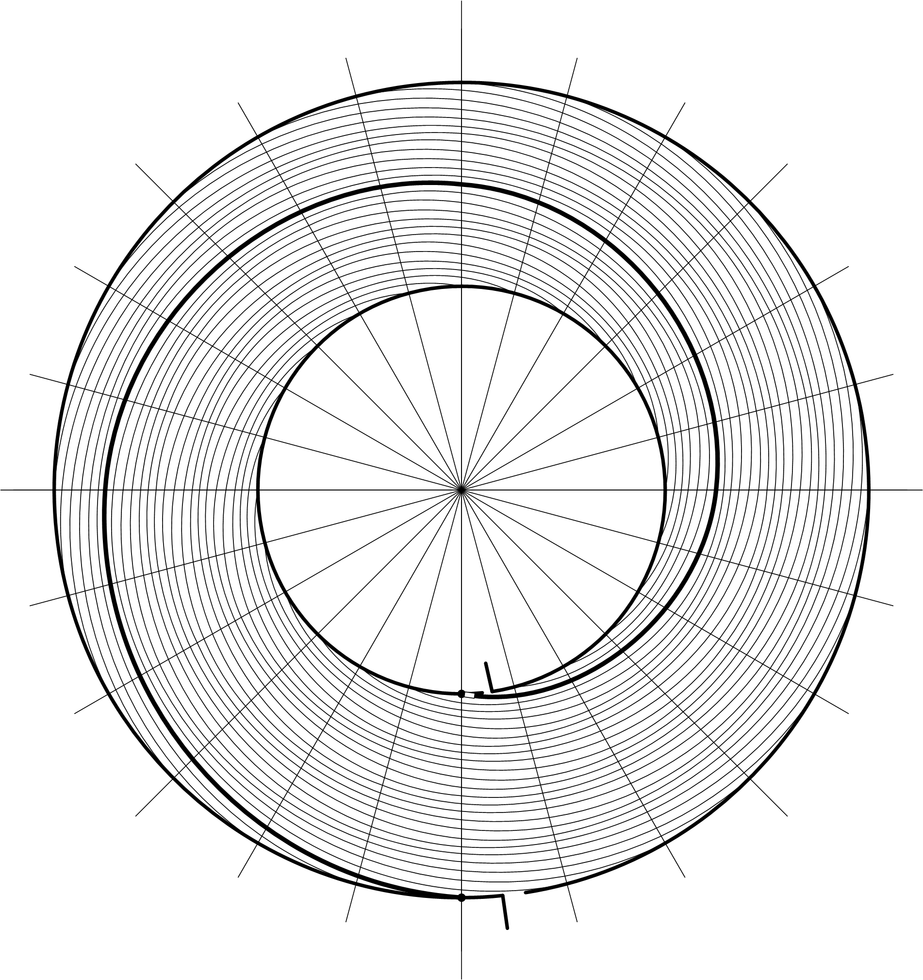

    Your drawing ignited my memory. Back at White's I was looking at various experimental coils for PI: scramble, spiral, solenoidal, and some others. I think they were all 24 turns and 10"/25cm mean diameter. The one that your drawing reminds me of is something I called a "vortex" coil. I managed to find a Visio drawing I did for it but I cannot find any photos or measurements.

    There is an inner ring of heavy copper wire and also an outer ring. Then there are 24 wires that make a 1-turn spiral from the inner ring to the outer ring (the first one is highlighted as a heavy line). A cable is connected to the inner & outer rings where you see a 90° spur. Since there are 24 parallel turns (instead of 24 series turns) the currents need to be both balanced and limited, so I placed an 0805 chip resistor just where each spiral connects to the inner ring. I don't remember what value I used, maybe 10Ω.
    Performance sucked. It had little sensitivity compare to a normal coil. On the RX side it is obvious: the parallel induced voltages on each 1-turn coil does not sum up to anything stronger, so on the RX side it is always equivalent to a 1-turn coil. On the TX side there are 24 1-turn coils and even if each one has the same current as a normal 24-turn coil it is not clear that you get the same TX field strength. There are 2 ways to test for this: use a magnetic field probe to measure the TX field directly, or add a normal 24T RX coil to get back the RX-side sensitivity. I did not try this so I don't know the answer. The coil was exceptionally hard to build so I doubt I will try it again.
    Moral of the story: don't get too wrapped up in simulations. Build it and see what it does.

                            To achieve tge same ampere turns of an equicalent regular spiral coil you would need 24 times as much current. I don't know if your driver was adjusted to that crazy requirement.
                              I'm sure that is also correct. You get hit both ways, on the TX side and on the RX side.
