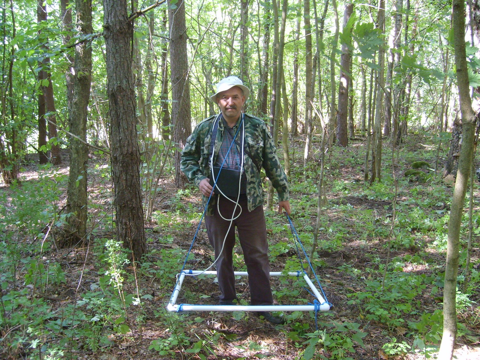

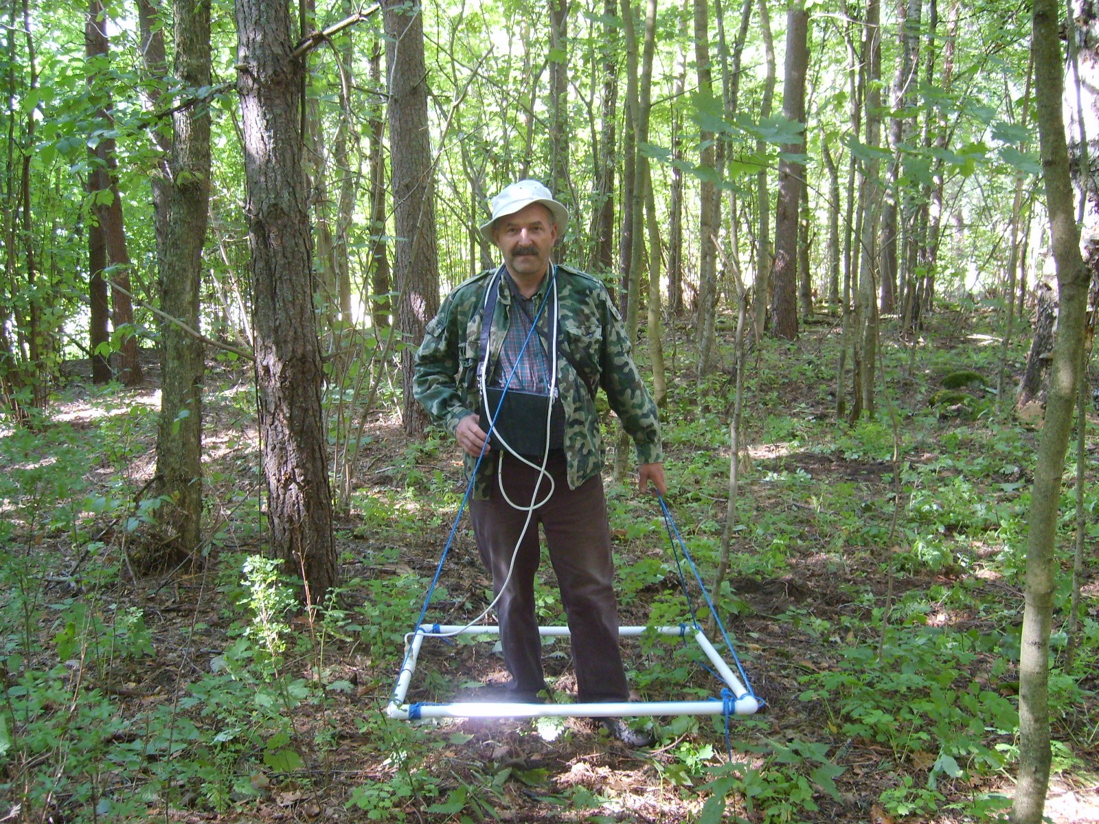

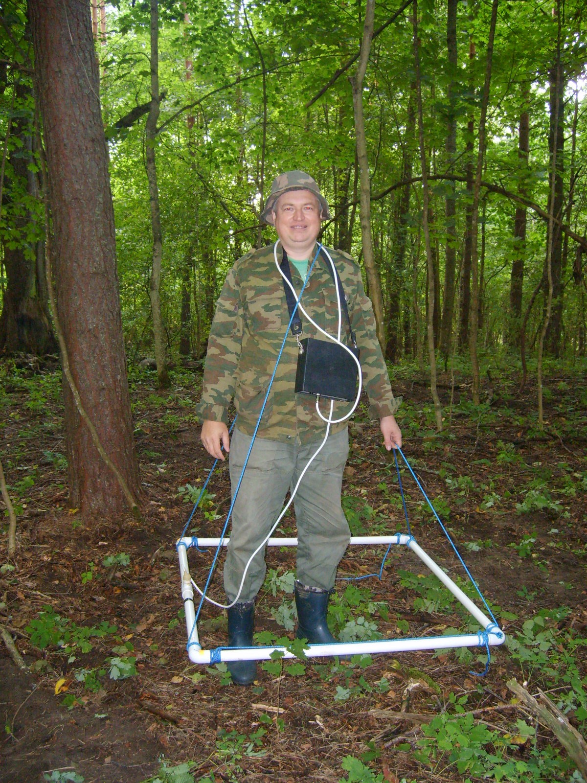

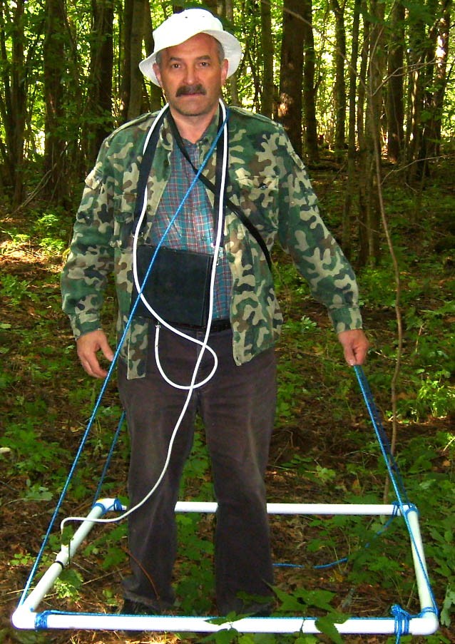

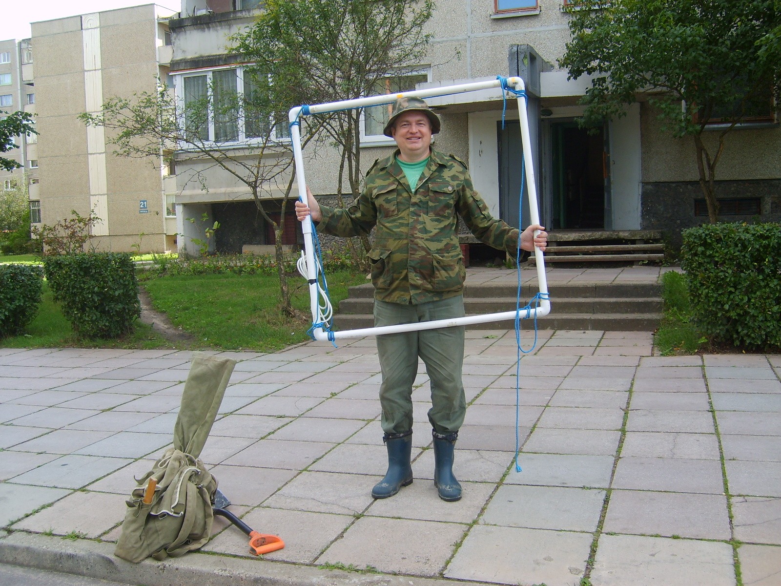

    hi master.. hope you are always healthy. I want to make a delta sniffer coil with an induction of 300-320 uH and a coil diameter of 1x1 meter. I saw on YouTube this type of coil uses a cable. what cable should I use and how many pairs of cables. Thank You

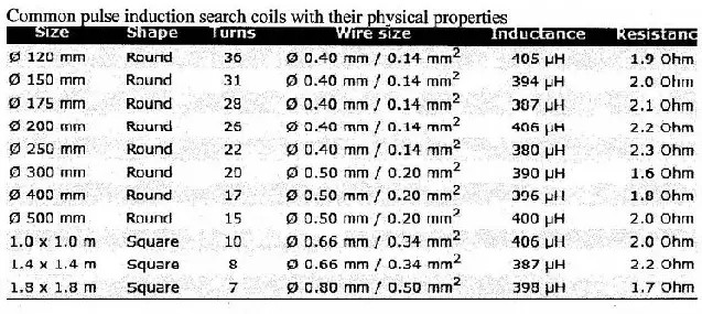

          use or ftp cable but the best for me it is emaye coil cable for snifer or delta p. you need 7 or 8 for deep searching but please how many ohms is my question for 45x45cm or 50x50 cm cyrcle big coils for these 2 how many ohms we must make it? thankou
            I would not worry too much about the resistance. Try to use 18-20 awg (1.0 - 0.8 mm) wire and you will probably end up with 1-2 ohms. That should work.
              if that can help

                yes, this is the photo of the coil that I want to make

                  ohms ?how many you say ?for the 1x1?
                  2ohm, coil 24cm. Mybe same.
