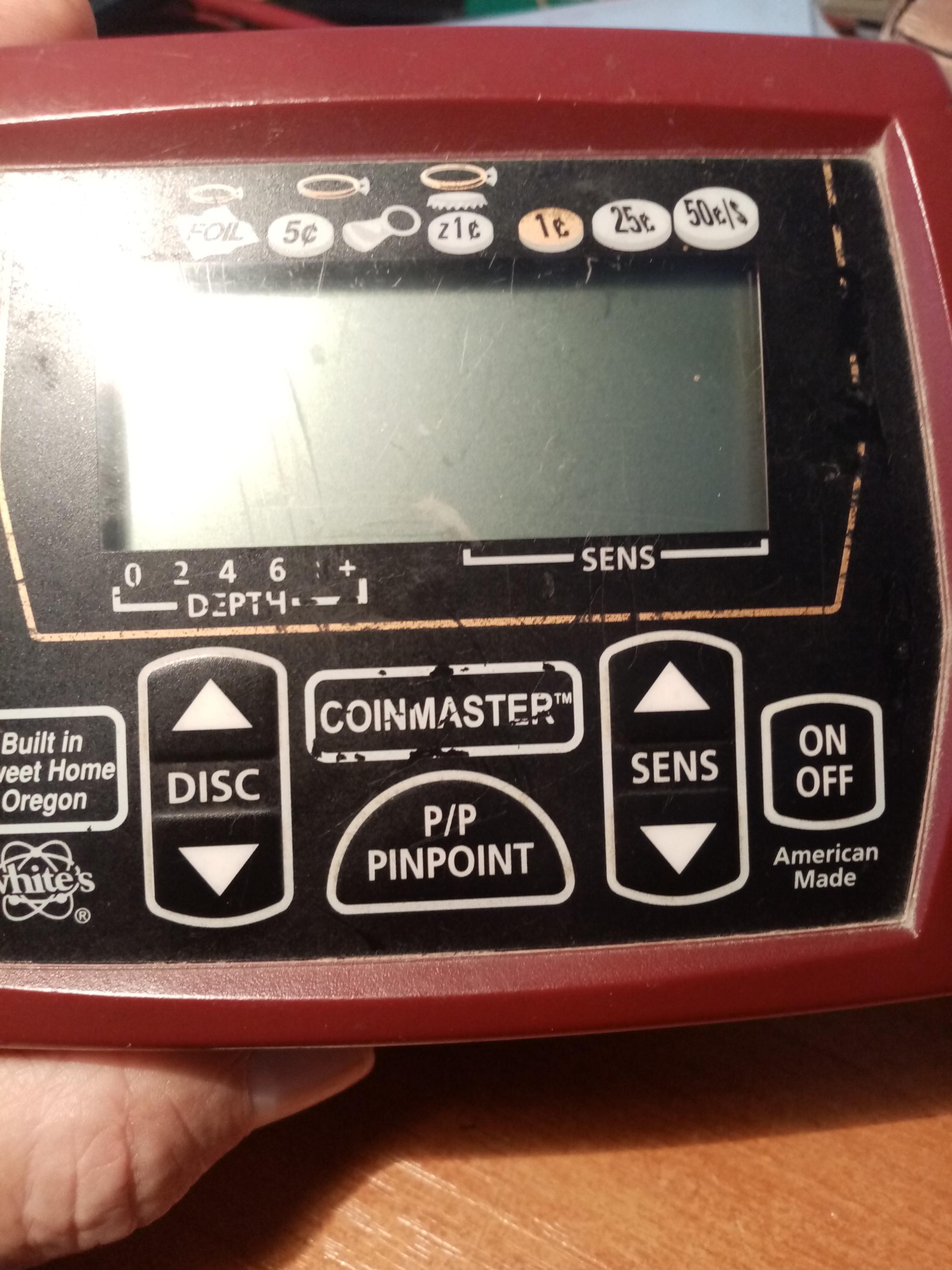

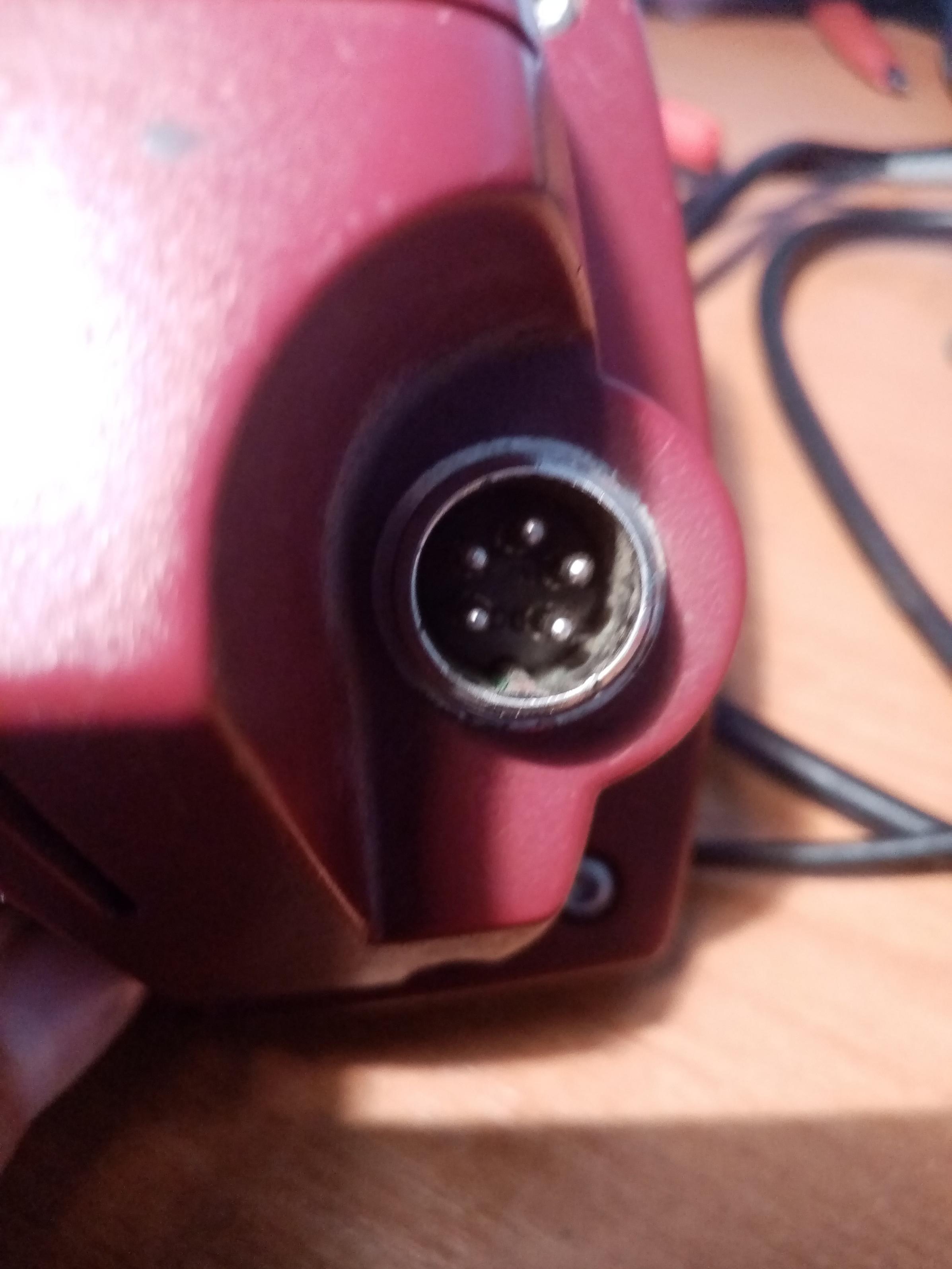

    Does anyone know the pinout for the whites coin master coil or the layout on the RX and TX devices​ ?Click image for larger version  Name:	IMG_20230403_150629.jpg Views:	0 Size:	371.4 KB ID:	411118

      I always have to be alone, here's the schedule​!
        Pin 1 -- RX-gnd
        ​Pin 2 -- RX+
        Pin 3 -- Shield
        Pin 4 -- TX-out
        ​Pin 5 -- TX-VCC

              The 5 pin connections are the same as above. The cable is dual coax, like s-video
