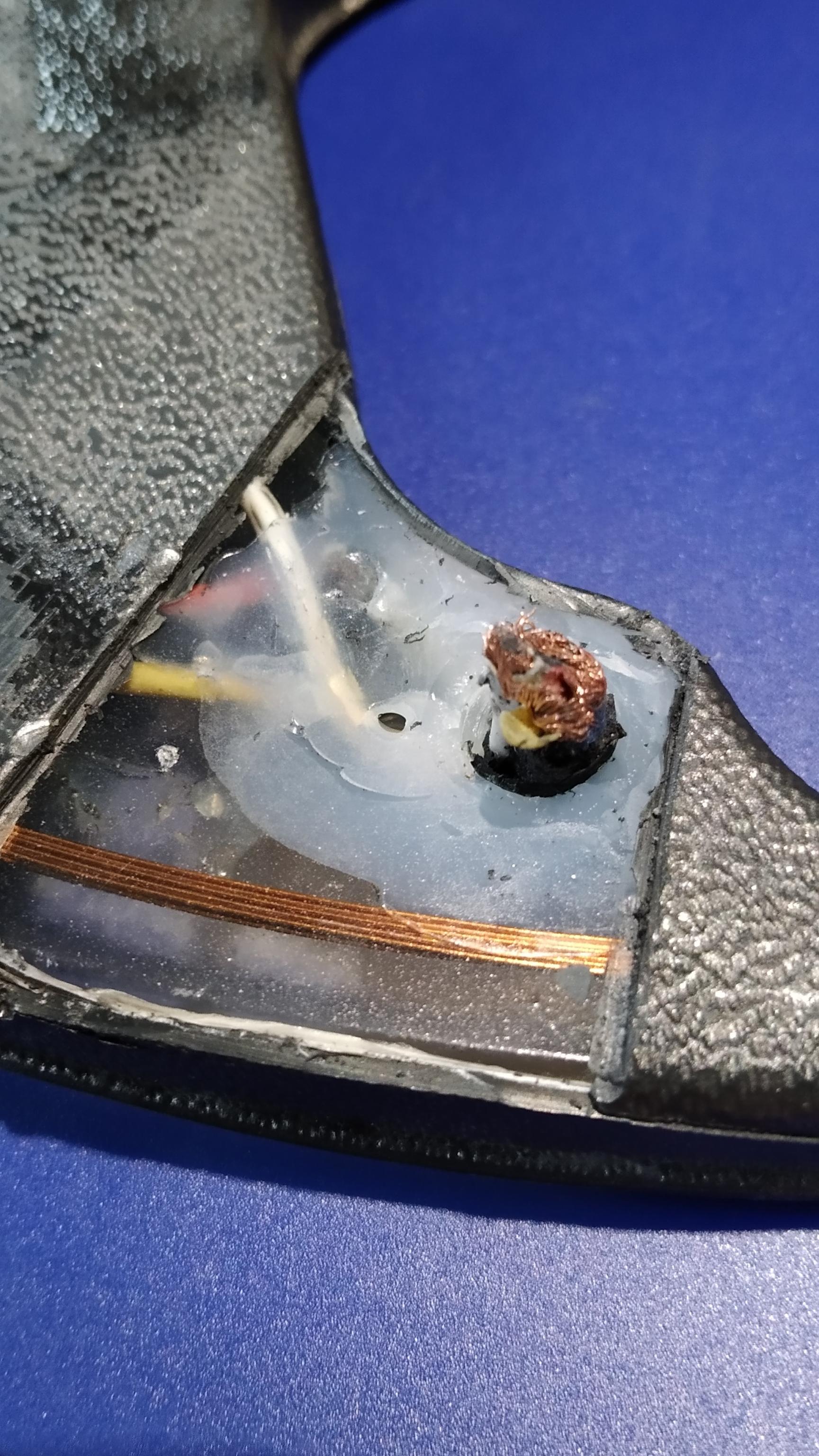

            Repairing the rotting cable of the Sovereign, which has also failed at the pigtail. The cable is glued together as it passes through the pigtail making seperation of the four wires virtually impossible. In the coil itself going in via the top looks like the best splicing option as the wires seperate and are held in glue which is soft compared to the resin.
            Click image for larger version  Name:	IMG_20250911_092334.jpg Views:	0 Size:	617.2 KB ID:	440701

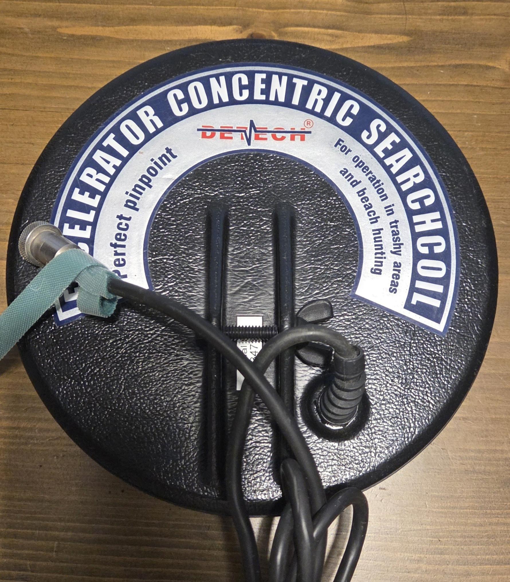

                          Yes, there were several concentric coils for Sovereign.
                          Detech "Excelerator" and HotHead "The Ferret" made some, but they're nowhere to be found.
                          There is a video on Detech's but I can't find it anymore.​

                                I have been trying to trade my concentric coil, Detech for a Tornado coil. My coil was never submerged in water, but it felt like it was not water proof. Just the other day, I was curios about the coil cover. I didn't know if it was an actual coil cover or not. It was hard to remove, but when I did, it was in fact a coil cover. It pulled away the bottom half of the coil clam shell. I was messing with it, and was able to completely undo the glue that held the coil together. I wanted to completely separate the halves, but it was internally glued with what looks like double sided tape. I stopped, and placed Kapton tape around the seam. The coil still works. I'm still trying to trade it plus a sovereing meter for a Tornado coil or a Sunray coil to put on my Excal.
