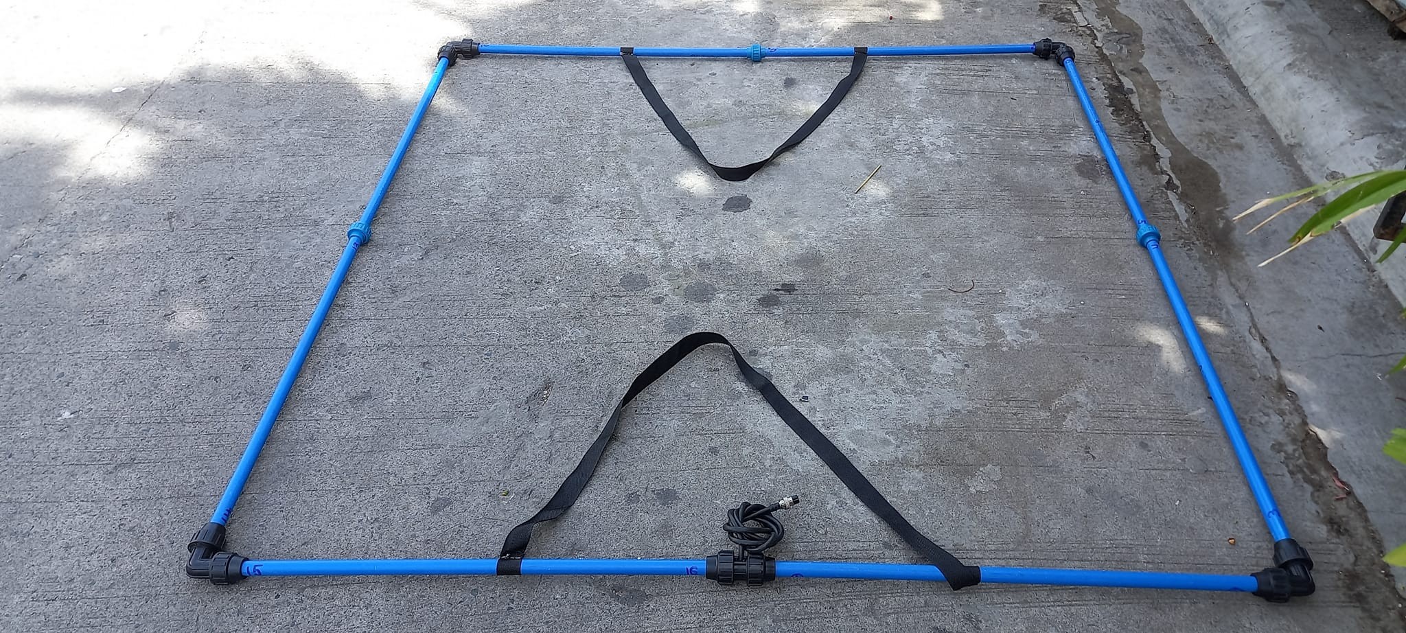

    The largest one in the famous table for PI coils is 1.8 m with seven turns. I wonder if 2.5 with 5 turns would work. Perhaps, it's too large and impractical. But I don't care. I want the extra depth. The cache we're looking for usually here are way too deep. We should be working with gpr but we can't afford one. Has anyone tried such large coil before? What does science say about such big frames?

        a 2x2 meter coil is no problem see picture. A 2,5x2,5 or 3x3 meter coil should be also no problem. You only need a stable frame works.

            Thanks for the tip. Now that you mentioned it, it's gonna be a bit challenging for such large frame. I wonder if pvc tubes would cut it.

                    I can't find a reason why it wouldn't work, all you need is 5 turns with 0.85mm wire. You can wrap the coil with tape so it can be flexible and you can construct the frame with PVC tubes and assemble it on the spot.

                              doing more much frame you lose out the depth to small targets. you can NOT deceive physics rules.
