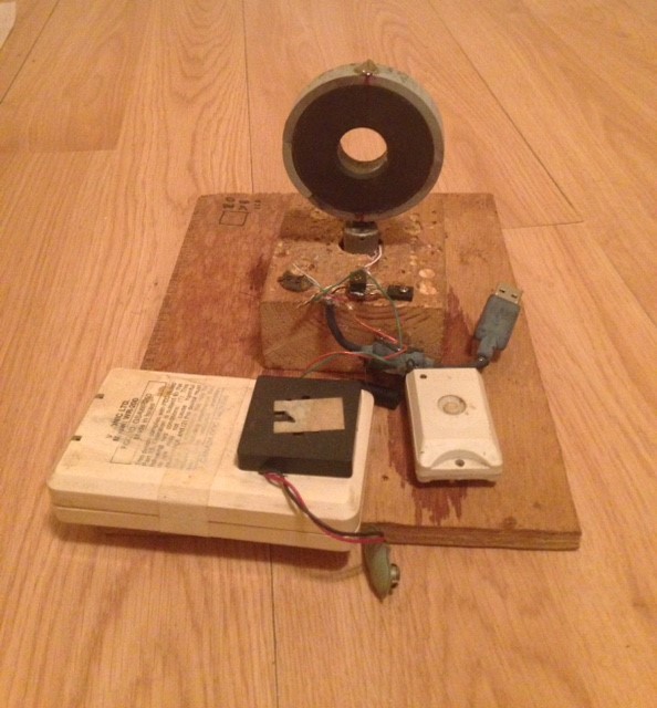

                        Magnetometers are more effective than metal detectors for iron targets. Years ago I built magnetometer which was able detect this rotating magnet ( remote controlled ) from distance 11 m.
                        Click image for larger version  Name:	mag.jpg Views:	0 Size:	85.1 KB ID:	416095​
                          Magnetometers are more effective than metal detectors for iron targets. Years ago I built magnetometer which was able detect this rotating magnet ( remote controlled ) from distance 11 m.​
                          That's impressive. But is less effective for other metals?
