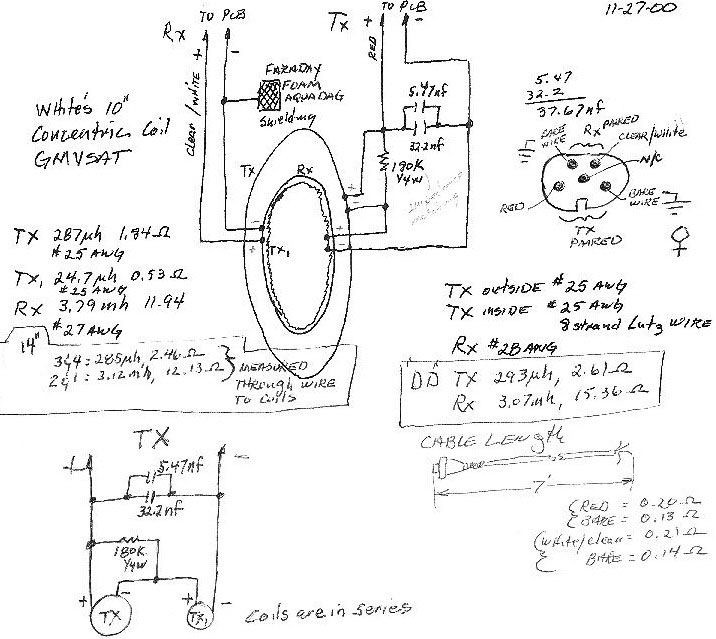

    I'm going to buy a Whaits gold master metal detector coil. parameters are needed. to check whether it works or not. there is no metal detector. I only have a multimeter.
    Some info
      From that thread you can find that
      RX:
      L = 3.1mH
      R = 15.5Ω
      TX:
      L = 280uH (Litz)​
      R = 2.6Ω
      If you only have a multimeter then R is all you can check. Should be good enough to see if the coil is OK.
      BTW, I assume you mean a later VLF Goldmaster and not the early blue-box TR type.

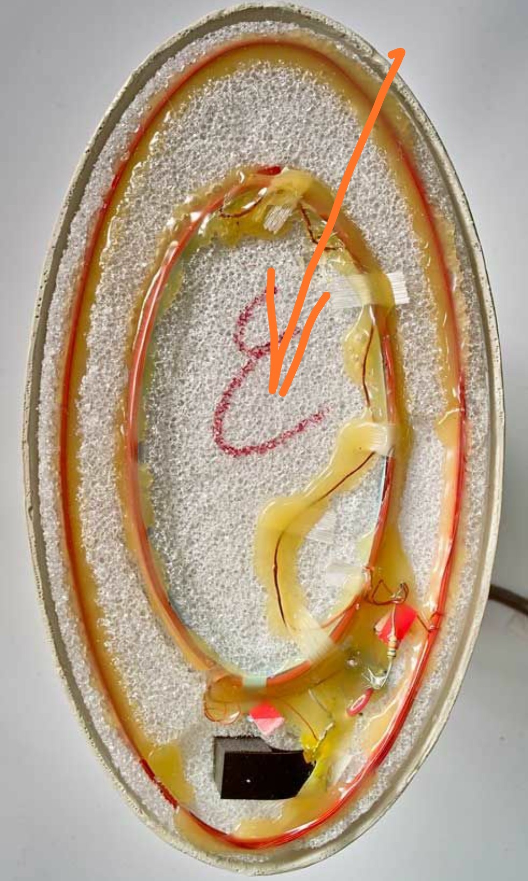

          And what kind of material is white and porous? what is its linear expansion when heated or cooled? Why is epoxy resin not completely applied?

                      This is not a fortune. stalker ib is a different device. The metal detector coil arrived. opened it. Converted the TX from parallel to series resonance. everything works) on the table.

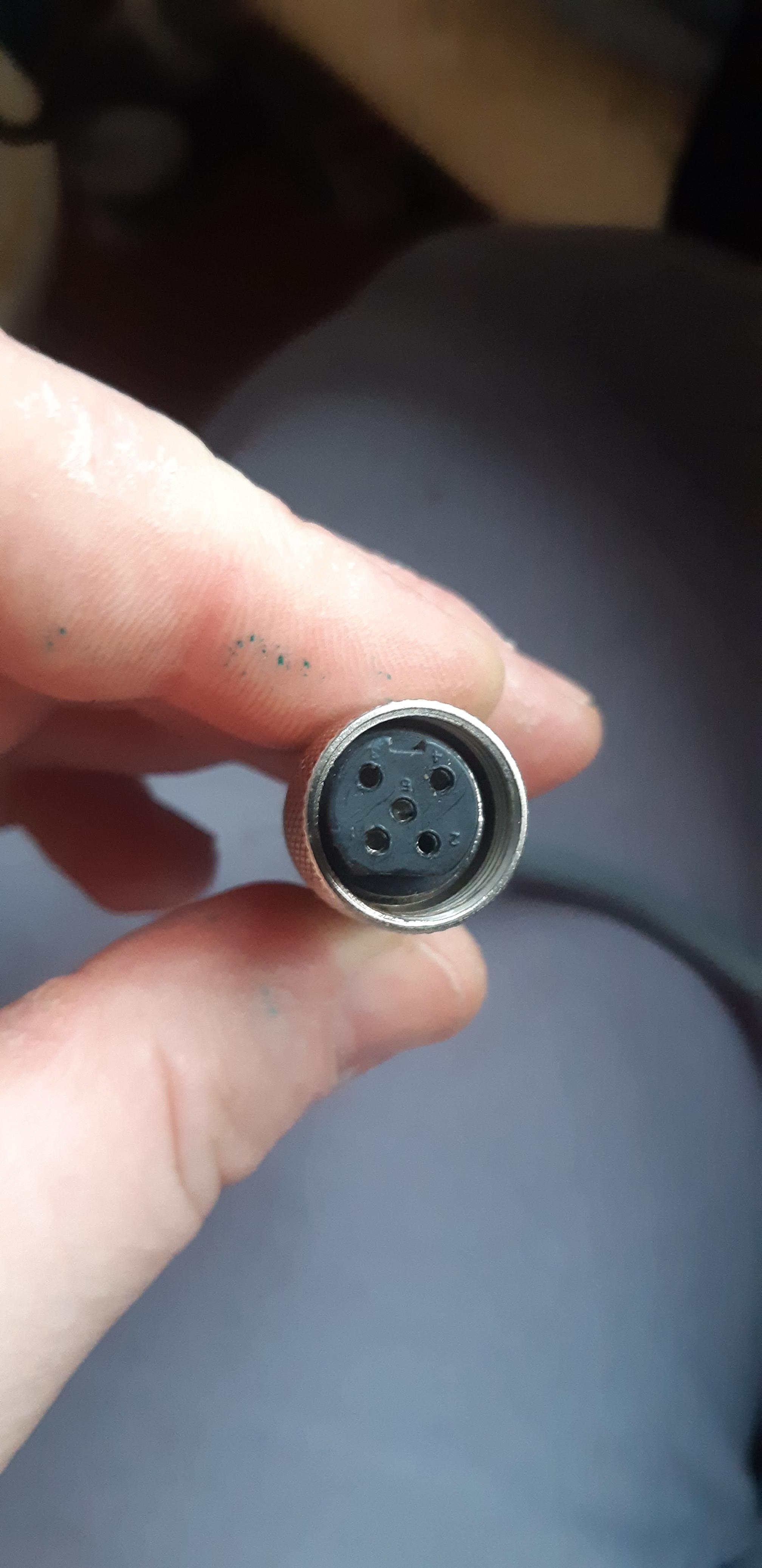

                        Can anyone tell me the name of the connector? I can not find.
                          such
                            Switchcraft Slim-Line series, specifically this is an SL405FX.
                              Our SL105M connector costs 33$ and sl405fx 28$. Why are American connectors so expensive? Chinese 5 pin cost 50 cents including delivery.
