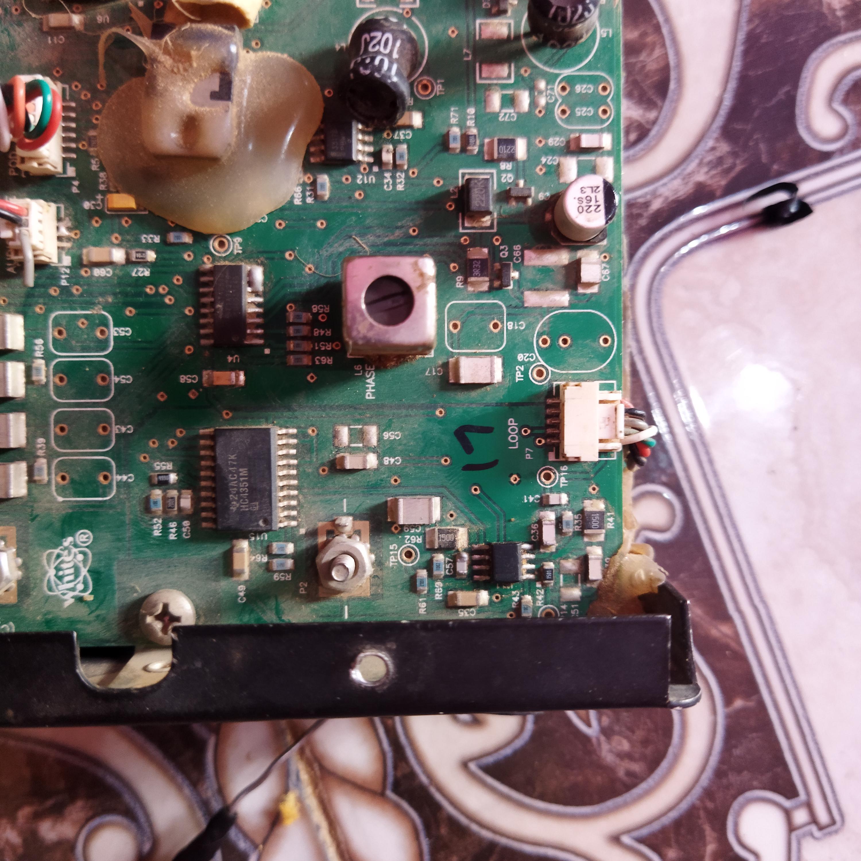

Need pinout coil in pcb whites coil gmt gold master
  • Need pinout coil in pcb whites coil gmt gold master
    Hello to all gmt gold master wire connectorsClick image for larger version

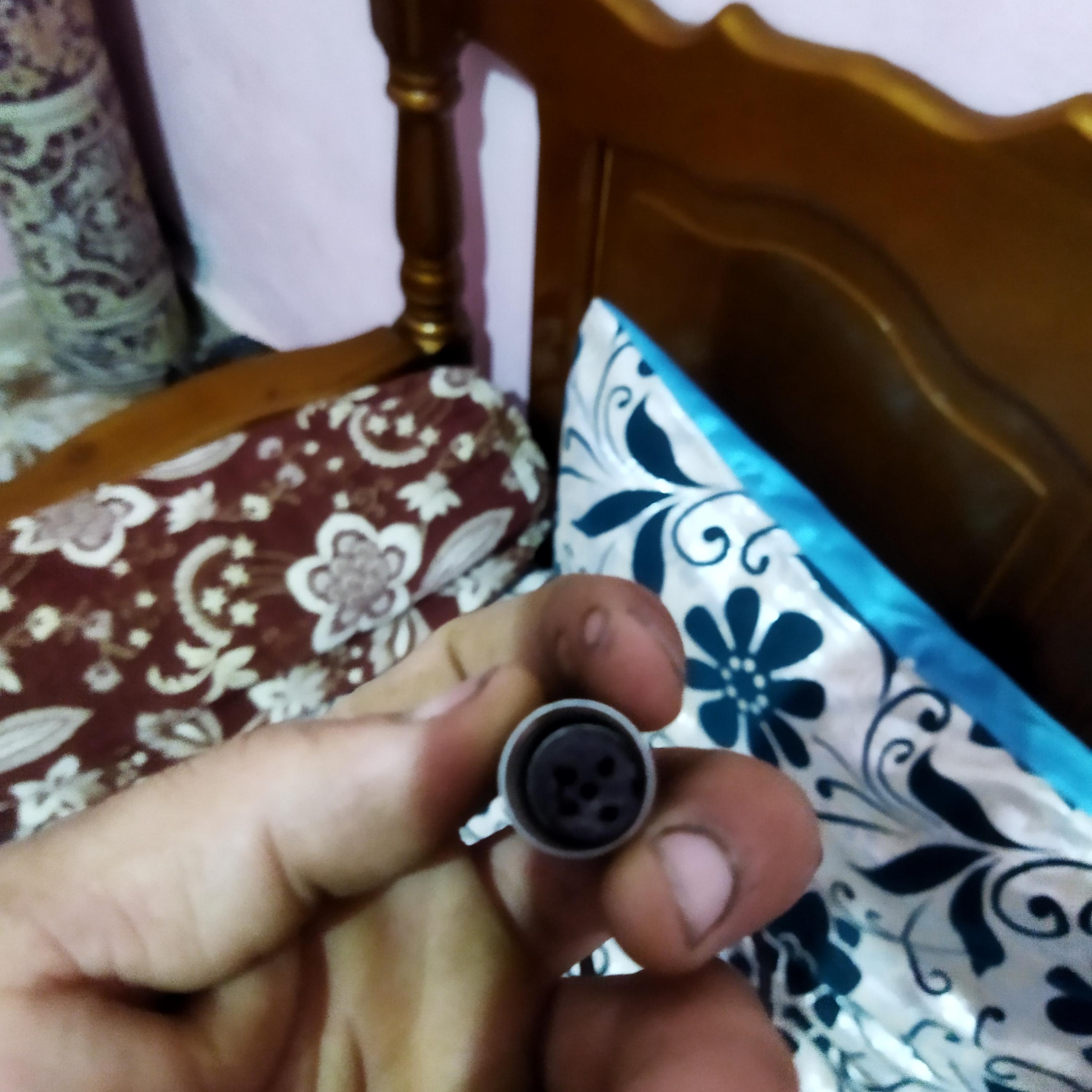

    Because damage or my coil ans plug connectors.

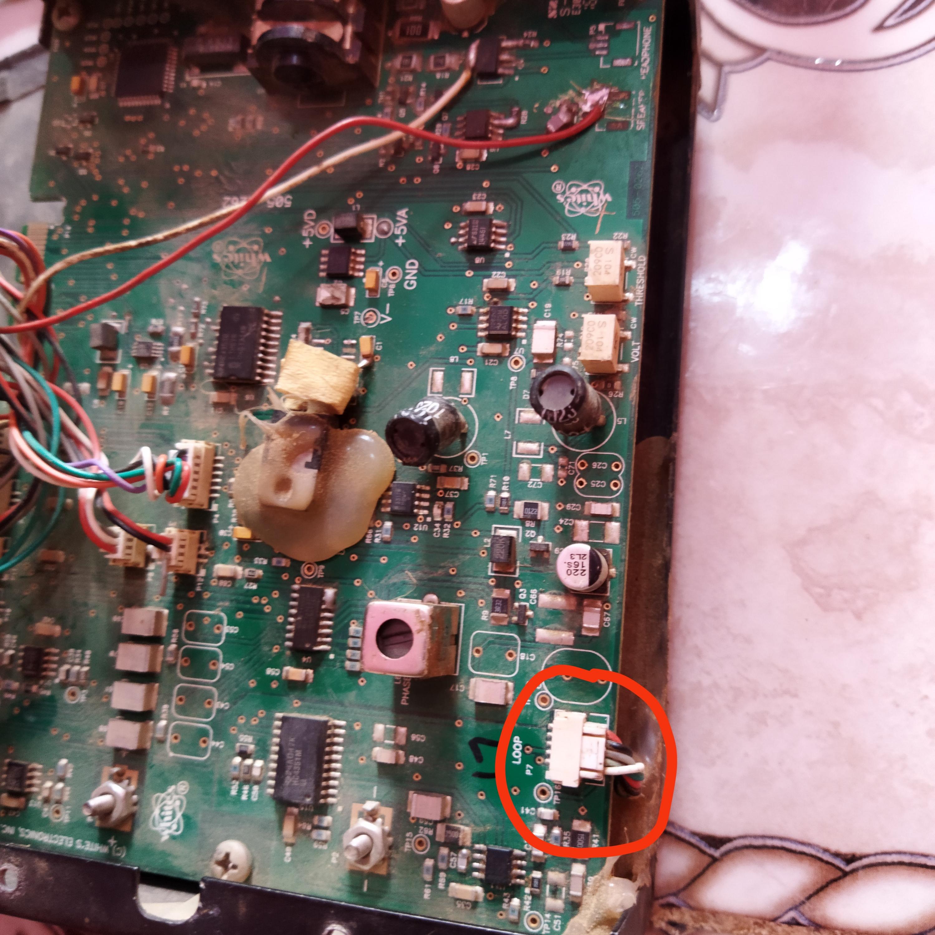

    Annoter pic

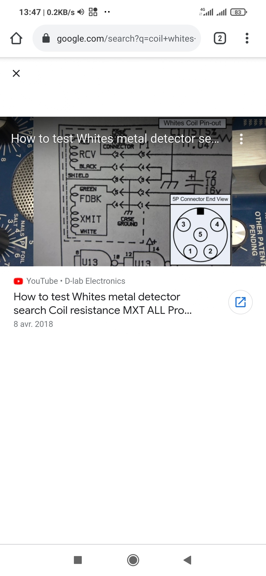

      Pin1: TX+
      Pin2: TX gnd
      Pin3: Case gnd
      Pin4: RX gnd
      Pin5: RX+
      Pins 3 & 4 are tied on the PCB.

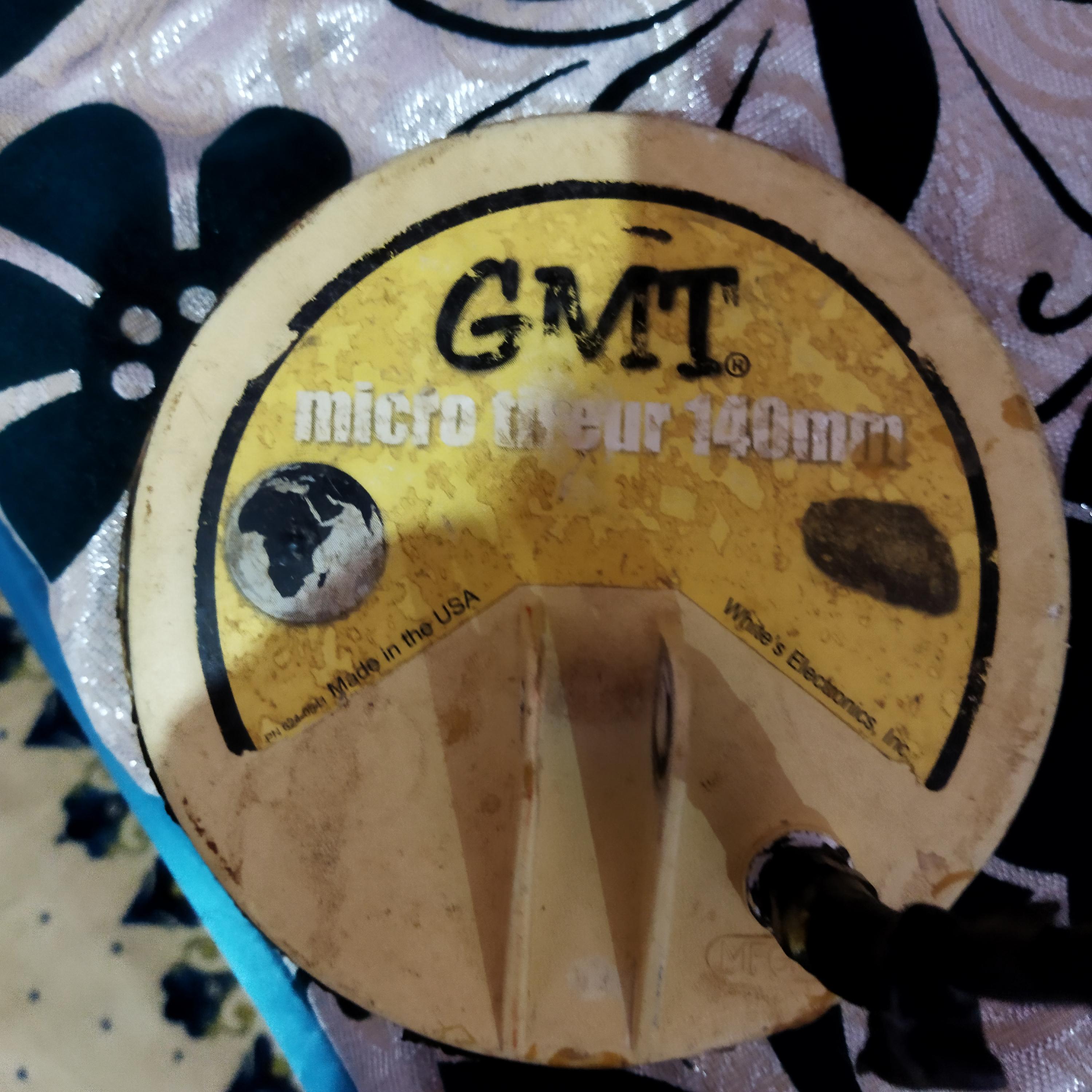

            CoilClick image for larger version
              When i test with multim?tre i found :
              Pin 1 Pin 2 = 15.5 ohm
              Pin 3?pin 4 = 2.6 ohm
              Pin 5 not connect any were .

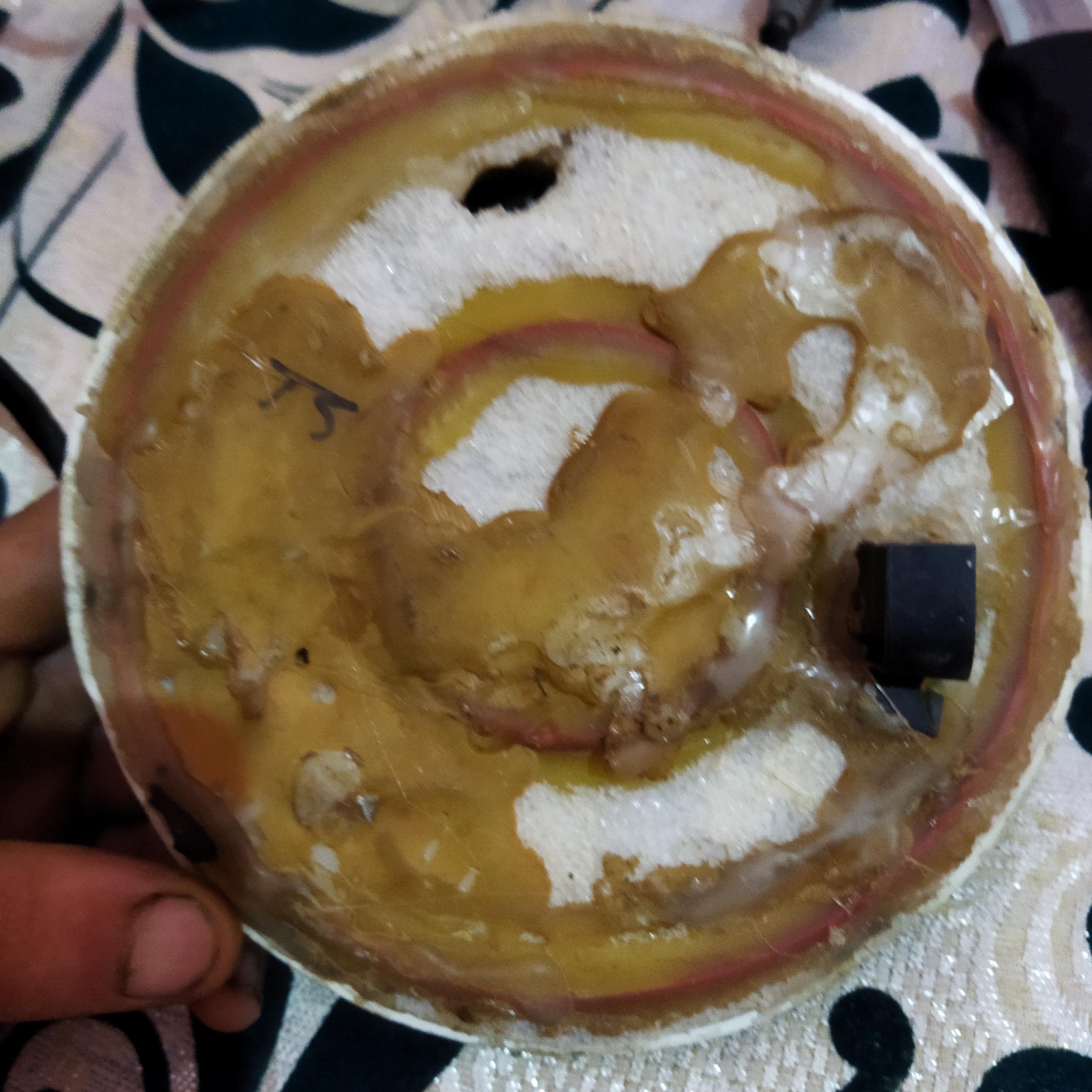

                coil
                  That's a 5.3" concentric. Pins 1/2 is RX, pins 3/4 is TX.
