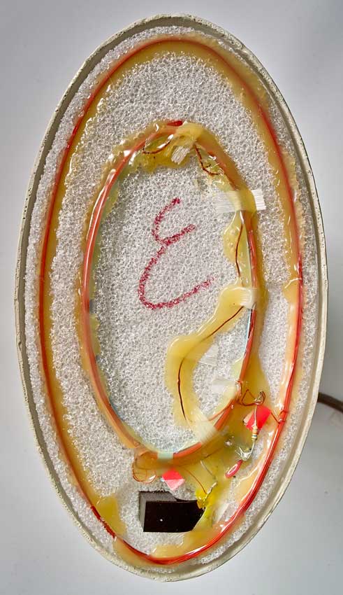

Need pinout coil in pcb whites coil gmt gold master

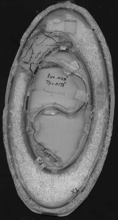

use thermo fan air desolder gun for the whites yellow glue deleting. you will find some components... there might be 'capacitors and a resistor' inside invisible for you.

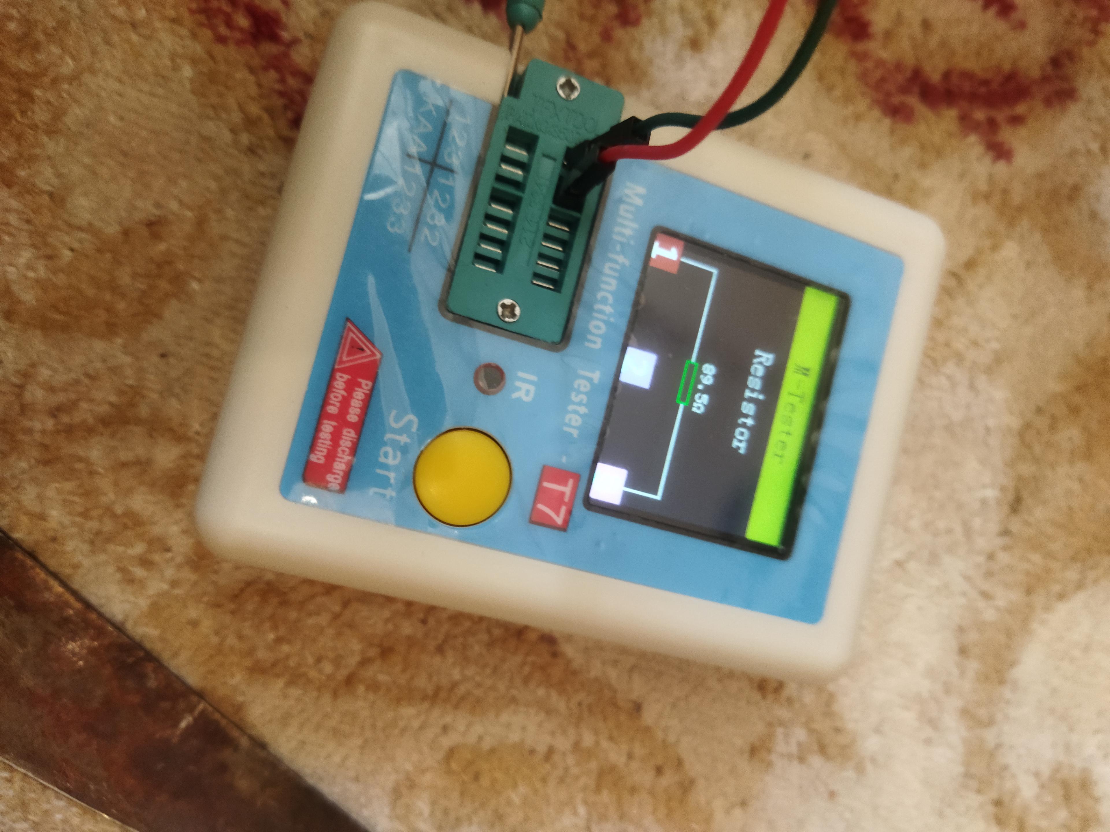

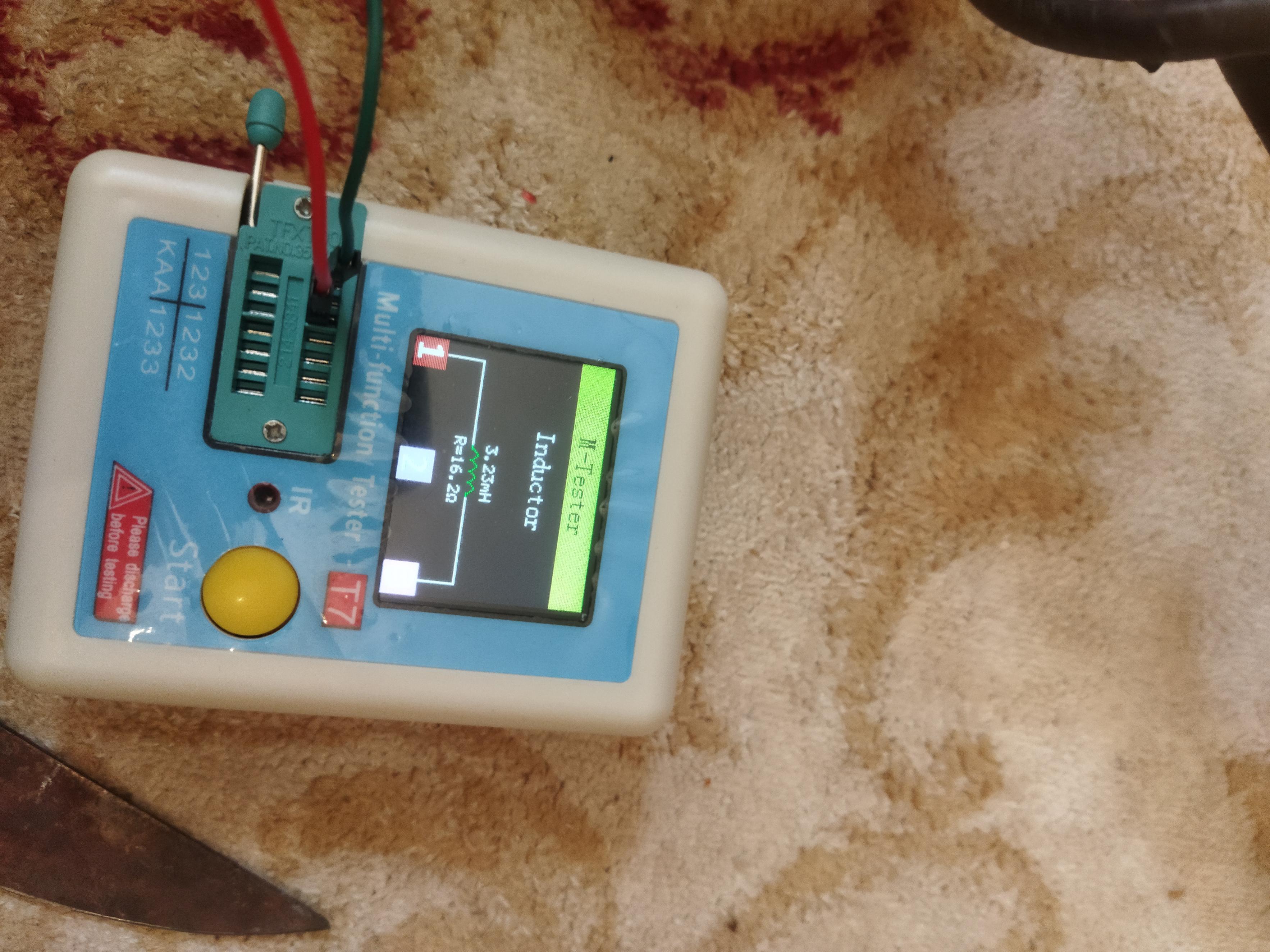

Thanks kt15 my be later . I will try that later . I want to make a large coil for this unit but what about components inside the coil ? The same or not ?Originally posted by kt315 View Postuse thermo fan air desolder gun for the whites yellow glue deleting. you will find some components... there might be 'capacitors and a resistor' inside invisible for you.

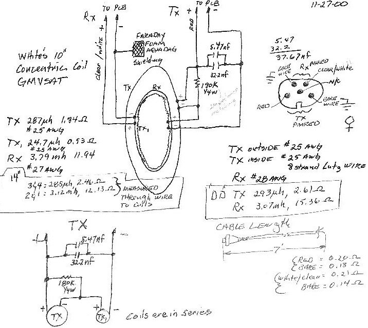

Notes I made from a Whites GMT eliptical coil
Tx freq 47.6khz
RX 3.0mh 16ohm
RX PIN 1 clear center
RX PIN2 shield
TX 2.75uh 2.55ohm
TX Pin 3 shield
TX PIN 4 red center
In parrallel with TX coil is 33nf + 2.2nf + 470pf.
Not sure if each coil was custom tunned or all coils had these values?
yes, custom tuned of TX coil sure to 48kHz. those additional '2.2nF + 470pF' are set just for accuracy of the tuning in resonance.Originally posted by Altra View PostTo add to Carl's post 5

Hmmmm! The material (KT315) posted is accurate with Whites factory material... I was not aware it (48 KHz coil data) was out in the internet! KT315 posted material has additional data added to Whites factory material. Now factory original material was drawn by unknown Whites engineer, who I believe was John Earle him self! John Earle back then had left Compass Electronics before its demise, after creating Compass Electronics models AU52, AU2000, Gold Scanner Pro, and Gold Scanner units, and then became Chief Engineer for Whites Electronics.
Thumbs up KT315! It has added to Whites Electronics factory drawing more excellence...

Hi altra did tx is 2.75 uh . Or 275 uh ? And what sp?cification of tx insid ?Originally posted by Altra View PostTo add to Carl's post 5

And my coil is only 33 nf +2.2nf
And risistor between tx outsid and tx insid .
