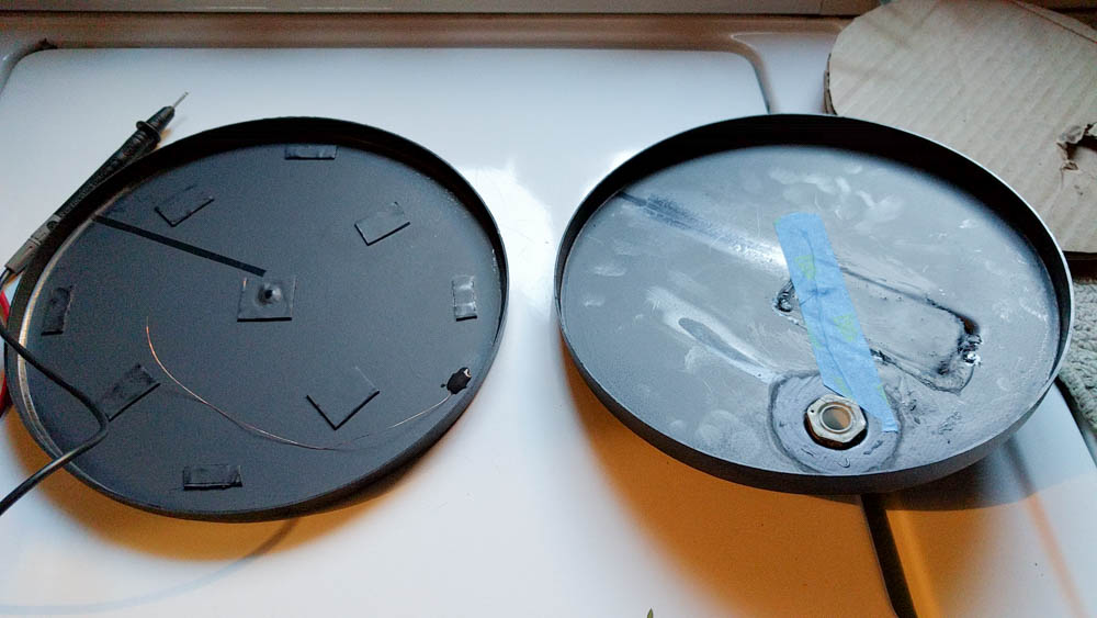

Nokta velox one coil reverse engineering
    You need an LCR meter to measure inductance & capacitance. You can't reasonably do this job without one.

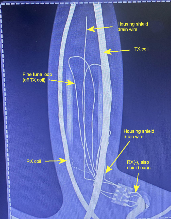

    Here is my take on the internals:
    Having the cable gland on the RX side is a bit unusual, you normally want it on the TX side to minimize RX pickup of cable flexing. Anyway, the single wire straight up the middle is a ground drain embedded in the shield of the upper housing. There is a second drain wire that is embedded in the shield paint of the lower housing (under the TX winding, you can't see it). These are connected to the RX(-) side, which acts as the shield ground connection all the way to the main box. Likely the 5-pin connector only uses 4 pins.
    I agree with the others that the 3-pin device is probably a trim pot. The proper values and pot setting will be difficult to determine. This is where you will need an oscope and maybe a signal generator.
      what is tha wire for ? = Shield wire, not captured on Xray, or could be the single vertical wire on the center.

      the fifth wire (ground wire ) can be connected to washer under nut of cable fitter.
        high res pictures = the fifth pin may be not used, on the first PCB pad (on the top ) you have
        1. ground wire bottom side
        2.ground wire bottom top ide
        3. Rx wire​
