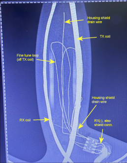

    Here is my take on the internals:
    Having the cable gland on the RX side is a bit unusual, you normally want it on the TX side to minimize RX pickup of cable flexing. Anyway, the single wire straight up the middle is a ground drain embedded in the shield of the upper housing. There is a second drain wire that is embedded in the shield paint of the lower housing (under the TX winding, you can't see it). These are connected to the RX(-) side, which acts as the shield ground connection all the way to the main box. Likely the 5-pin connector only uses 4 pins.
    I agree with the others that the 3-pin device is probably a trim pot. The proper values and pot setting will be difficult to determine. This is where you will need an oscope and maybe a signal generator.
    I am unable to determine if there is shielding as far as I know its plastic and resin not sure if there is shielding inside (would the shielding not black or at least show on x-ray)? please explain I'm no expert at all
      There is shielding, most likely carbon paint applied inside the housing. Won't show up on an x-ray.

        what do you think about aluminum foil wrap shielding or copper shielding if i am unable to procure carbon paint also do you recommend ferrite shielding somewhere on the cabling ?
          You could try foil shielding, but I would recommend instead a metallized fabric tape similar to 3M's CN-3190, it's much easier to work with. Carbon paint is easily found, look for MG Chemicals 838AR.
            can you please elaborate on the usage of an oscilloscope and signal generator (should I use a small coil hooked up to the oscilloscope to induce the signals, or splice into the cable or just use the coil directly on the oscilloscope) do you have ideas on how to narrow it down.

                I would drive the TX with a sig-gen and characterize the RX response over frequency using the oscope. That might give a hint as to what you need to do in a homebrew coil to match the response.
                If you don't have a good understanding of electronics, then this project might not be a good place to start learning. Detector coils are really simplistic, until you start building one.
