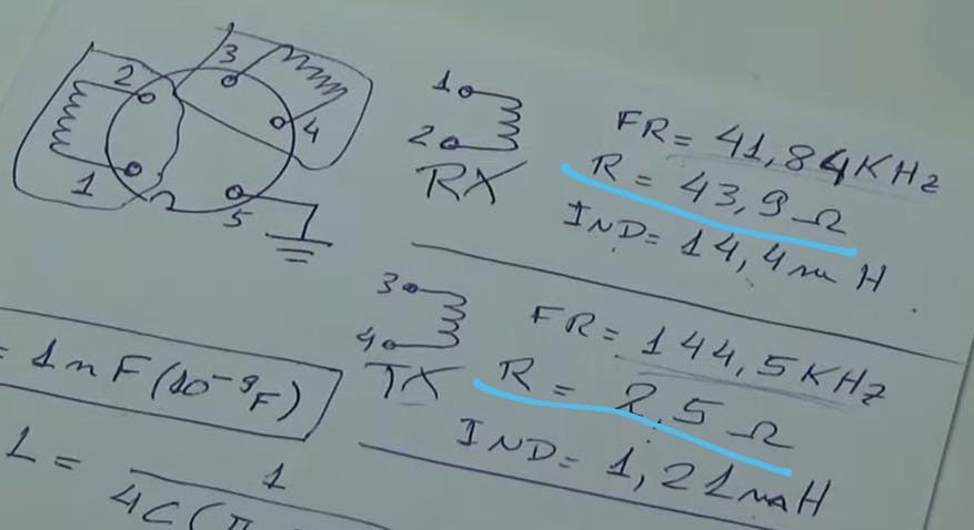

              Numbers I found were based off of these coils:
              10x12 ws, Tx 1.21mH @ 4.4 ohms Rx [email protected]
              8x9 c, Tx 1.235mH @ 4.5 ohms Rx [email protected]
              5.75 ws, Tx 1.117mH @ 4.2 ohms Rx 18.98mH@74ohms
              5.75 c, Tx 1.198mH @ 4.1 ohms Rx [email protected]

                  My particular 10x12 measures
                  TX: 0.93mH @ 3.9Ω
                  RX: 15mH @ 57Ω
                  Might be one of our meters is off a bit. In any case, no, don't add a trim pot. TX coil resistance is the important one, try to achieve 4Ω. The RX resistance is far less important, but try to keep it below 100Ω.

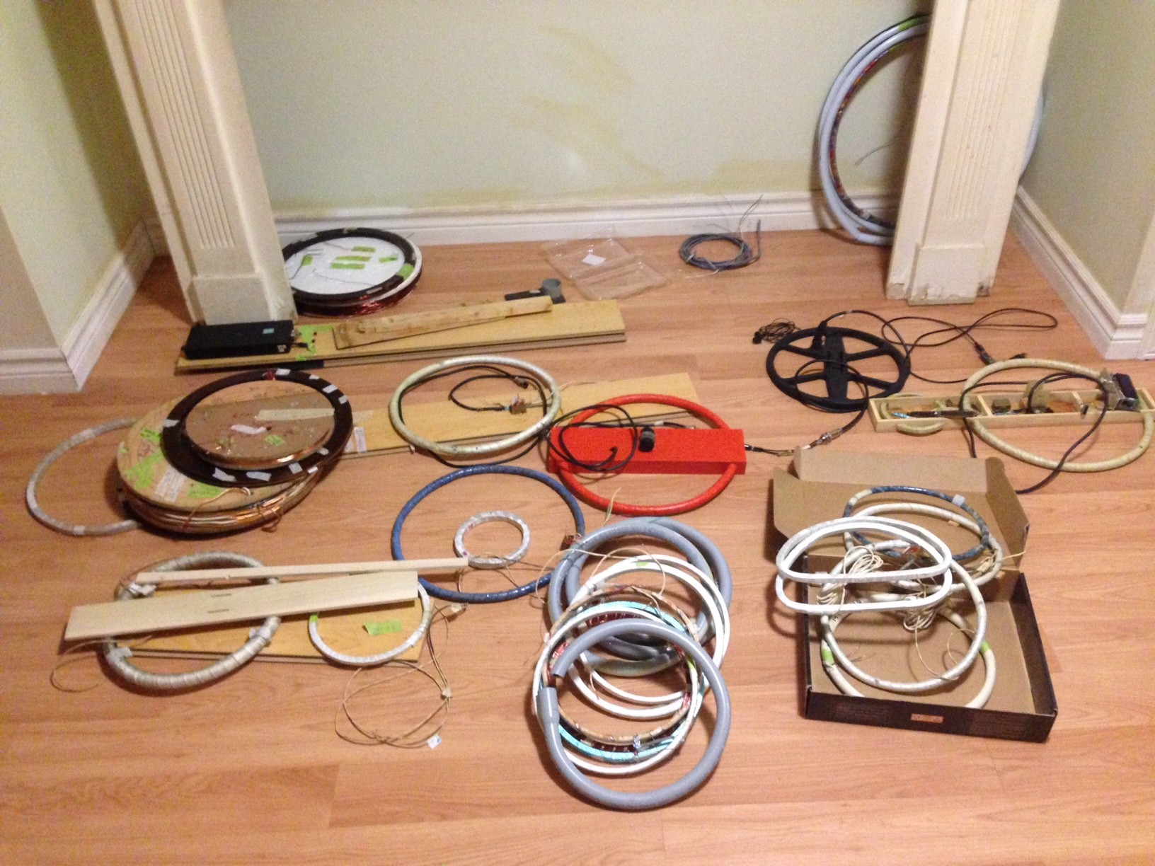

                    Tx, 20 cm coil and 30 cm coil, both 70 turns.
                    Bigger coil will produce stronger EMF, draw less current, and the sine wave will have less distortion.
                    This is the result of building and testing many many coils, some of them on picture.
