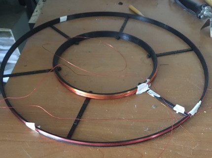

          So for a 300mm d concentric I came up with:
          Tx = 36 Tuns of 26 awg, 9 of which will be the Bx approx
          Rx 218 turns 30 awg
          Sound about right?
            Yup, sounds pretty good.
              So far the coil is coming along but ran into an issue with the Tx. I used 26 guage and according to the coil calculator i should have been at 4 ohms but instead I end up with 5 ohms. The Rx came in with spec according to the calculator. I had a similar issue with an elliptical I was working on with Tx being way out of spec. I took a mic to it and 26 awg is supposed to be 0.0159" but the spool I have is 0.0163".
              Would too much resistance cause the machine just to sound off when hooked to it as if it had a broken connection? I have continuity with rx, tx, even through my cable and cable has a new connector. Machine works as it should with stock coils.
              Here is the frame I made to wind on. It mounts to a piece of mdf that I mounted to my winding machine. Plan is to do my winds on this then mount it inside a printed housing. Since fdm printed parts have a grain to them from their layers to make this durable I will make a separate coil ears that will mount to the housing and bolt in with plastic bolts making them also replaceable. This allows me to print the housing upside down so there is no supports required and no cleanup. Similarly the winding frame also does not require any supports.
              All goes well I should be able to make a few and keep them consistent.
                Out of curiosity I took the shielding off the wire and it specs to 0.0155" with shielding 0.0163". Precision wire specs say 0.0159".
                  Wire appears to be within a reasonable spec. An extra ohm is not going to make the coil not work. At worst, it will slightly shift the GB preset and might cause some GB drift over temperature. I would not worry about it.

                          Found a couple of things. First off I was using a very old original Tesoro cable and it may have had a break in the shielding somewheres so it would have a short. I replaced that with fresh cable I had purchased before which had 4 wires + ground. I don't need the ground as this is a delta coil. Tinned the ends and put the connector on and added some potting in between on connector to make sure there are no shorts.
                          Still had the fault so for kicks I swapped wires and it works. Turns out the wires were marked wrong on the info I had picked up off the web. Tx and Rx were on wrong pin #'s.
                          Coil isn't half bad as I have it but will hook the scope up and fine tune it best I can.
                          Tx should be pins 4 and 2, Rx is 3 and 1. Pins 2 and 1 are returns as far as I can tell.
