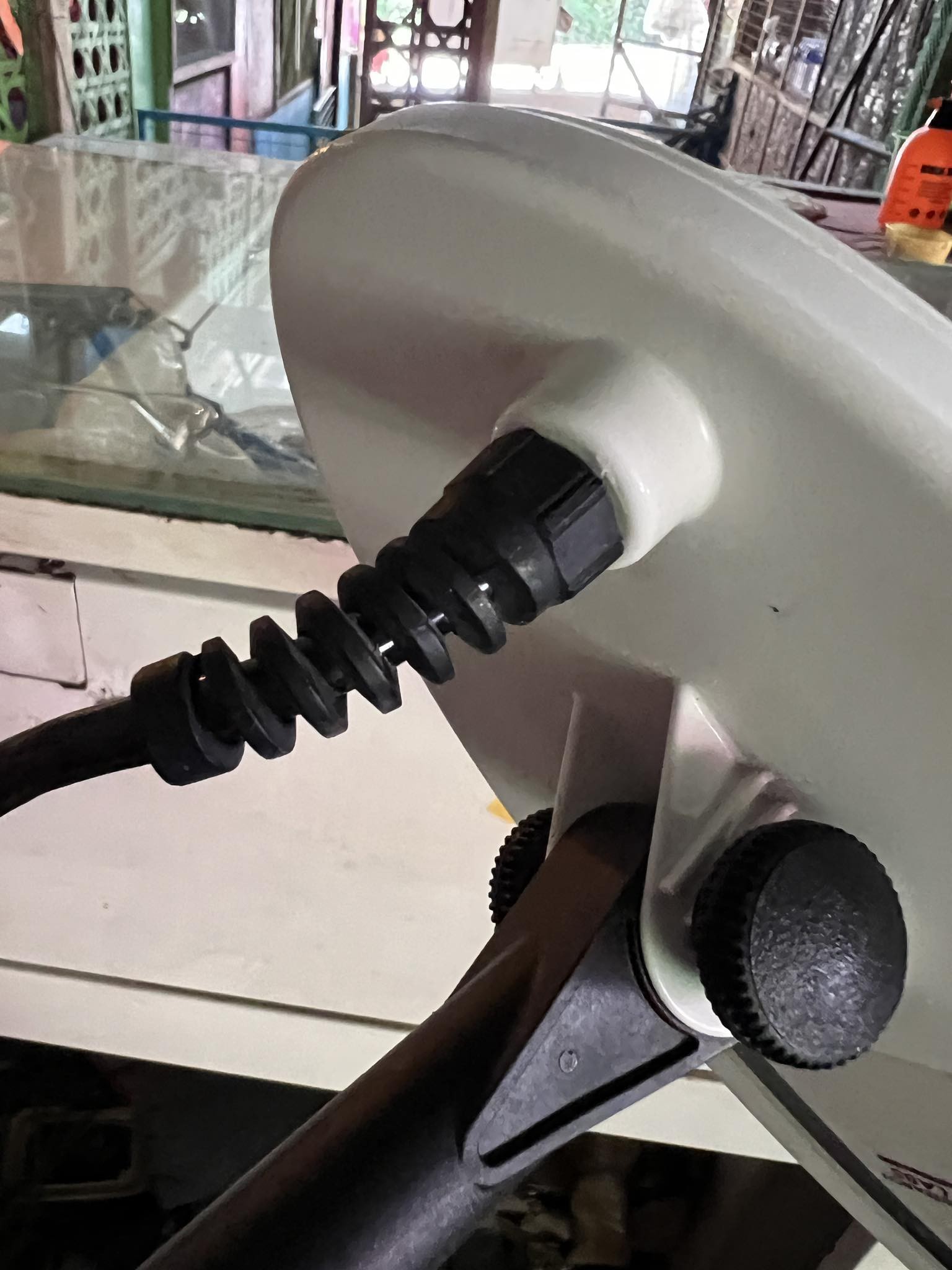

    I have a bad cable on a Fisher Gold Bug coil, All persons previously contacted say the coil unit is unrepairable since the cable is not detachable.
    In my mind, a constructed item can be unconstructed. Is the cable indeed replaceable and how?

        Of course, the Gold Bug is an older model, purchased used, the detector is completed but it seems the cable from the coil to the instrument box has internally frayed. I sent it to the Philippines to detect and the operator has shown that he needed to press together and tape about five spots on the cable for it to produce a metal detect signal.
        Yes, we need a whole new cable, bought one but it's lost in the mail. to much expense already to trash.
        So, can I just replace the offending cable? All received advice so far is the cable cannot be detached from the coil head.

            The first thing you need to do is split the coil housing by cutting the cemented seam around the perimeter. Usually this is difficult and tedious, and you need to be careful not to cut through the plastic shells. You just want to split the seam overlap. Be very careful separating the shell halves as the bottom shell will have a drain wire connected to the shield, you don't want to rip it loose.
            Next, with the shell opened, desolder the cable connections, loosen the Heyco strain relief, and remove the cable. You should be able to re-use the connector on the new cable; it has a spring snap release that you press to pull it apart.

                How then to re-seal that can stand the rigor of active detecting? Would a silicon tube seal hold up to use?
                  Sorry, I was thinking it was the old Goldbug. This is the newer digital one. That connector has a tiny phillips screw, plus a cable clamp. It can still be reused if they didn't add epoxy inside.
                  Show a pic of the coil. The 7x11 cannot be opened except with dynamite. The smaller coil can be opened, but might be epoxied inside and unrepairable.
                    This is the Coil, repairable?
                      You have a chance. Split the overlap seam and open it up, if they did not goop epoxy around the inside of the Heyco gland then you can repair it.
