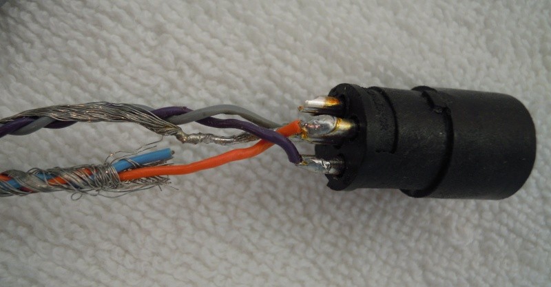

                  I have received helpful repair info. for the F19 from the quorum. Thanks. all
                  Can I get general confirmation the cable needed to repair from control box to coil is Belden 8723 cable?
                    A dual coax cable is preferable but a dual twisted pair might work OK. I don't like foil shielding because it tends to break down due to flexing, braided shield is much better.
                      [QUOTE=Carl-NC;n42
                      I don't like foil shielding because it tends to break down due to flexing, braided shield is much better.[/QUOTE]
                      Apparently, that shielding break down is exactly why this cable is failing in multiple spots!
                        Click image for larger version  Name:	wire.jpg Views:	0 Size:	67.4 KB ID:	428188 Apparently, that shielding break down is exactly why this cable is failing in multiple spots!
                        braided shield breaks down more vs foil shielding, in a place of strain relief near the coil and near the socket.
Name:	Dual Coaxial #2.jpg
ID:	428607 ​ ​​​​​​​
                          Hello all, After all the great advice, it seems the easiest way to repair this damaged cable is to ​ ​ ​ ​ just splice in a new one and water-seal the spliced sections. So, the above advice mentions a sole cable, but the connector has five posts, which cable to use? the dual coaxial or the previously mentioned Belden 8723?
