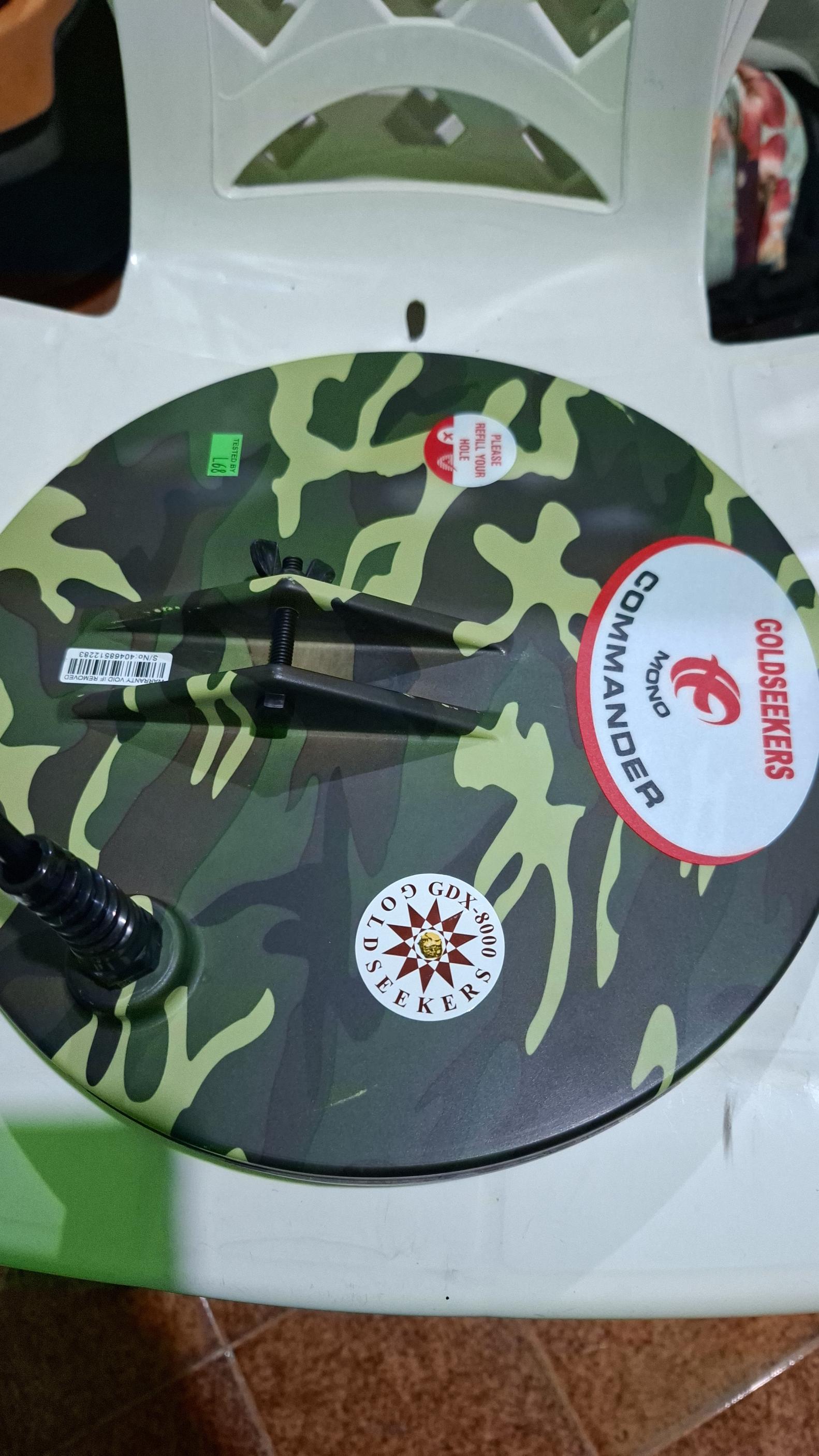

    Hello, does anyone know how to connect an 11" mono commander coil to use in a PI detector? We know it has 5 pins. Does anyone know the inductance and resistance?​

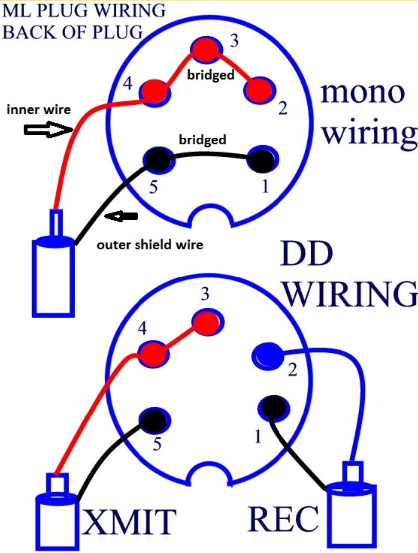

    Common Minelab pinout:

      Thank you very much, Carl.
      I'm thinking about adapting it to my GS5 lite.​

        Hi Emersonpaz,
        Mono 300uH and 0.4 ohms are the standards.
        Regards, Ian.
          Click image for larger version  Name:	IMG-20250806-WA0074.jpg Views:	0 Size:	434.9 KB ID:	439856

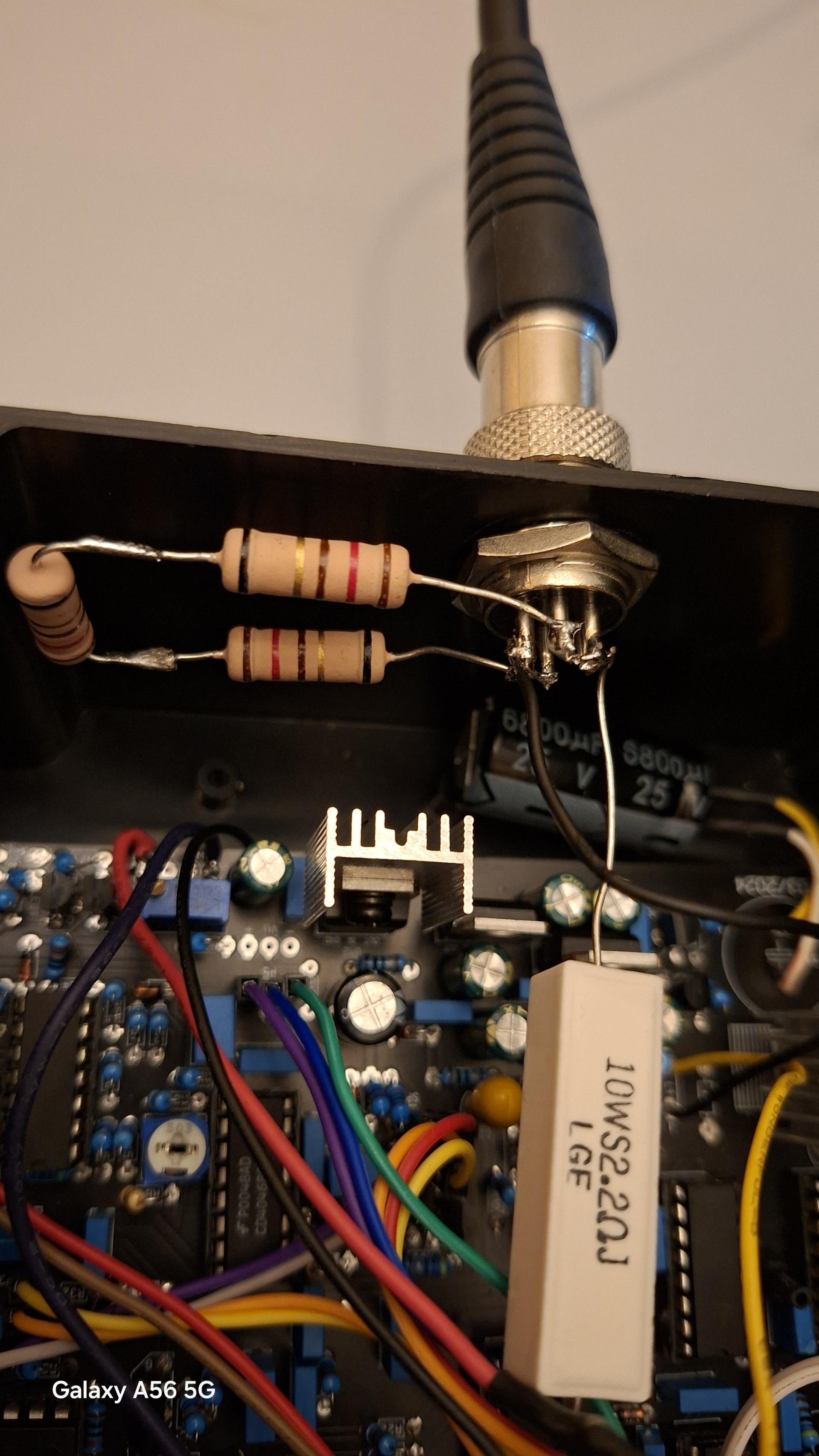

          Thank you, yesterday I just received the 11-inch Commander mono coil, and yes, I came across this low resistance.
          Even so, I tested it on my GS5 using the diagram Carl provided.It worked well, but the 5 W, 390 R damping resistor got very hot and made the detector unstable. Current setting: 103 uS pulse, frequency: 2650 kHz.​
          As suggested by eduardo1979 I will apply a 2.2 ohm resistor in series with the irf840 drain (k2545) as is done in the GS4 and perhaps reduce the pulse to 60uS 80uS if necessary.​
          I'll come back with feedback after updating.
            Drain output MOSFET 2R2 10W and damping 3 resistors of 5W 120R in series totaling 360R.Continuous pulse 103uS frequency 2650hz.

                I think you need to adjust the active clamp so that after passing the metal over the coil it doesn't make a sound like in the video, after passing over the coil the sound should stop!
                  Hello Orbit t, thank you for your comment. It was taking a while to stabilize.I solved it by changing TL084 to TL064. In this video below, you can see that its behavior is better. I had to change the configuration because the heat generated was a big problem. Now the 10W resistors and the 3 5W series resistors are slightly warm. My current configuration reduced the pulse from 103uS to 62uS and the frequency from 2650Hz to 2150Hz.
                  https://youtube.com/shorts/2cm2zIaUB...ZQQf4_bmqc0icQ
                    BA10324 - it works even better.

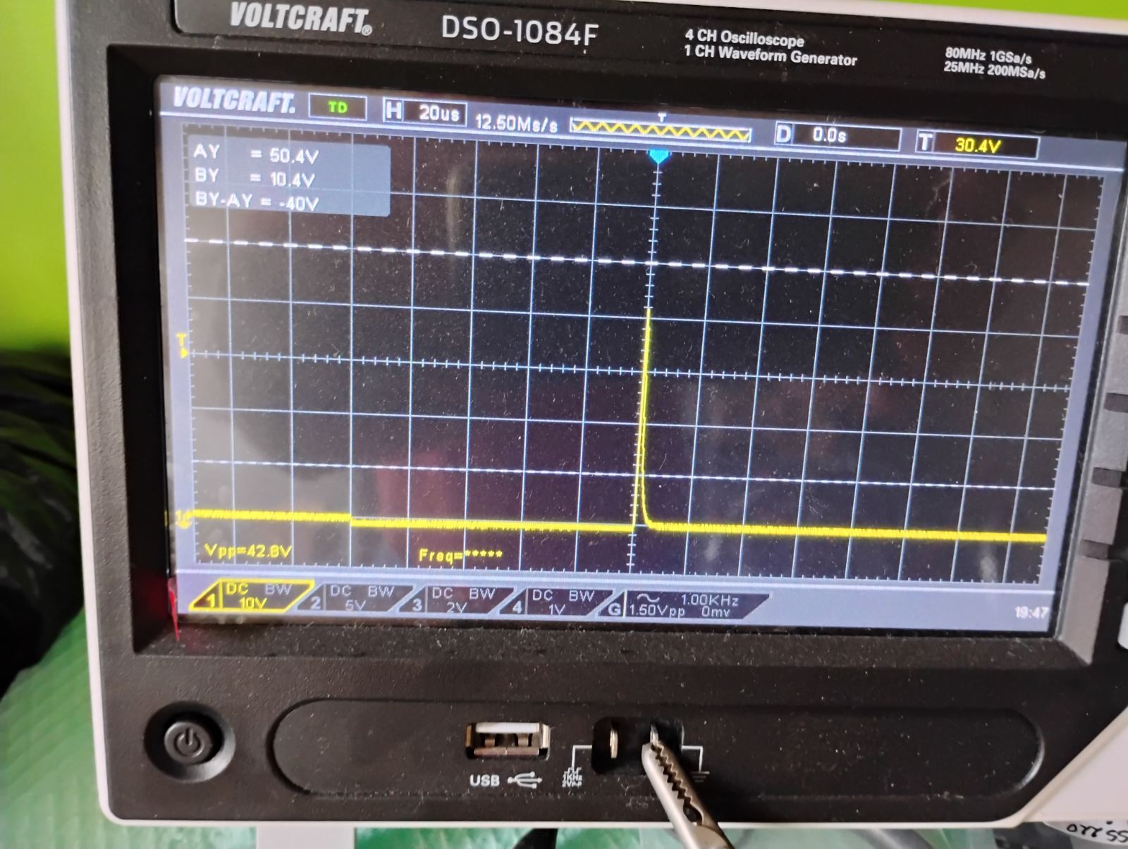

                          hello pechkata the coil is well damped. 360r 3x120r.
                            Hello Emersonpaz
                            How did you find out - show an impulse in a photo.
