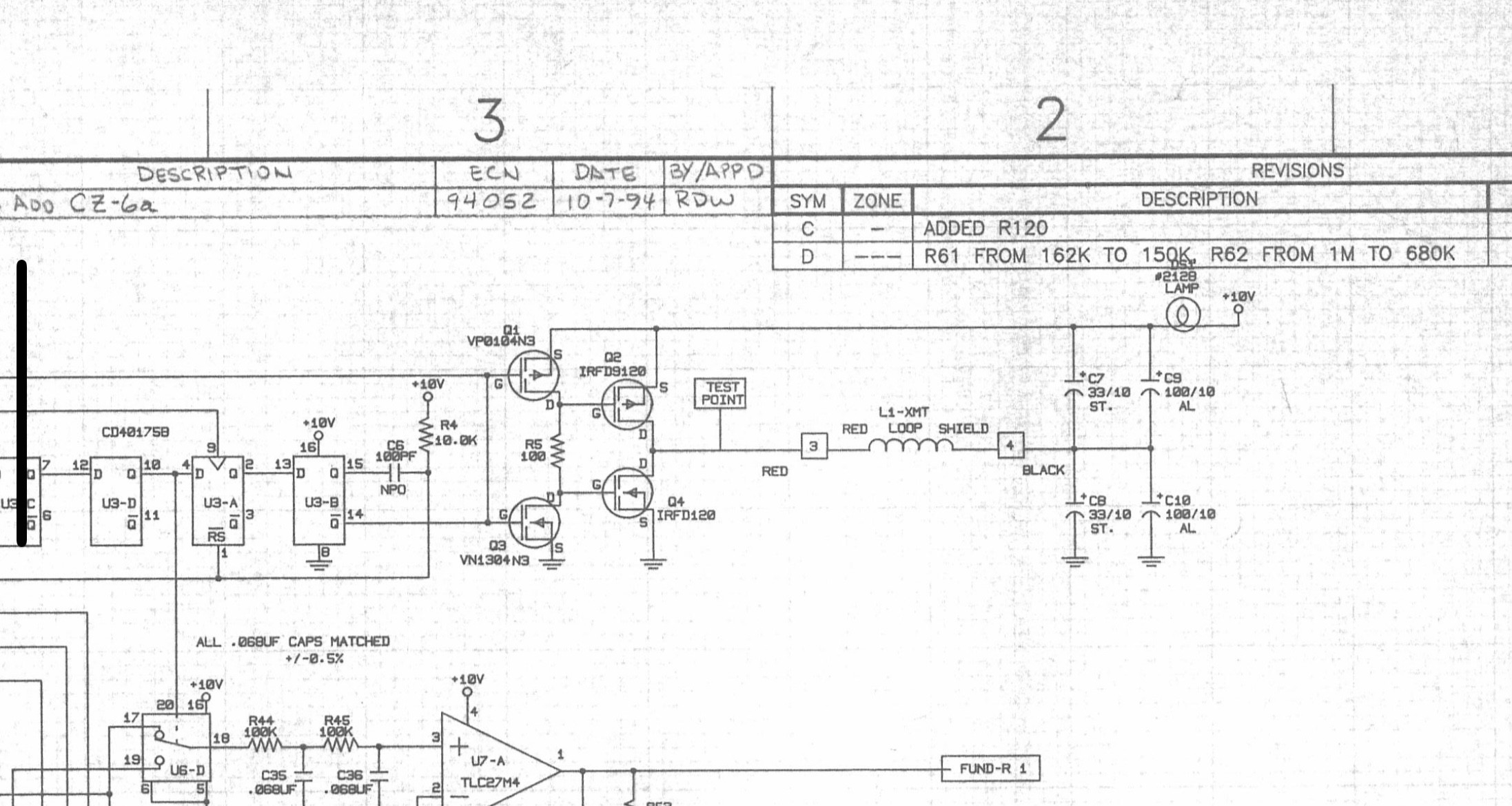

            Does anyone have any information on the winding data of coils for fisher cz5? I'm interested in the exact data of the TX coil.
            In the fisher, the circuit of the transmitting cascade, according to the service manual, is powered by 10V.
              See post 7

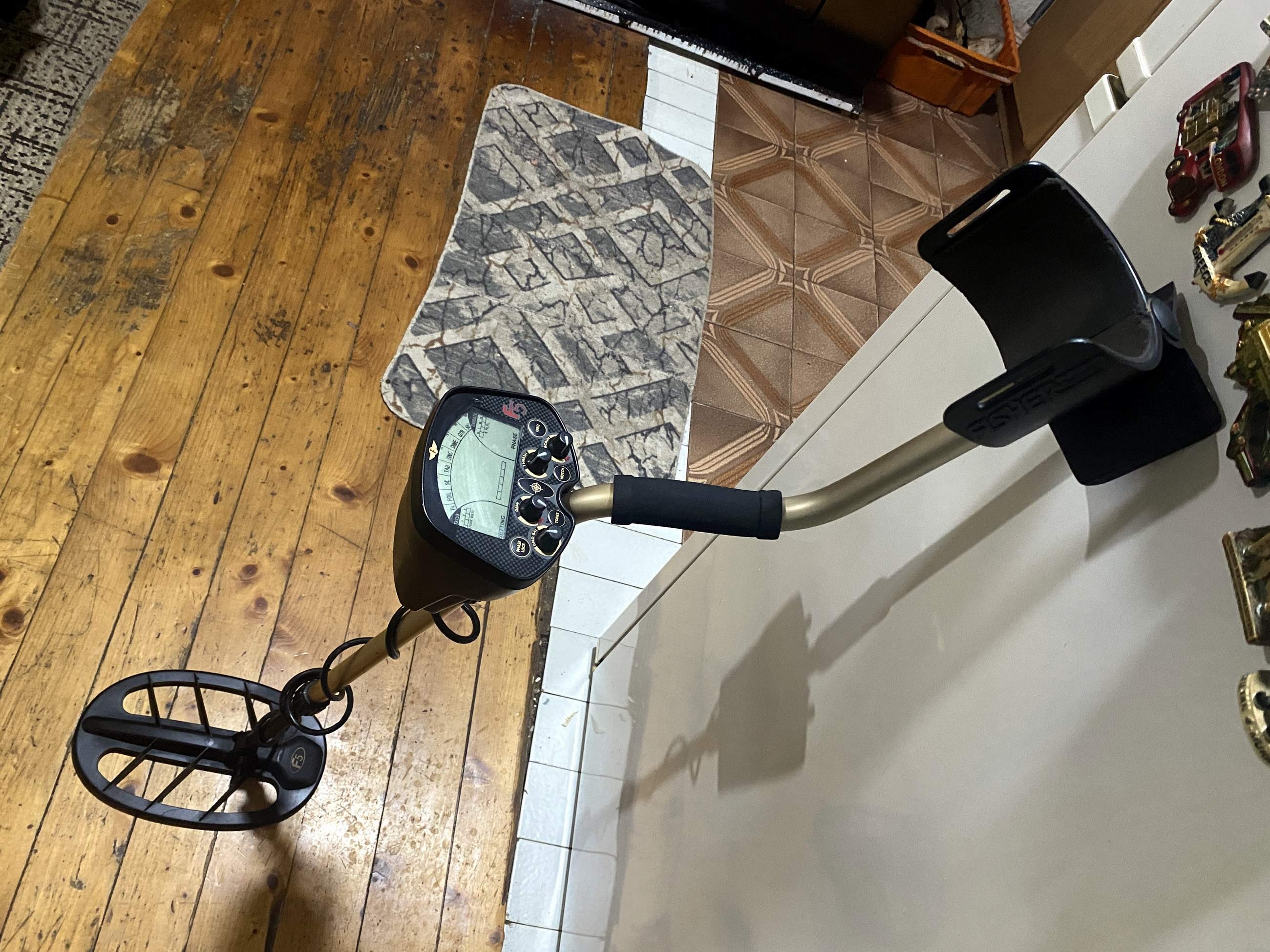

                F5 keeper!
