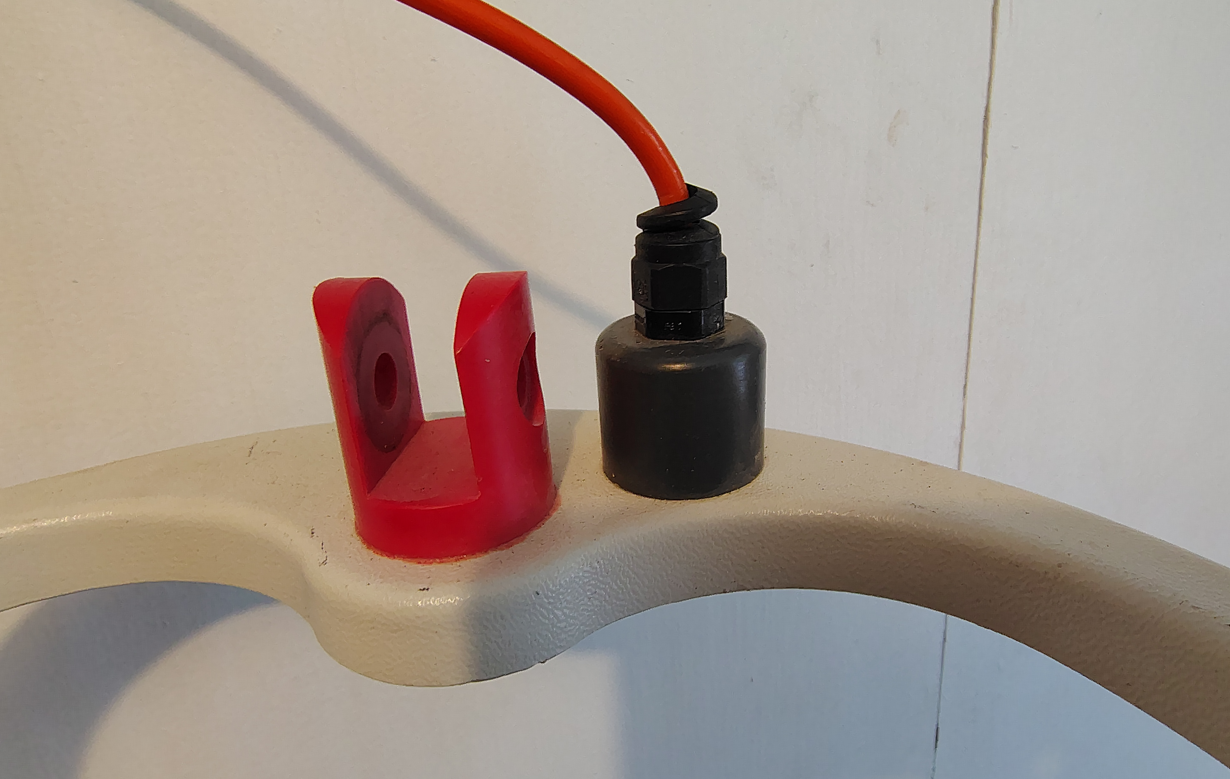

    Hello everyone.
    I've built an 8-inch mono coil for my TDI SL using Litz wire salvaged from an original Minelab coil. I painted the housing with high-quality graphite paint, and so far, everything looks perfect. The connecting cable is the same original Minelab coaxial cable. The coil detects small gold nuggets very well. The problem is that it detects a hot rock right at the junction of the coil wire and the coaxial cable, precisely under the cable gland. Elsewhere on the coil, the hot rock doesn't register any signal, only at the connection I mentioned earlier. I'd like to know if anyone has encountered this problem before, as I don't know how to solve it. If I increase the delay to 17µs, the problem disappears, but that prevents the detection of gold nuggets. Thanks in advance.

      Your problem is a too-large solder joint. The hot rock creates a magnetic field deflection that induces an altered eddy current in the solder joint and makes it look like a dynamic target. If you have ITMD3, see 28.5. There are 3 approaches to fixing this:
      1. Always minimize the size of the solder joint.
      2. Minelab has a patent on encasing the solder joints in ferrite, see WIPO 2011/116414.
      3. On some of his PI coils, Eric Foster would ad a ~25mm "tower" to the gland and use that to place the solder joints away from the ground.

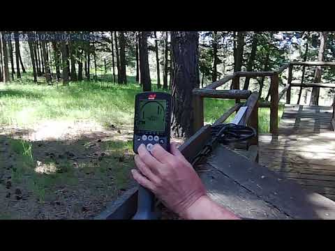

        Carl, I have all your books, including ITMD3. I've attached a link to a short video I made so you can see exactly the problem I'm having. I've made the ground connection with a longer wire; in the video, it's the green wire.​
          In my opinion solder joints looks a little big and the space between the litz wire on the left (paralel wire) will act like a small coil. It needs to be a little twisted.

            The biggest problem is not the solder joints themselves, but their position, which is in line with the lower coil windings.
            Lifting and removing the solder joints from the plane in which the coil is located would greatly alleviate the problem.
