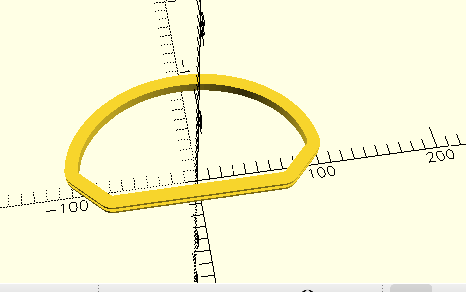

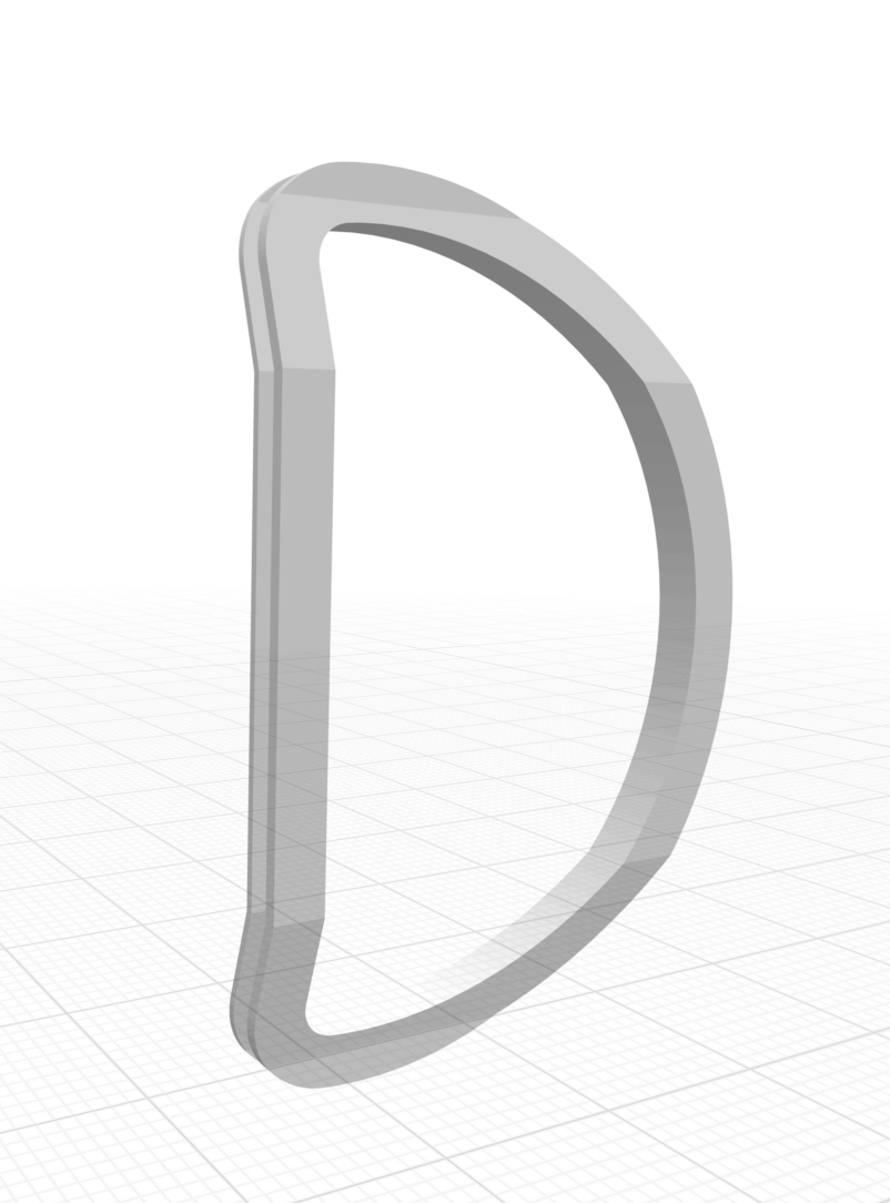

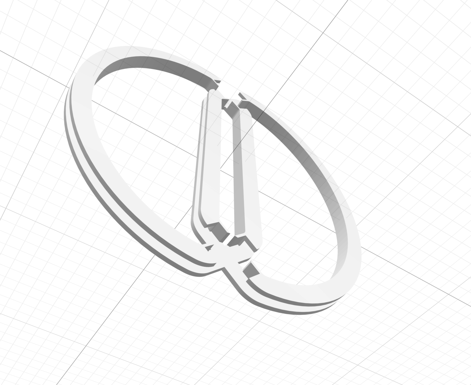

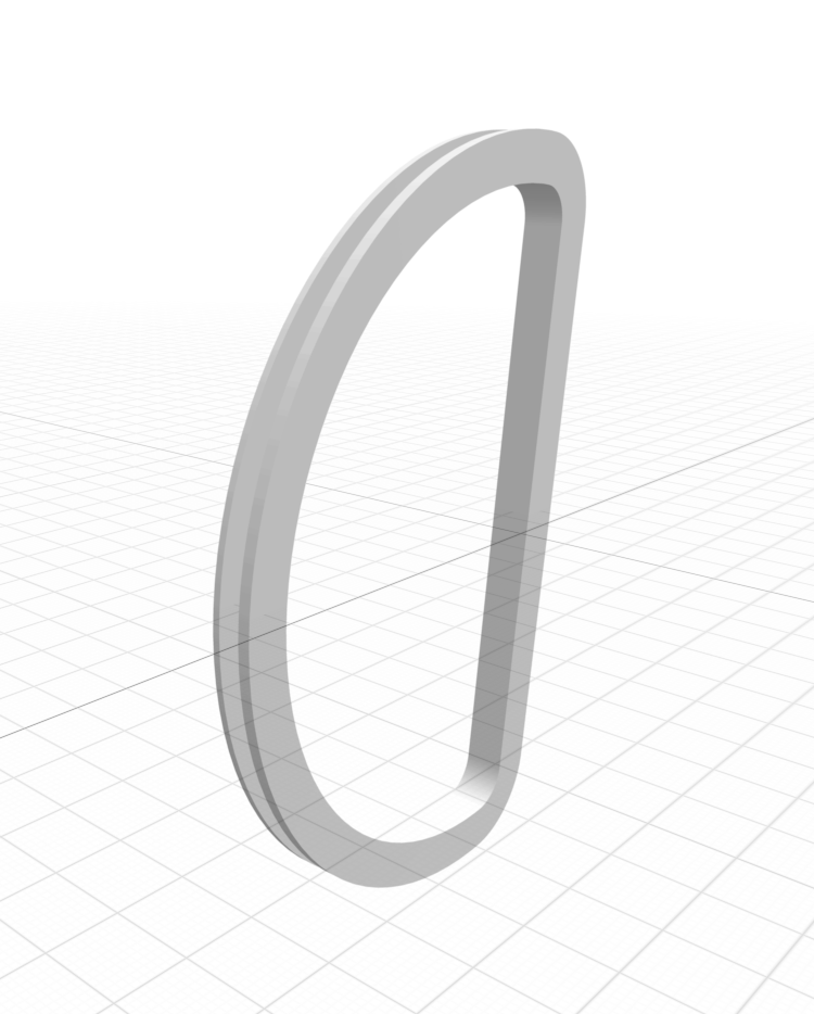

    Here is the STL for a DD coil with easywind coils. ( zip files attached ) - created by openscad using AI and vibe coding.
    20 cm x 2.5 cm

    One thing you want to do is create 90° overlaps, this minimizes the parasitic coupling and gives a deeper R Null.

        Easy wind coil former for 3D printing with X crossings.

          There ya go!

            Shouldn't the coil be in the same plane? The bends of the coil affect the distortion of the field.
                It won't make much difference. Personally, I'd just keep the TX coil flat and allow it to be slightly elevated.

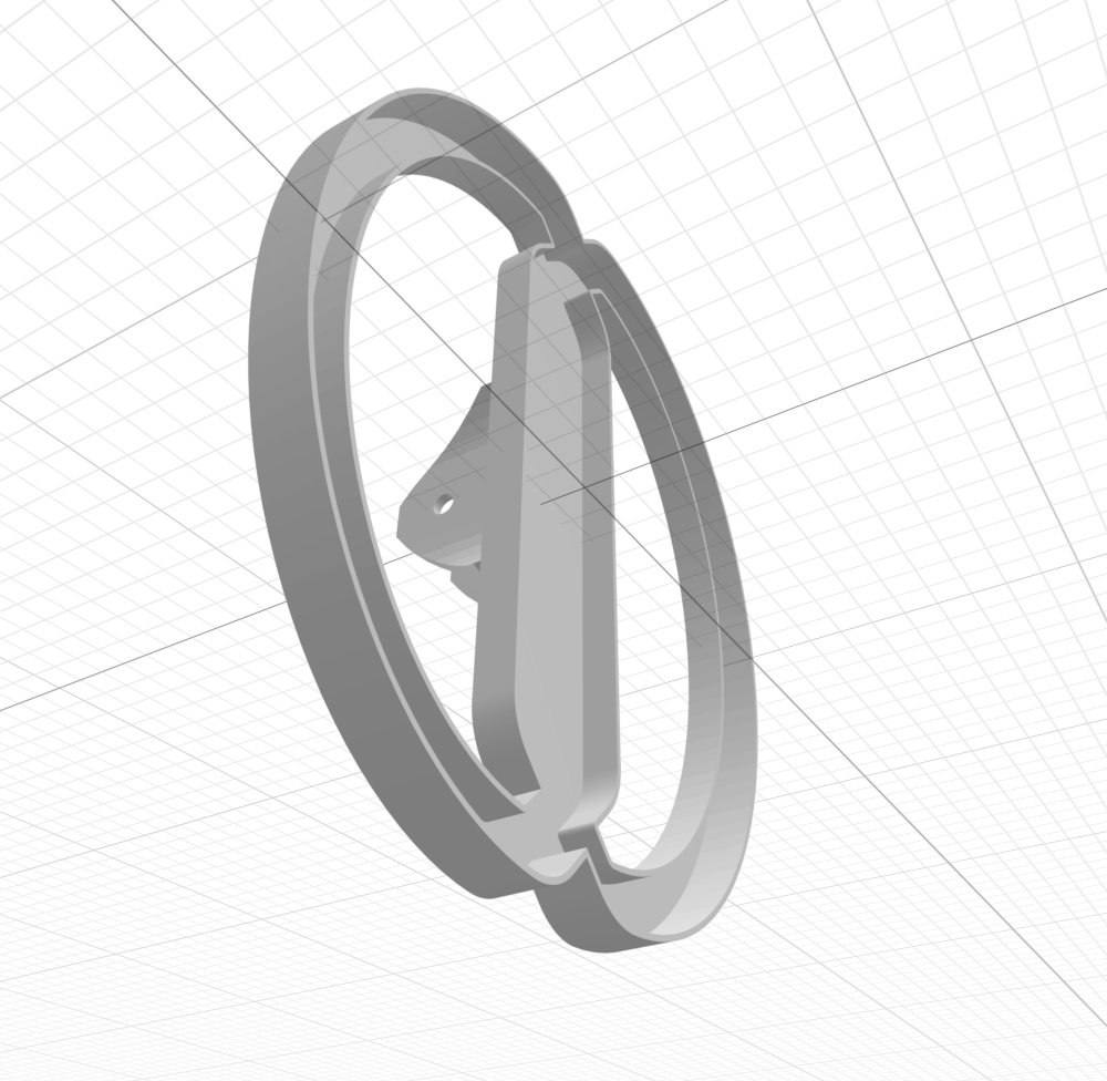

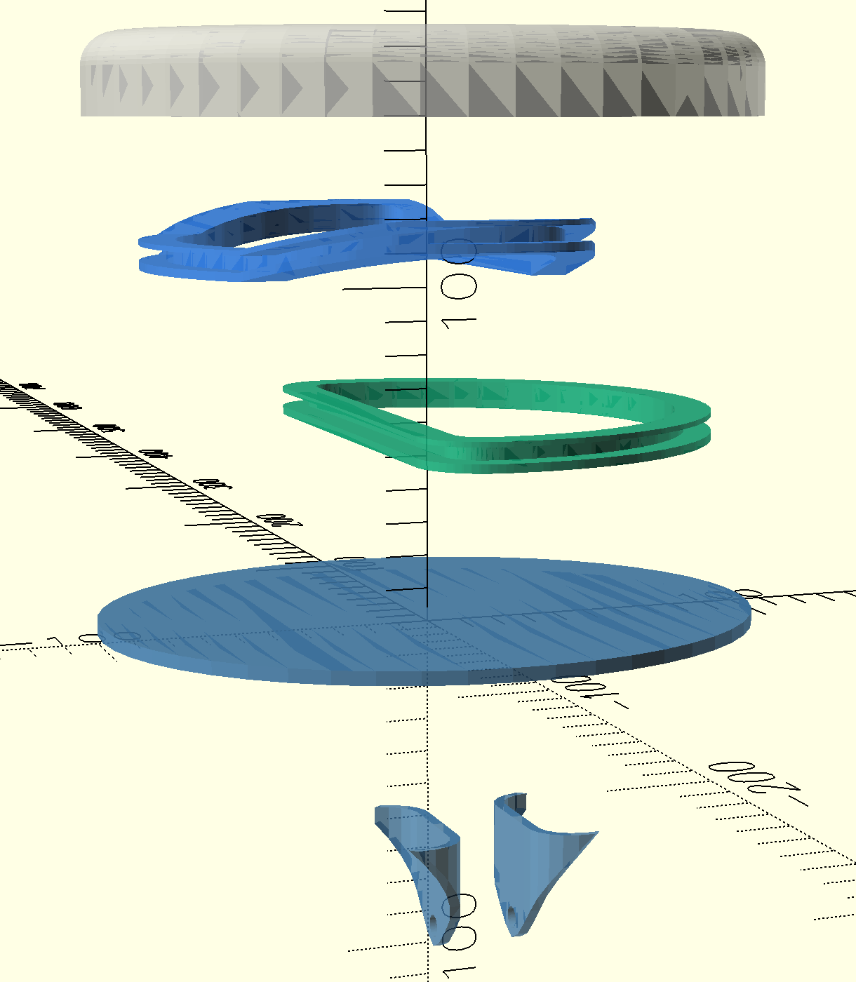

                  Below is the Version 4 ... Easywind planar coils.
                  Click image for larger version  Name:	image.png Views:	0 Size:	477.0 KB ID:	446767

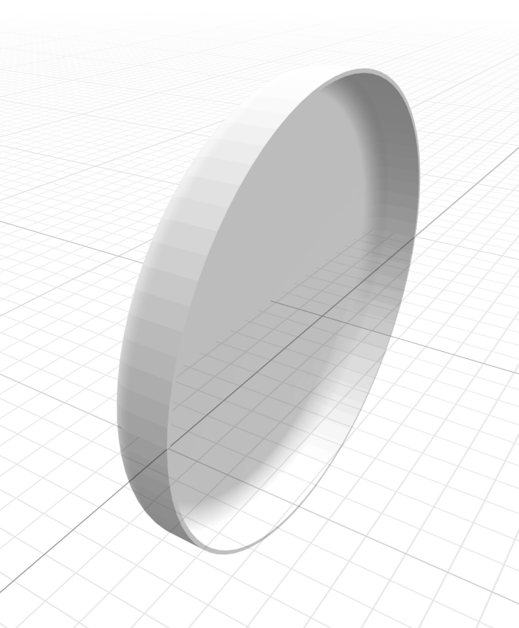

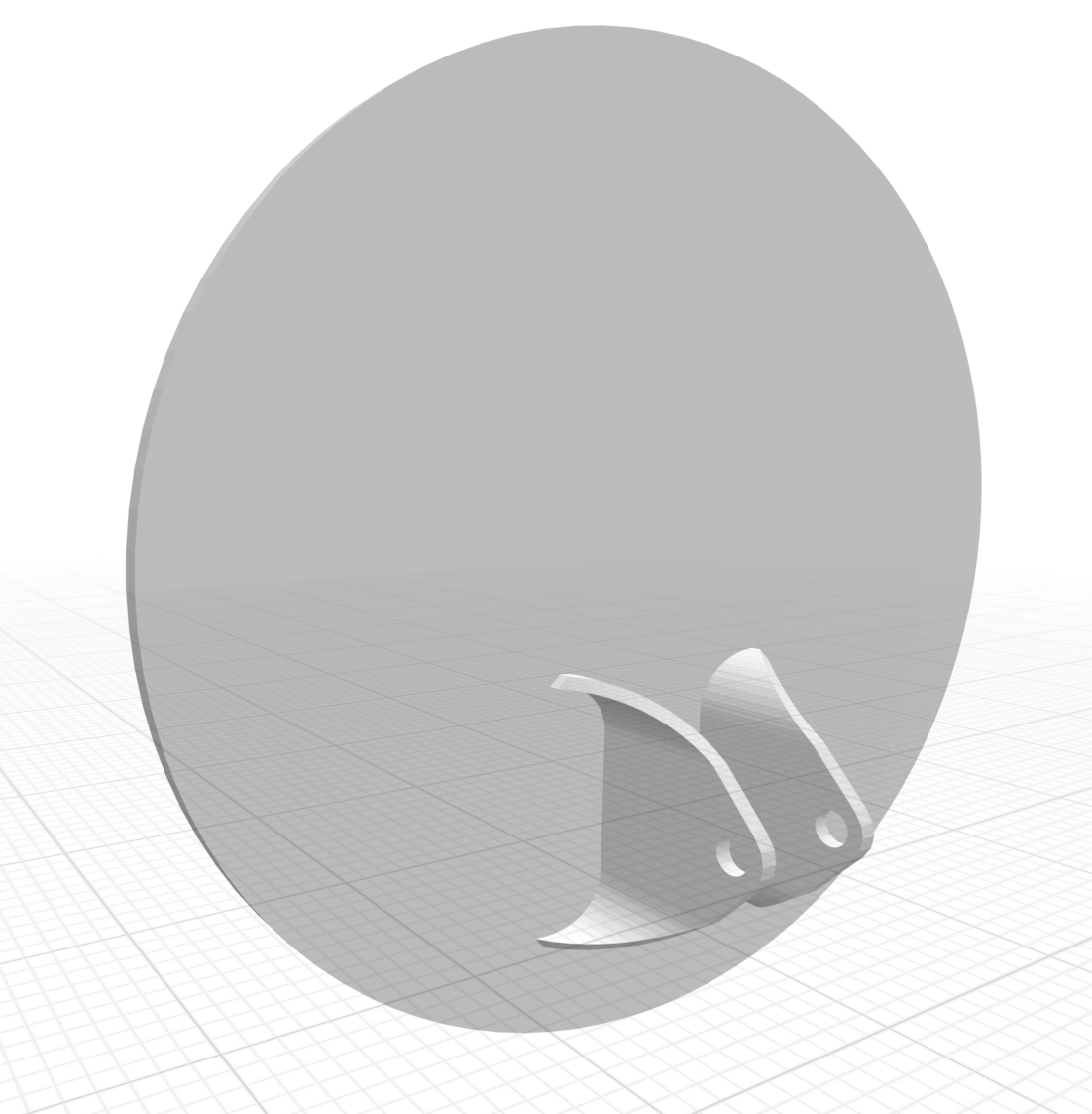

                    Here is the matching coil cover for the planar Easywind coil former.

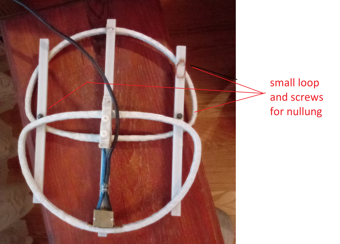

                      In this version, the coils will not be able to move relative to each other. How to adjust the residual imbalance?
                        If you take some factory coils apart you will see they dont have moveable parts ... they use gimmick windings.
                          With DD coils you often have the ability to move the windings and get a good first null, and then use a tweak loop for the final null. With a few iterations, the bobbin in post 9 can probably get the overlaps close enough that the mechanical first null isn't needed.
                          Paul, was all of this done with AI?

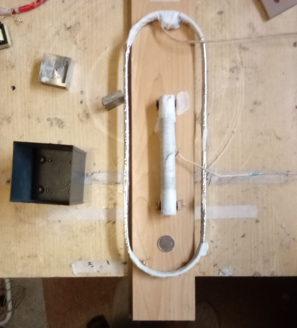

                            Click image for larger version  Name:	image.png Views:	0 Size:	1.08 MB ID:	446777
                            Click image for larger version  Name:	image.png Views:	0 Size:	1.22 MB ID:	446778
                            metal objects around the coil for balancing​

                              All done with AI ... I took source code for openscad on github and got the AI to "bolt" an AI command interface into the code.
                              Recompiled it and now the AI can do everything the GUI / script editor can do but importantly the AI can manipulate and "see" the
                              3D model space ... so its quite weird to watch the AI spinning, zooming the model then making changes by itself.
                              I did ask the AI to set the base geometry so all things being equal a null could be achieved with only minor tweaking of the coil structure.
                              The hardest part is using the right language so the AI can understand what you want. Ferinstance discribing the X crossings took a bit of dialogue but
                              making the coil cover was simply "build a conformal coil cover with mounting tang" ... an that was it.
