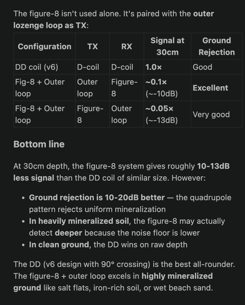

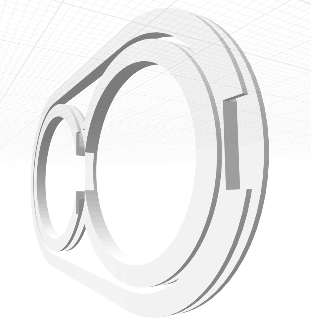

DD coil for 3D printing with easywind coils.

      The AI suggested this enhanced X crossing would be easier to adjust ...

        Originally posted by JoyJo View Post
        In this version, the coils will not be able to move relative to each other. How to adjust the residual imbalance?
        when winding the coils put some packing in.
        When wound remove the packing.
        The coils will then have some slack to move.
        Adjust and glue. done.

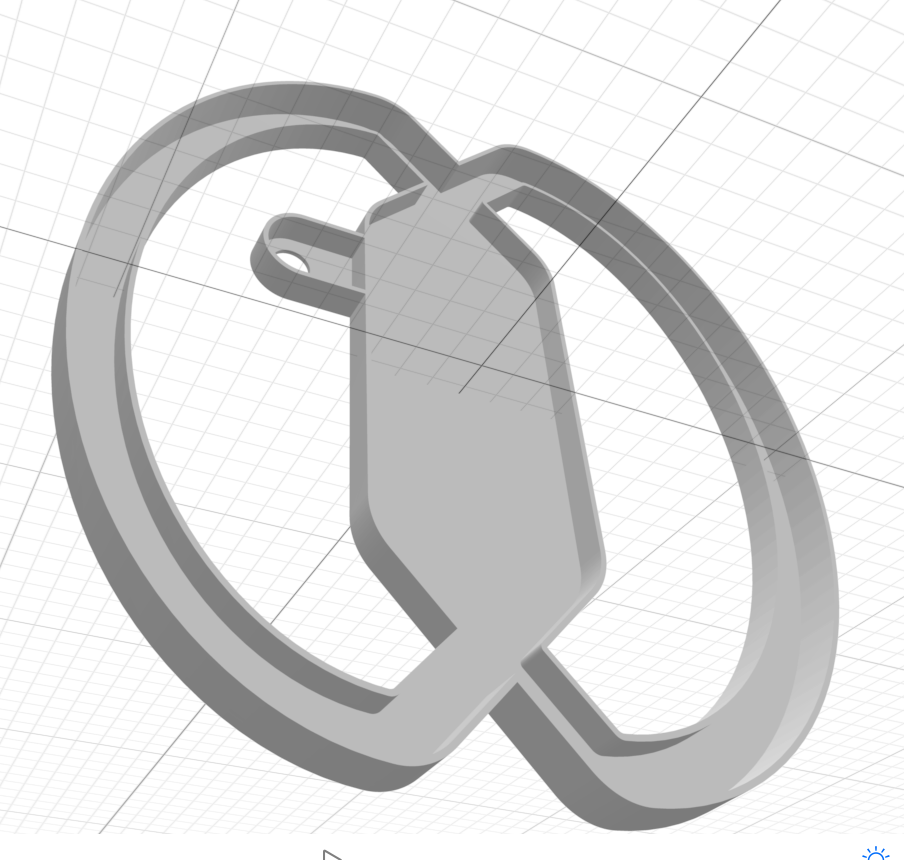

          24 cm Fig 8 coil with ovoid bobbin.
