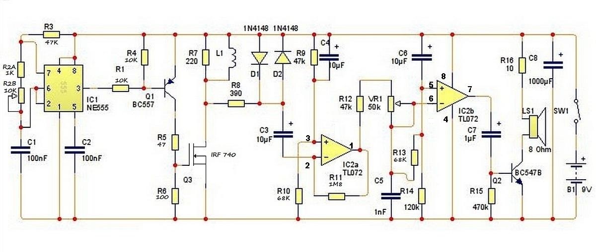

    I've been given this Chinese junk (brand is SHRXY). By sheer curiosity, the previous owner had opened the coil casing. Still working, it can detect a quarter at about an inch.
    I just want to know if any one here has ever tried to make a coil for such a cheap machine. Would it be possible to turn it into a somehow usable short range PI metal detector for surface coinshooting?
    Best regards,
    MC
    The coil appears to be a simple mono winding so it would probably be easy to replace the circuitry with a PI design.
      the simple Russian "Pirate" PI detector circuit would be suitable to fit into the detector handle. The Pirate PI is very simple, but sufficient for a "surface coinshooter" project like this.
      Click image for larger version  Name:	Pirate PI - metal_pirat_3.jpg Views:	0 Size:	101.9 KB ID:	448375
