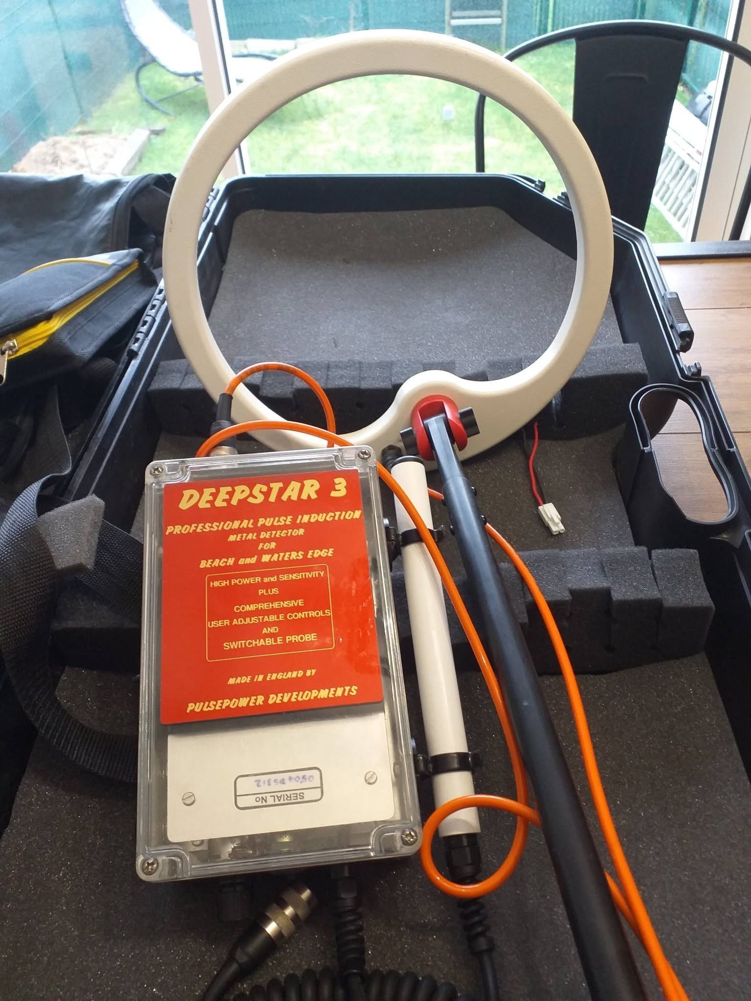

    Someone knows where to purchase this kind of orange cable that Eric Foster used in his coils? Thanks.

            Originally posted by cristiano.sar View Post
            Thank you!
            welcome

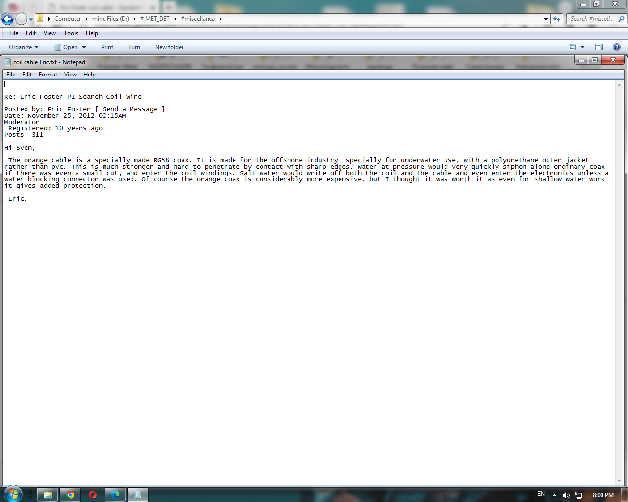

              That black sleeve inside copper mesh I remember Eric Foster say something not good about it
                Polyurethane (PUR) outer jacket.
                Multi strand strand inner core wire silver tinned (not single strand solid copper)
                Mesh tinned outer shield
                My source ran out about 8 years ago.
                Found this place using google https://www.koax24.de/en/product-inf.../rg58-pur.html
