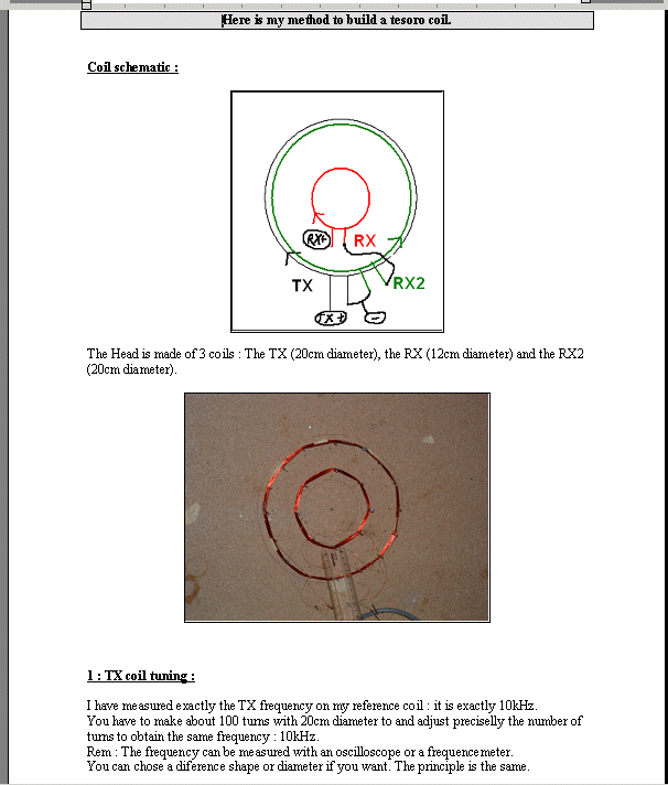

    My coil is now very well nulled, and my actual "recipe" is:
    104 turns for TX on 200mm id
    155 turns for RX on 120mm id
    25 and 3/4 turns for RX1 (0.25 of turn 26 shaped in the middle between tx and rx) 200mm id
    (with my components is OK)
    very good ! on TX osc I have (as in Mike's "recipe"):
    - TX coil gives 10.022 KHz
    - RX+Rx1 coils gives 10.506 KHz
    - whole RX+RX1 nulled signal on 1Kohm load and 47nf cap is less than 1mVpp
    Needs very good shielding too...I haven't at now on and capacitive is a huge problem.

      Hi Gary,
      thanks for the help.
      Maybe you mean C15 (parallel to the RX coil) not C16. In Mike's instructions there is something about + or - 4.7nF to try on the 33nF cap (C15).
      My actual frequencies are:
      TX = 10.155 KHz
      RX = 10.530 KHz
      TX was exactly 10.002 Hz before wounding RX1 then increased. Don't know why - maybe due to force applied by RX1 coil wounded on it.
      I can see on another german post that other frequencies could be:
      TX 10.15 KHz
      RX 11.13 KHz
      Are these fine too ? Anyone knows ?
      How much critic are frequency ratio and values for TX and RX ???
      Best regards,
      Max

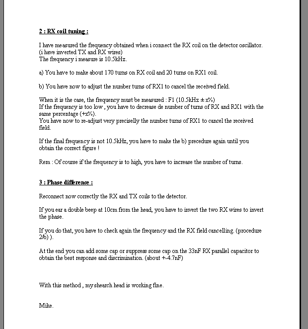

        Hi Gary,
        "The Frequency on the Recieve coil has Nothing to do with the Inductance or the Parallel Cap."
        Yes, I know. But I mean using Mike's instructions for measuring resonance frequency of TX and RX coils when connected to TX oscillator.
        TX must give 10KHz and RX+RX1 coils must give 10.5 KHz following this way to making these coils. Then when RX+RX1 are connected to RX pads they gives only same TX frequency (10KHz).
        I've measured also with scope not only frequency meter.
        Take a look at Mike's instructions, below.
        Thanks again.
        Best regards,
        Max

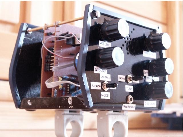

          Some people of Europe has success with the Bandido (hope this is right because has finished the project). In the files there are the same coils, etc. In very detailled parts list you can find replacements, bla, bla, bla. This is the detector based on split PCB of this people (maybe you want all the info) PCBs are in Eagle program and all the documentation in .rar compressed files. You can compare with all has been done by you at this moment. Remember that the second TX coil is winding in reverse, so big TX and receiver are in the same orientation winding and secondary TX (bucking coil) is in reverse winding (or phase).

                Hi Max,
                Gary is correct, but I think you have missed one subtle point here.
                The coil construction article you attached says "I have measured the frequency obtained when I connect the RX coil on the detector oscillator."
                In other words, Mike is saying that the RX coil was connected in place of the TX coil and then the frequency of the oscillator was measured. This is completely different to measuring the frequency across the RX coil with the TX coil connected. In this latter case it must be the same as the TX frequency, as there is no other frequency being transmitted. The only difference will be the amplitude of the signal at the RX coil.
                  Nice work Esteban!

                        Hi Max,
                        Hi Qiaozhi,
                        yes I have only 10KHz when rx-rx1 coils are on rx pads and TX coil oscillate at 10Khz, like Gary said it's an air core transformer.
                        No problem here.
