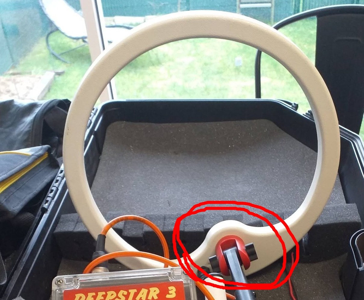

    I really like Eric Foster's coil designs, although I am in doubt about the rod support he always used, do you know of what material is it made? I'm in doubt in building something like that or if I should make the coil with the suppport everything in a single piece (vacuum formed) - I am not sure if there is some reason why eric foster always done it in as a separate part.
    My main goal is to use this kind of coil in the beach.

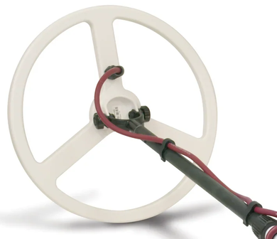

    I assume the piece he used is Delrin, and I assume he did it this way because it's difficult to make good ears with vacuum forming.For beach/surf, I much prefer a center mount, like this:
      Thank you, I also like that format with the center mount. Maybe in the future I design one similar.
        Hi gentlemen, visited the forum after a long time away and saw your post. Thought I would reply with an FYI as I worked at Pulse Technology (and PPD) with Eric.
        We used PVC rod turned / milled into swivels. PVC would solvent weld to the vac form more efficiently.
        I have an old SuperScan swivel (museum piece now ) which is a hybrid Delrin / PVC swivel. The holes in the vac form connection are so the the potting resin have a purchase for more strength with the heavier search coils
        Hope this is useful. All the best, Chris.

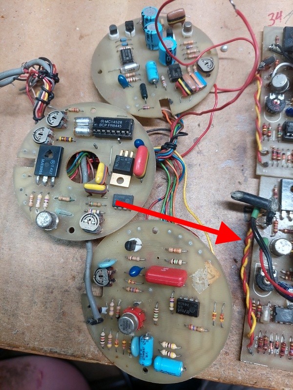

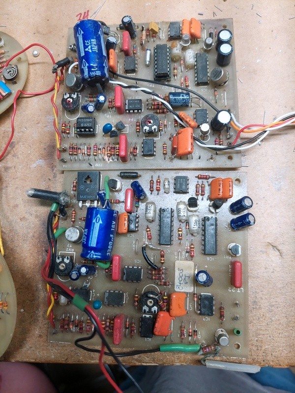

                      Thanks for the detailed information. Sorry to bother you, but you are the last link to Eric's work. Do you know about what year the Aquasport and Aquapulse 1 were in production? I used to repair these in 1990's and have the old pcb's for these models. The Aquapulse 1 had three round pcb's stacked inside the pvc tube.
                      Click image for larger version  Name:	Aquapulse1 pcbs.jpg Views:	0 Size:	168.2 KB ID:	452576
                        Hello Altra,
                        Please check the label on this circuit board. Eric usually uses the first two digits of the serial number to indicate the manufacturing year of his boards/detectors. Sometimes he adds a model series note between the year/month and the actual serialnumber. In the case of the AquaSport, the manufacturing year is 1984 and the serial number of the PCB/detector is 003 (see PCB/picture).
                        For example, for a GoldQuest SS detector. If the serial number on the device is 0307SS138, the manufacturing year would be 2003, the manufacturing month 07, the model series SS, and the serial number 138. Eric was pretty consistance with labeling serialnumbers of his detectors.

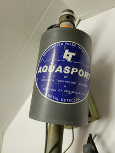

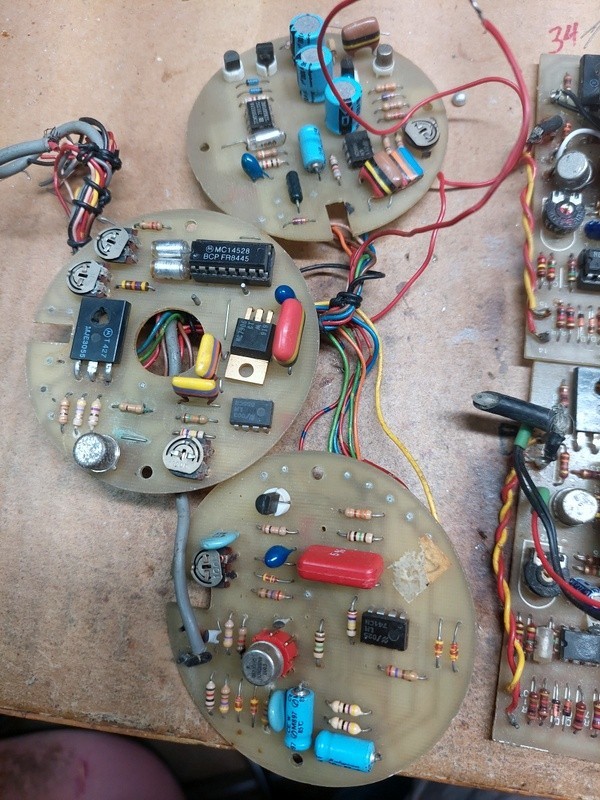

                          Thanks, I see the 84003 on one of the Aquasport pcb the other boards that I have the labels are missing. The date codes on the ICs for AP1 are 1979, 80 etc
Name:	Aquasport PI pcbs.jpg

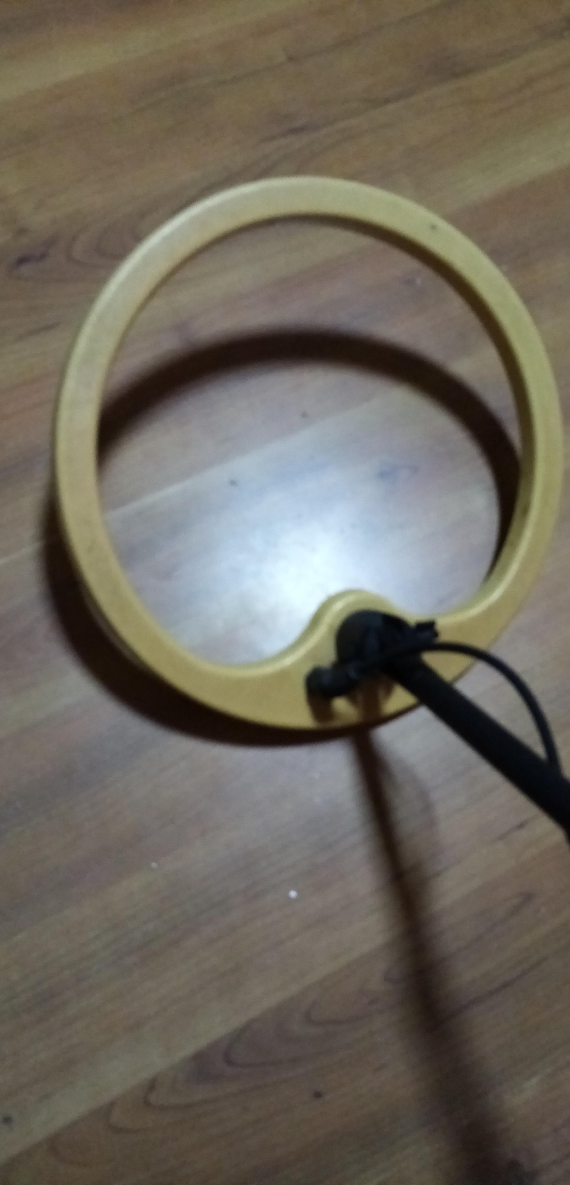

                            While we are on the topic here is a photo of a coil I have. It came from a Goldquest. I added the 5pin connector for my TDI. It is roughly 8.5" or 21cm outer diameter. Inductance is 306uH 5.25ohm

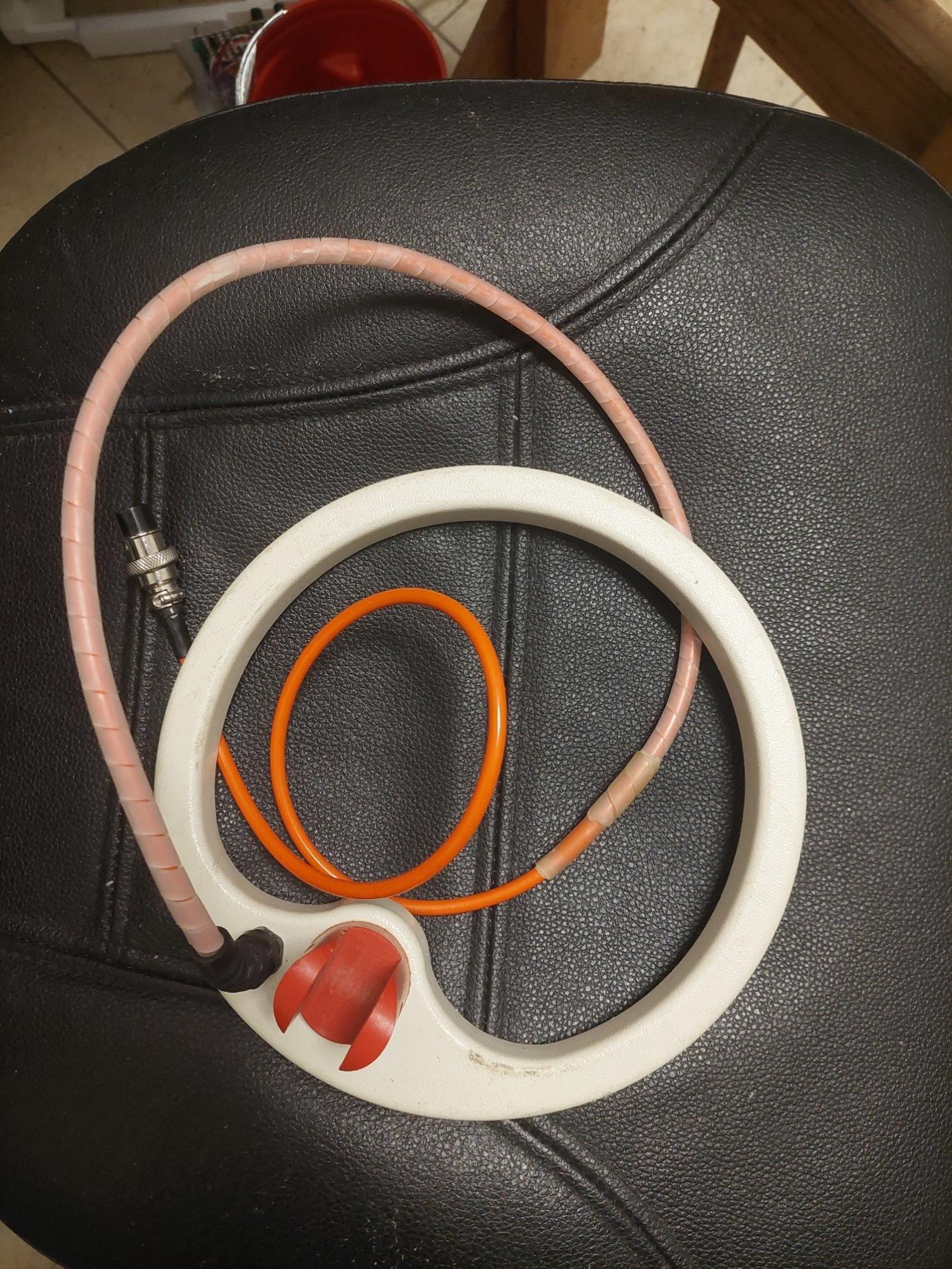

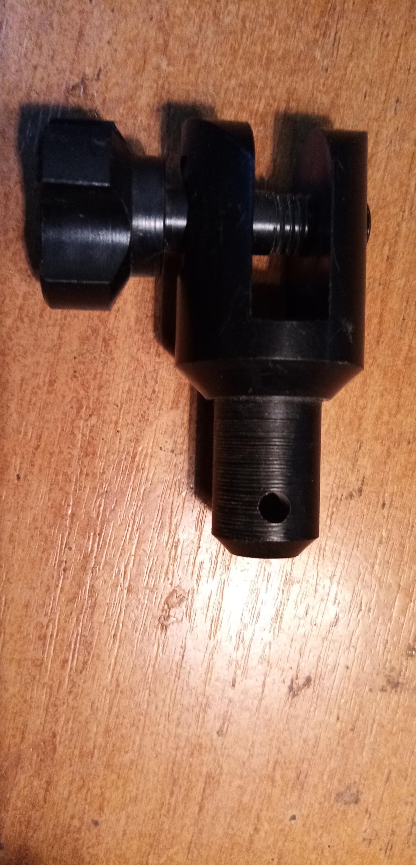

ID:	452604 Click image for larger version
ID:	452605 I had one coil of goldsacan 4 that had teeth so that the angle of the cheek could be moved and the other one was with the bracket from the picture made of pvc but this bracket entered the bracket that was on the coil, I opened the coil of gs 4 because as mentioned the thin layer of resin on which there was electrostatic protection the conductor somehow broke off from the first application and then I made a new bracket like the gs 5 bracket which was usually red in color myself on the milling machine, he made the same support from PVC, but in black color, so that he could touch these carbon lower handles.
