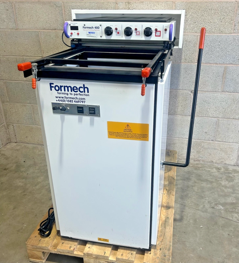

        And regarding Vacuum Forming, do you have some photo or detauls of the machines used? (just for curiosity because I also make my own vacuum forming machine and I'm always trying to improve it and get other ideas)

          The '3M scotch 24' tape was not used in PTL search coils, but Eric may well of experimented and even used this in his own PI designs. The 'Ribbon' cable wrap method and Aquadag coating was definitely used in the Goldscan, Beachscan, etc. designs and maybe a few specials.
          With regards to the vacform machine we used: this was the Formech 450 like shown in the picture. It could handle sheets up to 450mm square. We used pin-point vacform molds made by PTL for the simple coils and outsourced molds for the larger vacforms. Hope this helps
