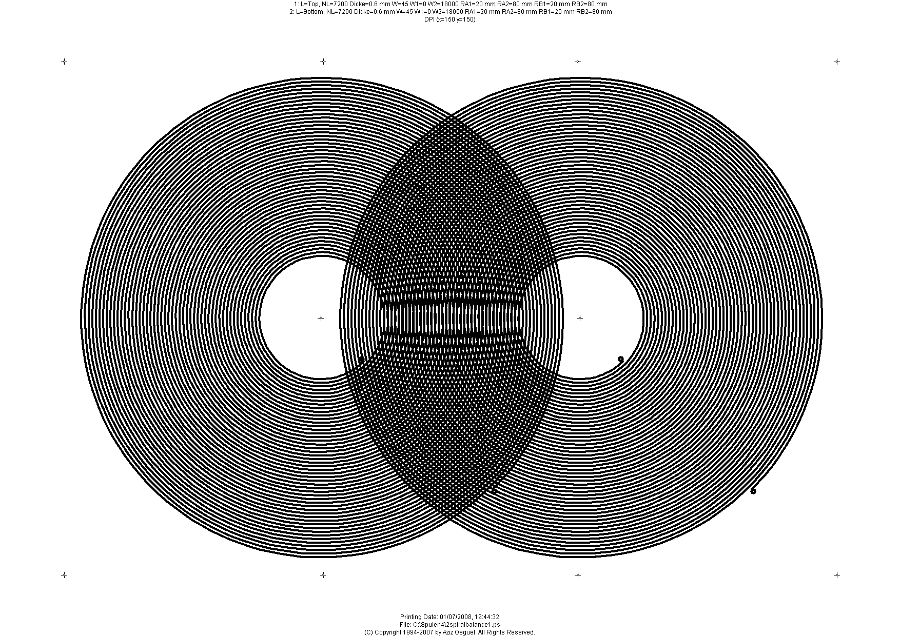

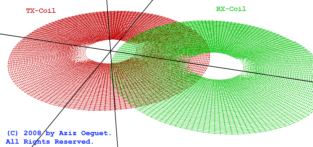

    For induction balancing of this flat spiral coil, same copy of the coil (as RX-Coil) is positioned at a distance of 85.8 mm from the center point of TX-Coil. The RX-Coil has also a distance of 1.5 mm height from the copper layer of TX-Coil. Standard PCB boards have a thickness of 1.5 mm. So, if you want to balance this coils together, just put them together and move the RX-coil 85.8 mm from the center point of TX-coil.
    Attached picture shows both coils in overlapping display:
    PDF-File showing in a better resolution.
      3D-Display of the TX-Coil (red) and RX-Coil (green):
        The final PCB coil as high resolution PDF-File.

            I propose to take multi-layered flat spider coil arrangement (idea from VLF radios). So the height of the whole coil will grow and the with of the spider coil should be small as possible (or reasonalbe). We could try to use two or three spider coils together with some gap between them to mininize the overall capacity. One spider coil itself has two layers of wire, in which the windings are interleaved.
            To lower the Q factor, we have to use thick HF wire with many very thin isolated wires, that are connected in the HF wire parallel. Also the RX-coil should be a HF wire but this could be thinner. So we can reduce the resistance of TX and RX coil. It will also reduce eddy currents on the coil wires.

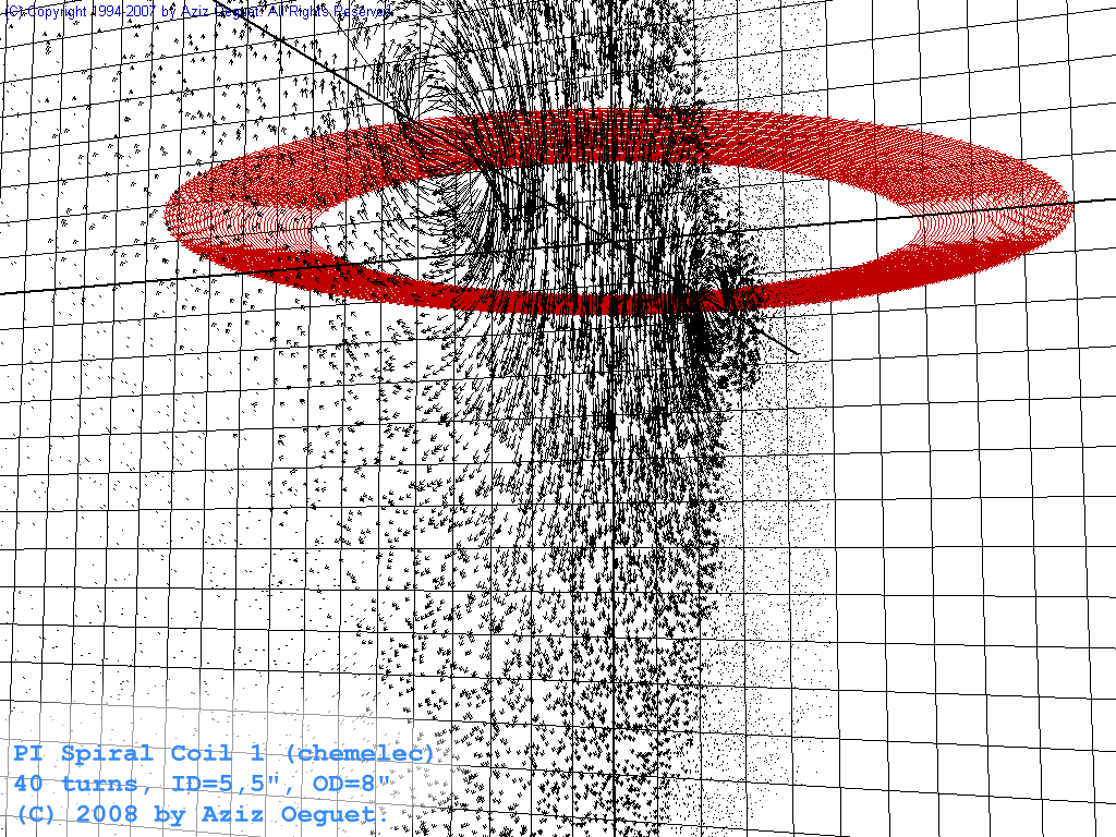

                  Hi chemelec,

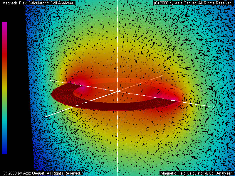

                  ok, I will show you your first coil configuration. The magnetic field vectors are linear scaled. The length is the strength, the direction of the vectors are direction of the magnetic fields (H-Field). The magnetic field vectors are computed on the crosssection y=0 (half). The coil is placed on 0/0/0 (x,y,z). The view point is from your possible target. The other coil configurations may look similar, if they have same proportions. Have a nice trip.

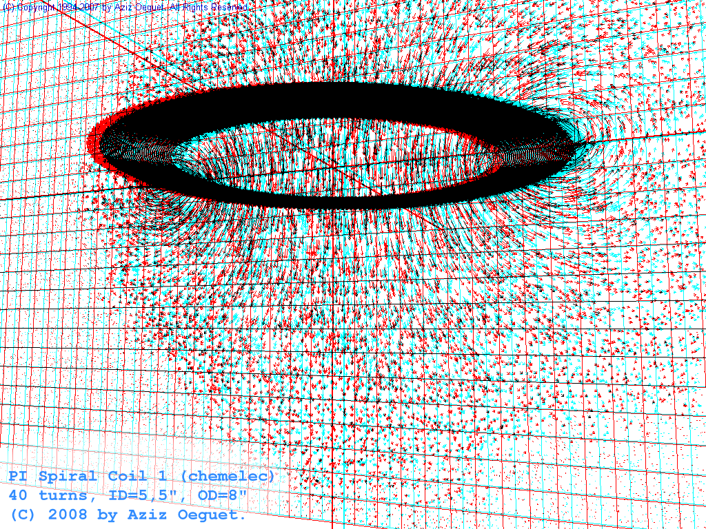

                    And this is 3D-view. You need a 3D-eye glasses (red/green one).

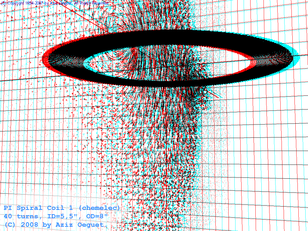

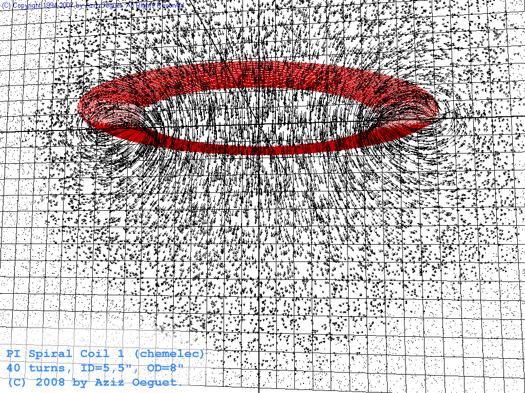

                      This is a crosssection on x=0. Also including the 3D-view. Have fun. Aziz.

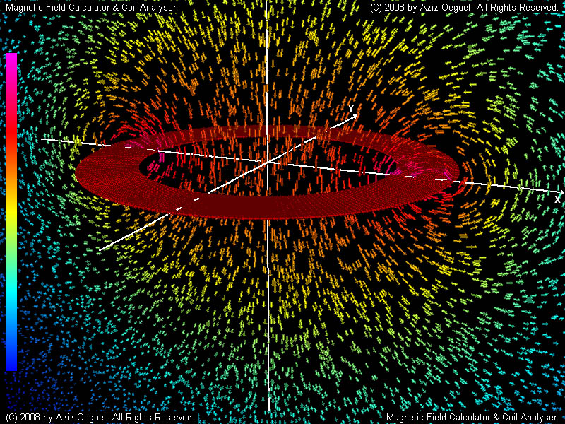

                          I made some improvements on software graphics. Exact magnetic strength values coming soon.
                          Aziz
