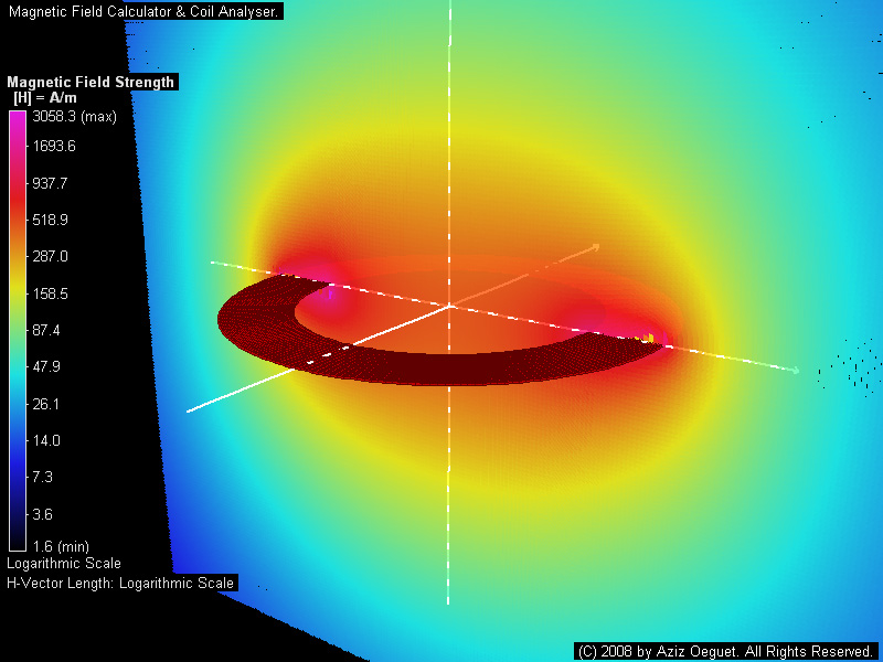

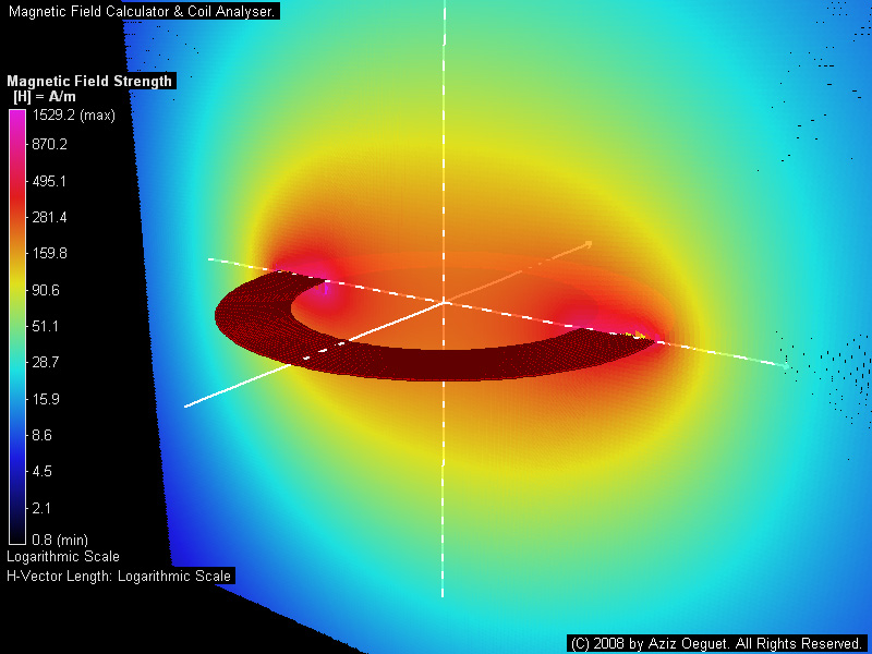

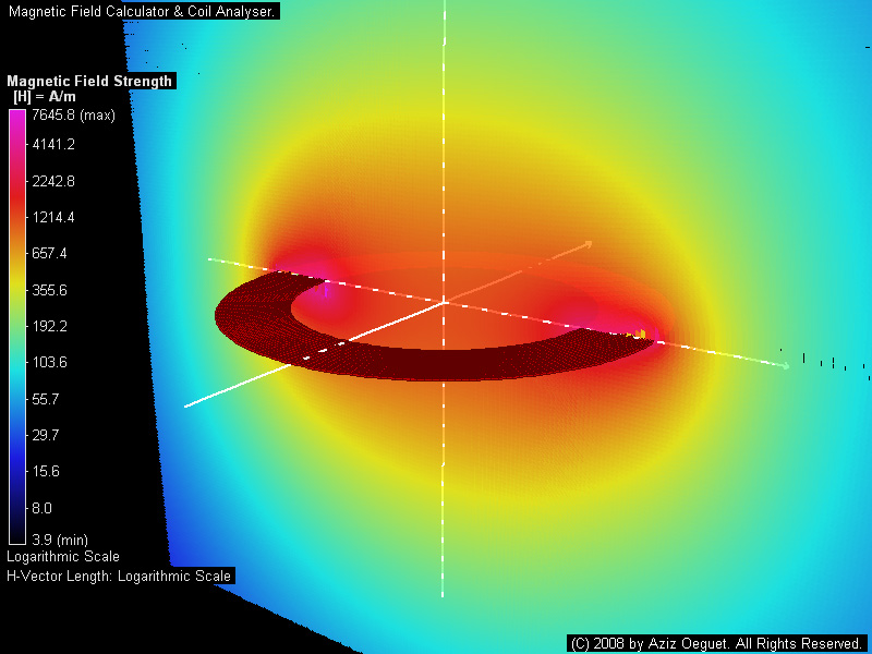

    The graphics display getting better (I worked hard last night). Now the magnetic field strength values are available. The coil from chemelec with 1 A current flow.
    Enjoy.

      How about a Comparison with this same coil but with 2 Amps and maybe also 5 amps.
      Definately Interesting Graphics.
      Thanks....Gary
        Hi Gary,
        Magnetic Field (MF) Strength is direct proportional to current through the coil. So double the current will cause doubling the MF. As the graphics is log-scaled, only the scale changes to different MF strength.
        Following two graphics with:
        - 2A current drive
        - 5A current drive
        Aziz
          coil
          And this is 3D-view. You need a 3D-eye glasses (red/green one).

              illistrations of the magnetic fields was what i was looking for for various shapes , was wondering if it poss to "direct" manipulate or focus magnetic fields in one direction , supose thats the holy grail for metal detecting ,
              anyway , aziz , i was looking at your simulations , and was wondering what a flat spiral coil with NO hole in the middle would look like.
              as far as i understand it , magnetic flux needs 2 paths to "return" ??
              was thinking the field pattern would look pretty weird as there is no "path" in the middle to allow "return" so the only way is on the outside which should distort the field somewhat, good or bad.
              what would that look like ??

                    I recently picked up a pair of the red/green 3D glasses from a picture theatre
                    and tried looking at Aziz's 3d graphics, in this thread, it works, very interesting effect.
                      And I can fly through the magnetic field lines. *LOL*
                      You see the static picture. I can change the picture in real-time. Move around, rotate, zoom-in,...
                      That's phantastic.
                      Aziz
                        Aziz, which software do you simulate those? is it Matlab/HFSS? Can you post the code?
                                Self written C/C++ software.
