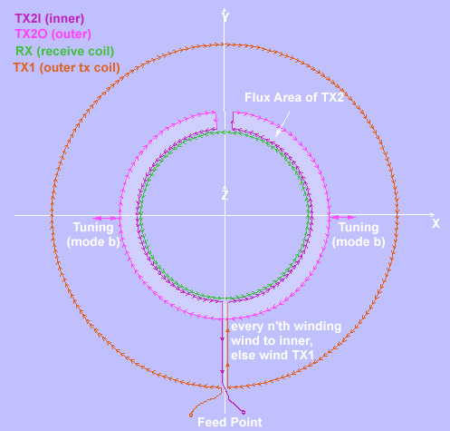

    Tuning:
    I have obviously misunderstood you. I thought, you increase the flux area of the inner tx coil. To avoid further misunderstandings, the flux area of the coil is the integrated surface area of coil winding. As the inner tx coil is not a true circle (open), the flux area is far less then compared to a circle. A coil that has zero flux area can not induce magnetic fields. There is a minimum flux area needed, to ensure nulling of the inner rx coil.
    As a fact, coil configuration can be nulled in two ways:
    a) By changing the geometry position of the inner tx coil (flux area constant)
    Opening wider the inner tx coil to keep more distance to the inner rx-coil.
    b) By changing the flux area of the inner tx coil (geometry changes only for the outer inner tx coil windings).
    Stretching/upsetting the outer windings of the inner tx coil.
    c) or a combination of both a) and b)
    In this way, this type of coils can be easly made and nulled compared to pure concentric coils. As I see the magnetic strength distribution, the original omega coil is more effective than this coil.
    More facts on coming days.... to be continued
    So I will start coding now..
      I don't see how this coil can possibly work. The nulling portion has parallel wires with current flowing in opposite directions, so the magnetic fields will cancel. It will have very little effect on the RX coil.

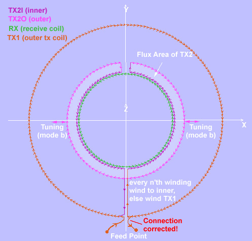

        Yes, as I mentioned on the TGS-Topic, nulling is not possible on the coil configuration seen above. Only the following coil configuration is possible, to get nulled (see below).
          I have corrected the connection of the coils. So any misunderstandings should be avoided.
            OK, thank you, Aziz. Not fully the same as i thought (e.g. how to put thru tunning loop only 1/4 of TX flux), but you can apply only simplified derivate i know. Nulling was planned as you stated in paragraph a.). Let see what is output of your excellent comp simulation.
            Theoretically i fully agree with Carl about functionality of tunning loop design (i mentioned "self nulling"), but practice sometimes not support exclusively theoretical approach of clear parameters. Maybe Azizs application put out another view that is for us still invisible at present.
              Yes, and probably to get additional field strength to TX coil too. Thank you for your efforts on corrections.
                I also fail to understand how this could possibly act as a nulling coil.
                In the standard omega configuration the TX coil is looped back on itself and overlaps the RX coil. This allows the residual TX signal present in the RX coil to be cancelled. The RX coil can then be mechanically adjusted up or down to find the correct nulling point. In your proposed configuration, it is more like a crippled concentric coil.

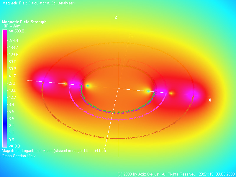

                      Ok, the coil software for desired functionality is implemented now. I am still waiting for input from all of you for a particular coil design.
                      I has been pointed out, that the number of inner TX windings (TX2) should be half of the number of the outer TX (TX1) windings (=N turns). So this can be easily adapted to a particular desired coil inductivity. The TX coil (TX1+TX2) can then be made from only single wire and in one step. First the outer TX1 should be wounded, then wind to inner TX2 and remain winding until the N/2 windings completed. Tuning mode a gives the ability to tune course and mode b the ability for fine tune. For tuning mode a, one can place a plastic screw to enable a more better tuning by moving the inner TX coil ends together or apart.
                      Following picture shows a cross section of the magnetic strength field:
                      TX1: Number of turns N = 40
                      TX2: Number of turns = N/2 = 20
                      Diameter: ~20 cm (TX1)
                      Aziz

                        When I said "I fail to understand how this could work" - what I was politely trying to say was "this configuration will not work".
                        The nulling coil needs to be in anti-phase so that it cancels the residual TX signal generated in the RX coil. The proposed configuration will not do that. In fact, it will fail to cancel anything, except itself!

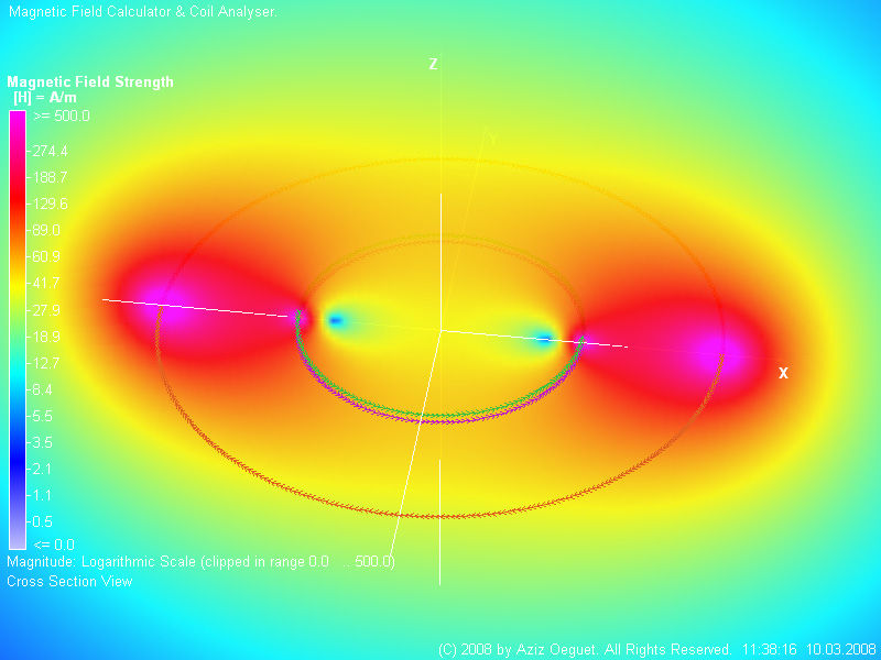

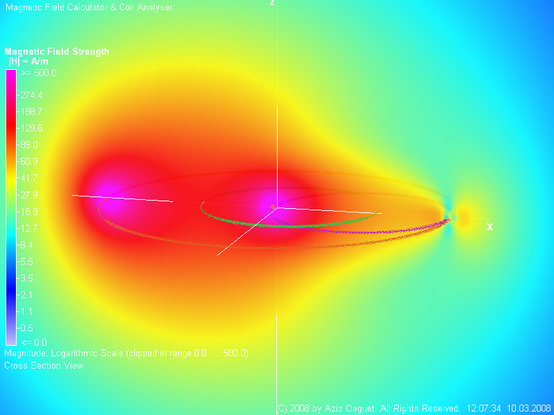

                            This experiment lead to a real concentric coil but with opened inner tx coil to tune easy. Your next proposal is very similar to a concentric coil. Following magnetic fields strength cross section shows a typical concentric coil. The N-TX1=40, N-TX2=12, RX coil placed ~3 mm above the TX2 coil and has same radius. Typically, RX and TX2 coils are wounded on the same plastic core.
                              But I like the standard omega coil. The RX coil "sees" much more magnetic strength in his flux area and nearby it. This can induce more signals compared to a standard concentric coil.
                              Next picture: Omega coil cross section.
