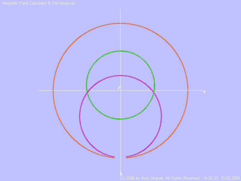

cComega virtual coil

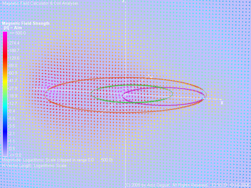

    Next: Magnetic field vectors: Strength and Direction.
      Some commnents on standard omega coil:
      Indeed, the absolute total effective magnetic strength integrated over the flux area of the RX coil tend to numerical instability (convergence instability) during balancing calculation. I had to increase the number of segments (wire elements) and minimizing the delta to overcome this effect. I will compare the standard concentric vs. standard omega coil in practice next week. I newer built a standard omega coil yet and I am looking forward to the results.

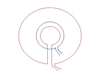

        Very interesting Aziz. Can you make some modification in position and shape of inner coils?? More like this shape:
        In my testing the best for coin detection. L = approximately starting point position / proportion before tunning , but without much difference after nulling.

          another shape idea.
          Nulling could be performed by slightly offsetting the RX coil (?).

            Hello WM6,
            Thank you.

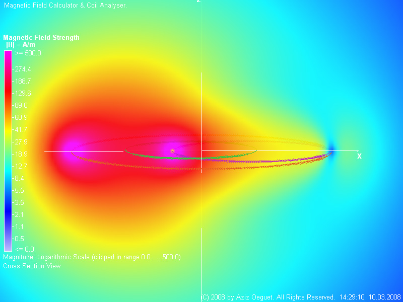

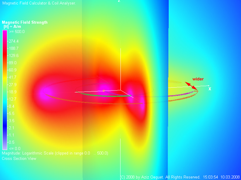

            I made the inner TX coil (TX2) a little bit bigger and opened the gap at omega position a bit (TX1). The RX, TX1 coil is the same, RX coil is ~ 1 mm above the TX2 coil. I think, the 1 mm distance gap is not enough for real world due to many windings ot the RX coil. Anyway, if the distance is changed, the balance position will differ along the X-axis.
            An interesting question to proof is, the omega gap on TX1 coil. Should this be small as possible or not? I will proof this.
              The omega gap is now wider. No really big changes. Another interesting question is the radius of TX2.

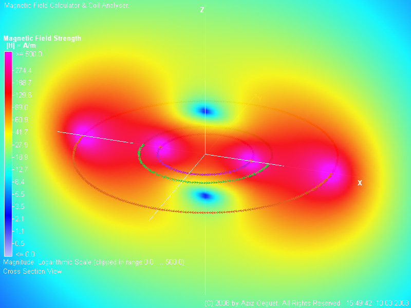

                Balancing is possible. But the magnetic field density shows an unreasonable result. There is a magnetic strength hole above and below the center of the coils. To get balanced the RX coil in the center of the coils, the N-TX1=40, N-TX2=33. It depends on the geometry of the RX coil (radius, position, height, etc.).
                See the magnetic field strength cross section for your proposal below:

                        The RX coil positions shown here are allready on nulled (balanced) positions. Any offset of the RX coil would destroy the nulling/balance of the coil.
                        I suppose, the omega gap can almost be "zero" and there is no need for more space between the sharp bends of the TX1. For the purpose of more mechanical stability, the sharp bends could be even fixed together.
                        Anyway, practical experiments should help us, to interpret the EM field response. Then, we can optimize the coil to meet the desired specification.
