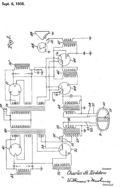

          The same year of the GD-48 Heathkit? His coil is type omega. The Heathkit's kit come with assembly manual and schematic.
          Also look here a metal detector with D-D coil patented in 1938 (filled in 1936)
          • #65
            I am sorry, but I can not do more calculations now. I am coding very important features of the coil software.
            Estaban, very interesting patent. Thanks.
            WM6, very good coil design. Combination of two different radius OO coils. It will work. We have to wait for efficient factors to able to compare coils.
